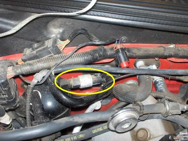

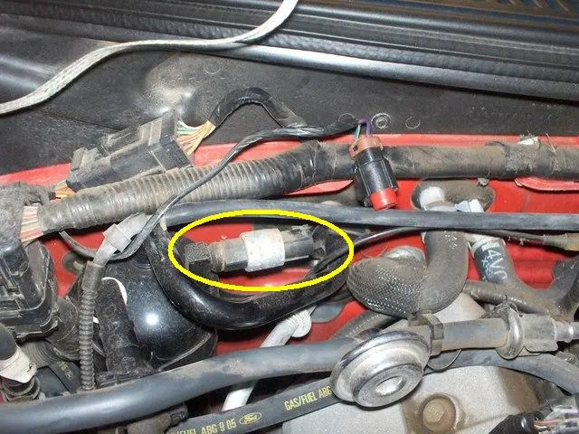

The low pressure switch is right on top of the dryer (mine is horizontal facing towards the drivers side) and unscrews with a crescent and/or 5/8". seems the plastic expands only when tight on dryer making it too big for 5/8".
<a href="http://photobucket.com" target="_blank"><img src="http://i53.photobucket.com/albums/g51/shubinj/Picture005.jpg" border="0" alt="Photo Sharing and Video Hosting at Photobucket"></a>
auto zone part # MT0444 is $11.99
orig part reads F5VH-19E561-AA 9911
a/c blows cold now, problem solved :nice:
Hey Shoobs, thanks again for the picture and part number information. Just to make sure I'm understanding correctly, that's the low pressure switch circled in yellow in the picture below??

Low pressure switches frequently go bad. That switch is on the dryer. Remove the wiring plug and use a paperclip to jump the plug once you remove it. If the AC clutch now actuates when you turn on the AC (watch it and see if it engages when you do this) then you have a bad low pressure switch. It's an easy fix - screw the old one out and the new one in.
There are some good automotive ac forums out there, too.
+1 I had a 97 Cobra 2 years ago. A/C would work one day, then it would blow warm for the next few, and so on and so forth. The switch on the drier solved my problem. It took 1 minute to unscrew and replace. They are the same on all fords, I got mine from a Windstar minvan. (No free-on comes out when you unscrew it either)
