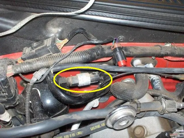

Hey Shoobs, thanks again for the picture and part number information. Just to make sure I'm understanding correctly, that's the low pressure switch circled in yellow in the picture below??
i dont see the circled yellow switch. i am trying to address this problem on my car and was wondering if someone could please identify where the switch specifically is...thanks!
Just wanted to say thanks for great picture! This switch went out on my 1997 with 90,000 miles. $10.99 at Autozone - part #MT0444. The compressor clutch would not spin, but the engine would surge on & off & on & off. Put the new switch on & worked right away. Also, wanted to point out that too much or too little R134a will cause compressor clutch to cycle on & off.
