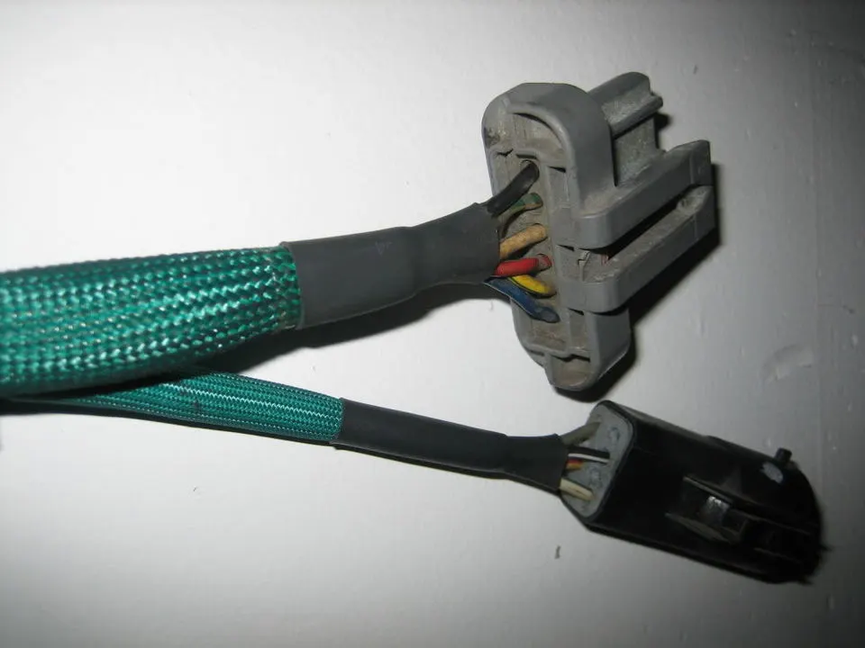

I've done the modifications to the wiring harness for this and the '95 style TPS which uses an oval plug instead of the 88-93 round plug. I use this green fiber insulating sleeve that I picked up at Boeing surplus a few years back with a short adhesive lined heat shrink at each end. It's heat resistant and extremely strong. I think it's the same stuff used around the wires on the Bosch HEGO sensors without the slick silicon coating. It's called "Varflex" and it came in 100 foot rolls with a leader string inside.
