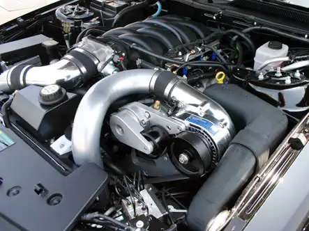

In preparation for FFW (Dallas and Houston), WFC and SEMA (Both of our vehicles will be in the Snap-On booth at SEMA), I got the system ordered. I think I am looking at the middle of June as far as receiving it goes. I can hardly stand the wait.
:jester:
FULL details on the project as well as the install, tuning, dyno, and RACE results will be posted at the following address...
http://www.trixtersracing.com/projectinterceptor.htm (NOT ONLINE yet)...
More to come, I have a few that are going out VERY soon that I will be supporting, this data will be posted as well.
MORE TO COME!
BTW- Due to the fact that the latest version EEC Vs (And the car itself) is so new, I stuck with the BASE HO 3-core 9 PSI kit, as it is a daily driver. I am certain I will be happy with 11.60s, for a while anyway.
As the R&D progresses, we will start doing the Stage II, Stage III, and RACE kits (Including D-1s and larger, more boost, as well as adding Snow Water/Methanol and / or Nitrous Oxide soon.
We will find the breaking point so you don't have to... Some day. Heh!
