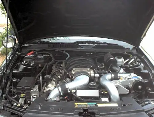

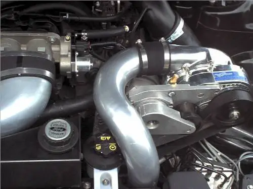

Install was flawless. This is the most well engineered Procharger system I have EVER installed. I am in the middle of tuning and will take a road trip to Dallas over the weekend, so I will be broken in, tuned, and mashin the LOUD PEDAL soon!
I LOVE blow-thru MAF setups! It is LOUD AS HELL. You can even hear the blower whine through it too at cruise! Heh! I cannot wait to go WFO!
