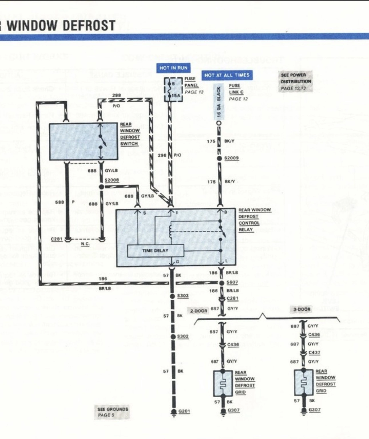

So, dumb question. If I have the switch relay and wiring all hooked up, I should be able to turn the switch on, check the end of the wire that connects to the glass and, as long as I have power, it should defrost the glass correct?
Correct. That grey wire to the rear is 12v+. So one side of the grid grounds to the body and the other side gets 12v. The grid lines themselves have resistance, so that generates the heat to warm the glass.
This is a 1988 wiring diagram, so it's not exactly correct for 1993 but it gives you a rough idea on how the glass is wired in

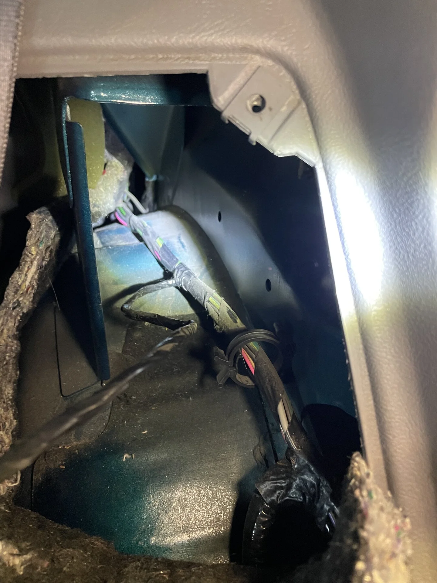

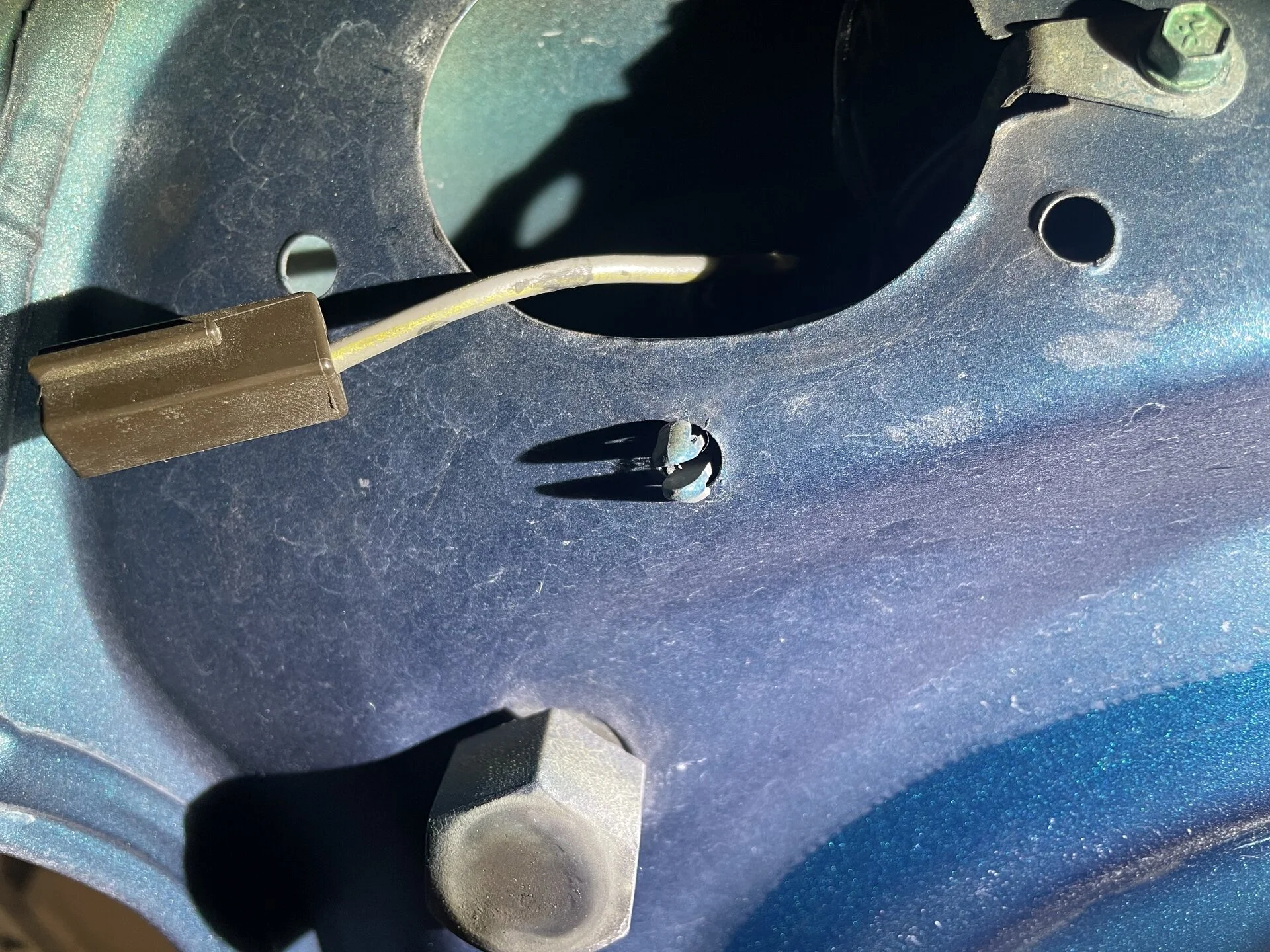

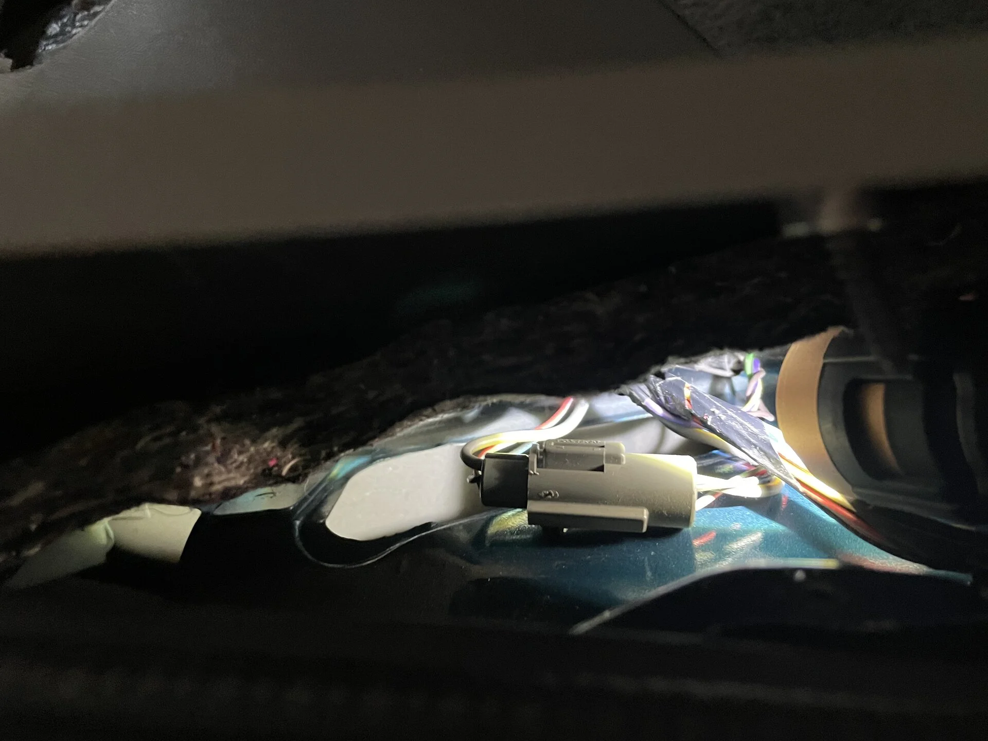

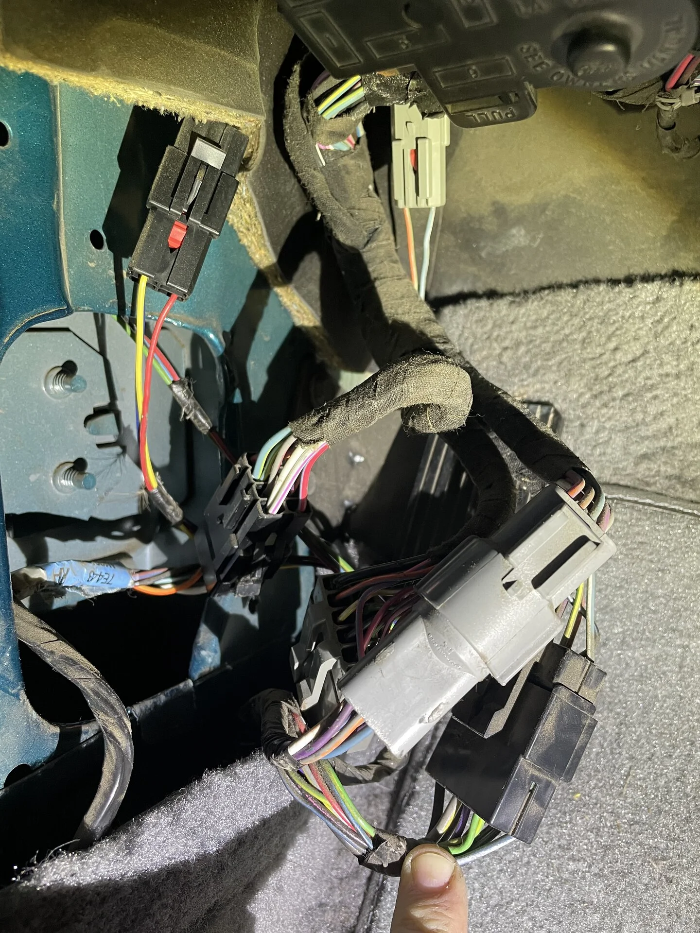

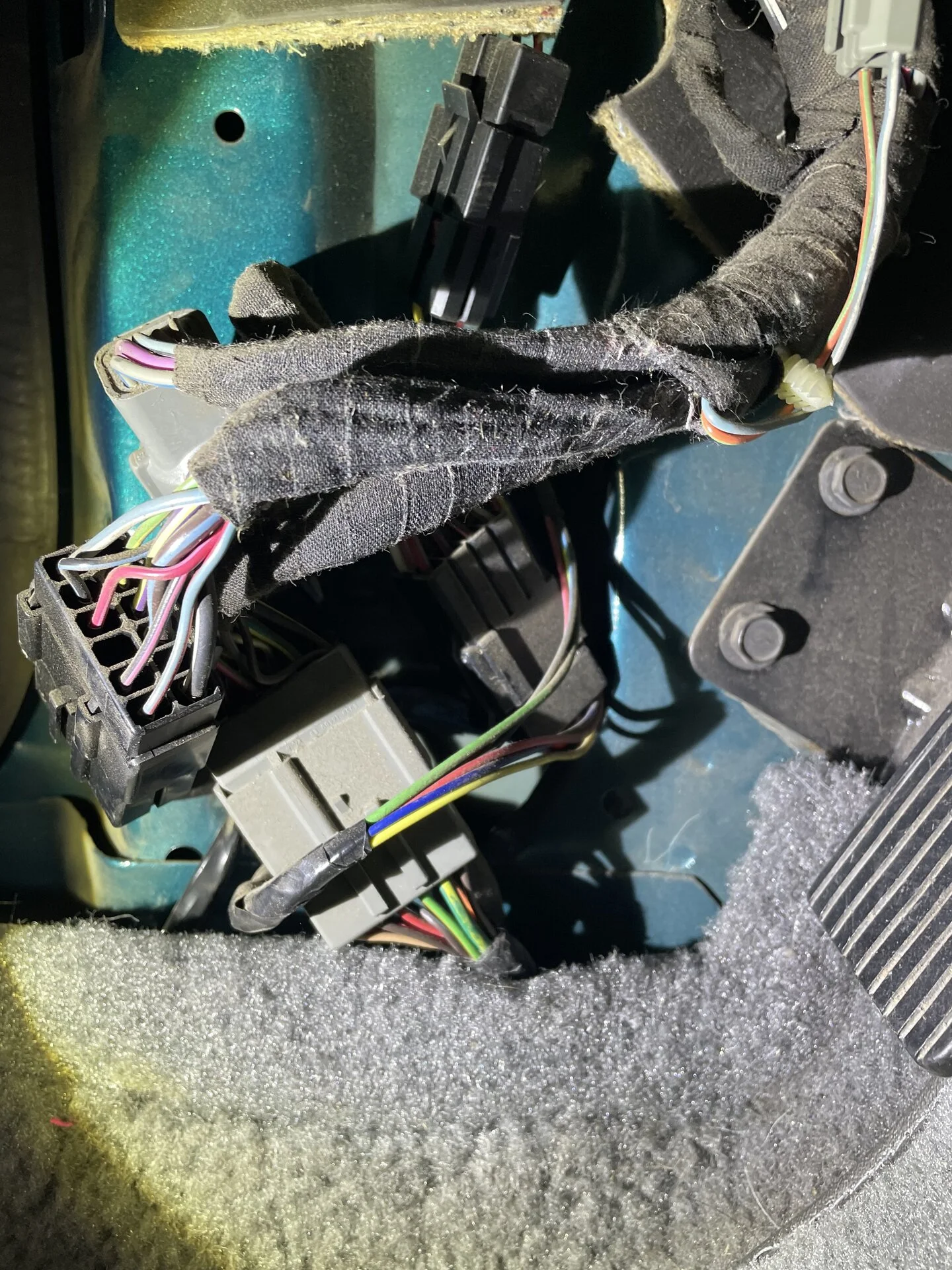

So, per the attached pics it doesn’t look like I have the large gray wire that runs from the kick panel to under the sill plate to the rear speaker area. Also, the defrost relay should be mounted under the dash on the drivers side right? If so, do you have a pic and can confirm location?
Thank you!!
Thank you!!

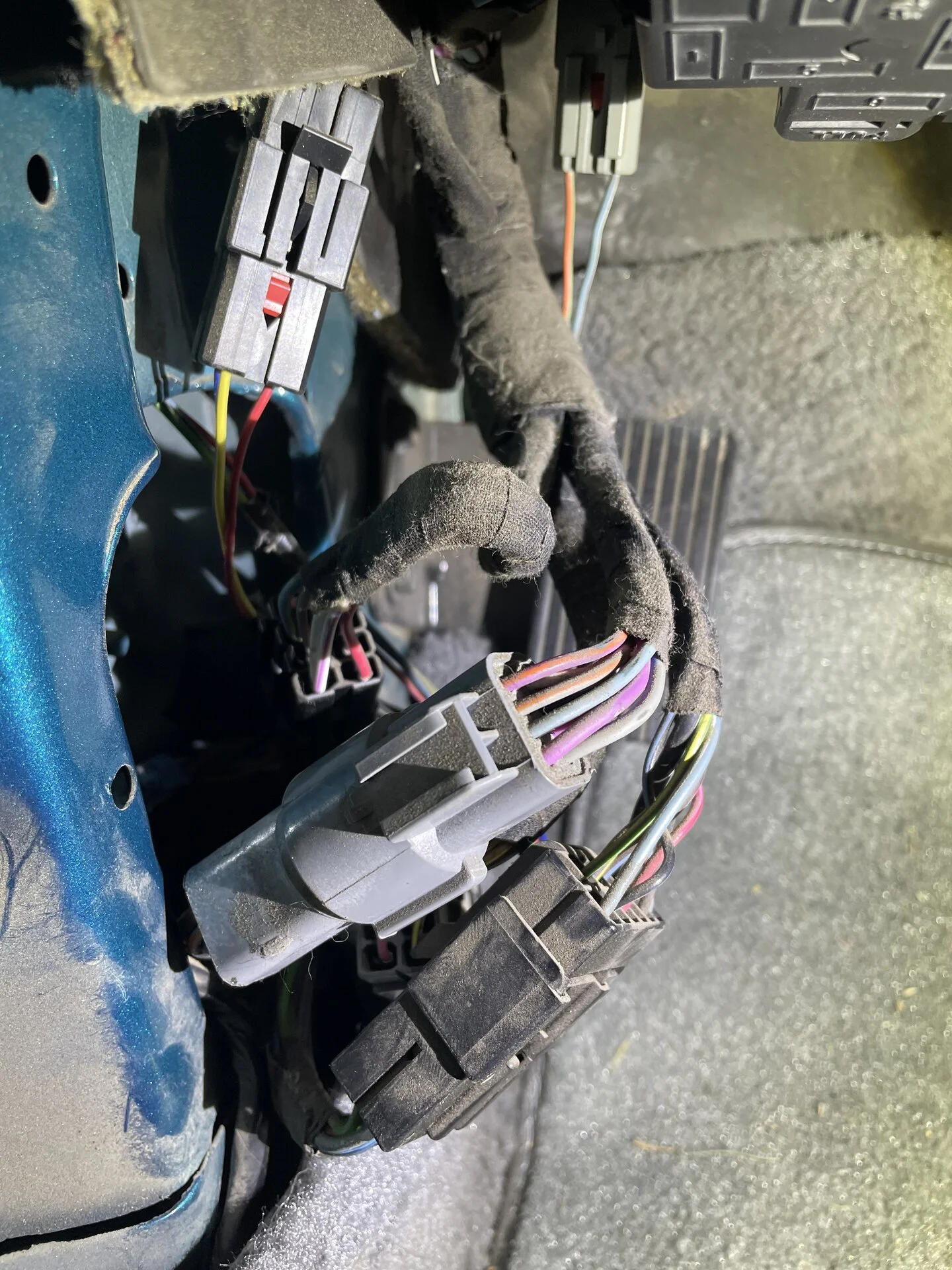

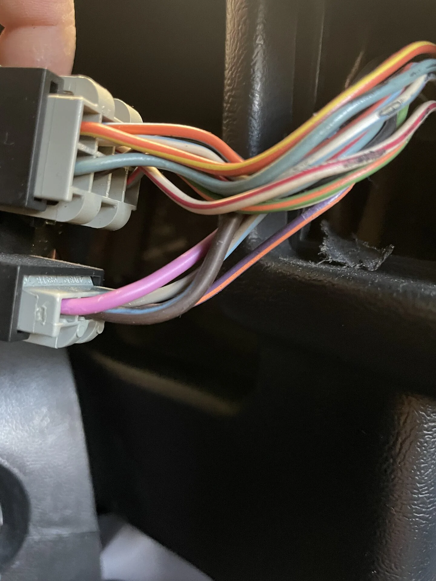

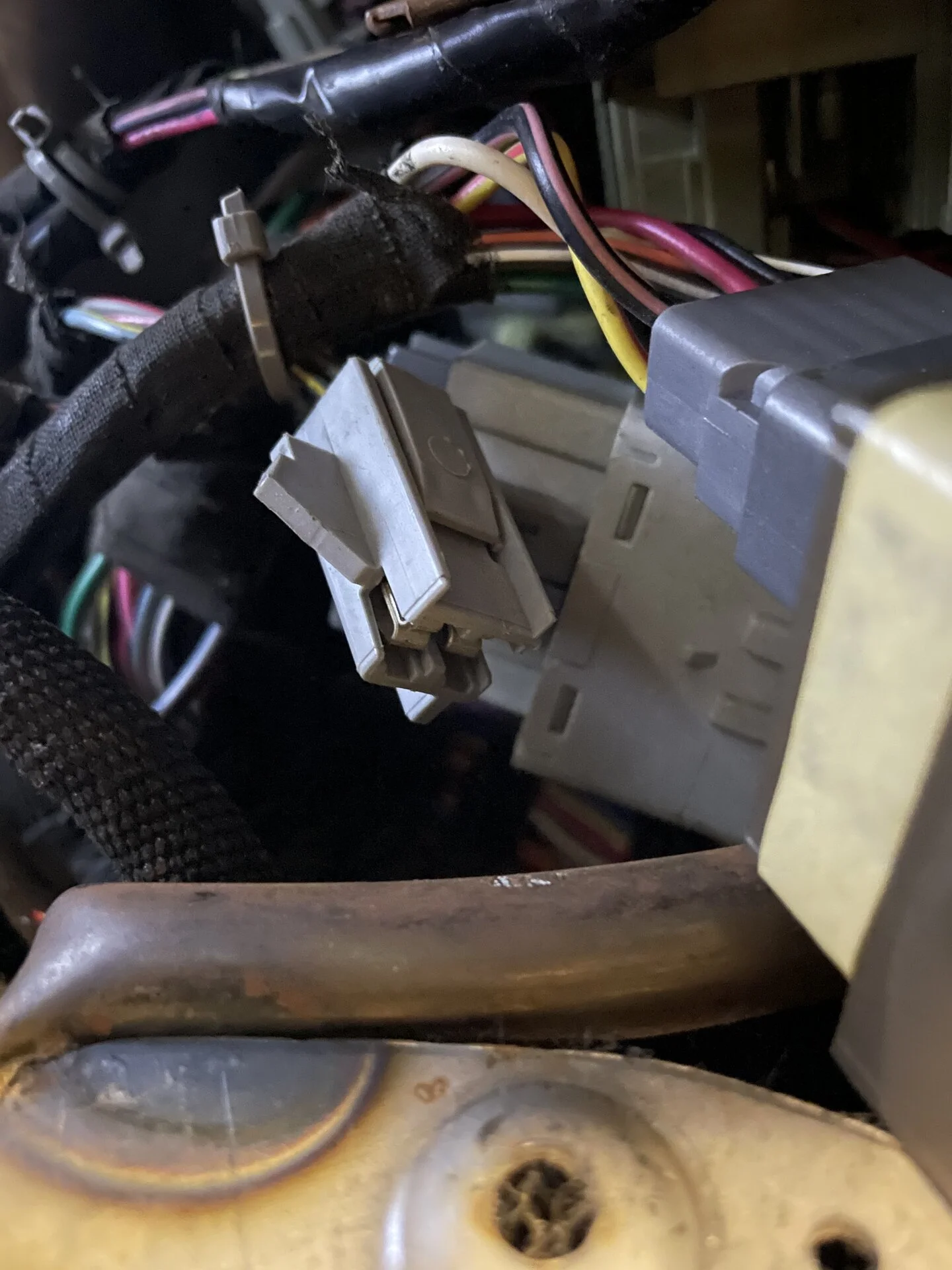

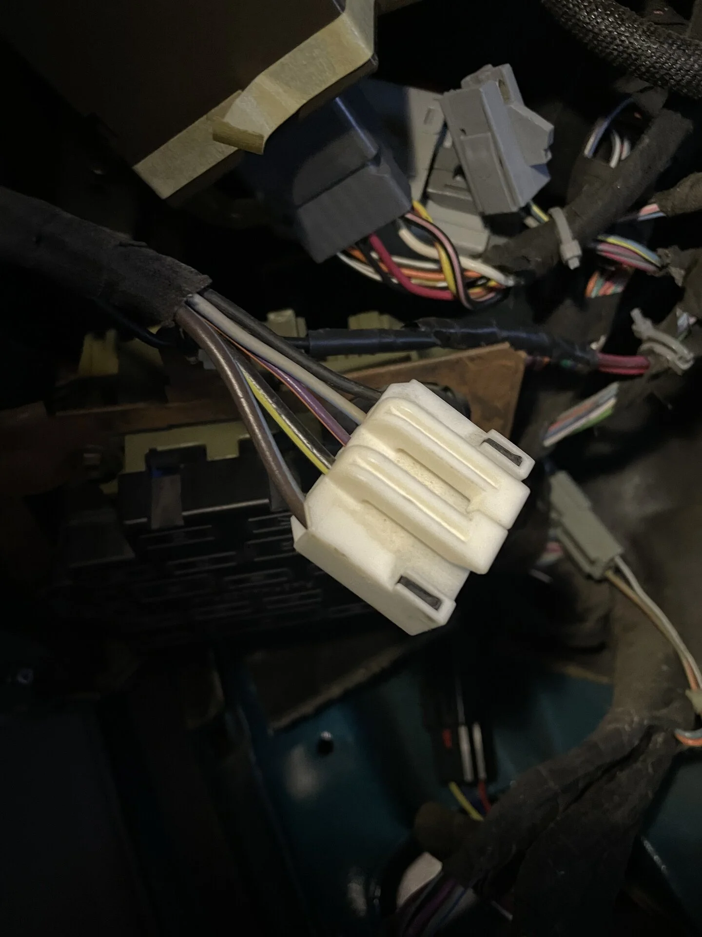

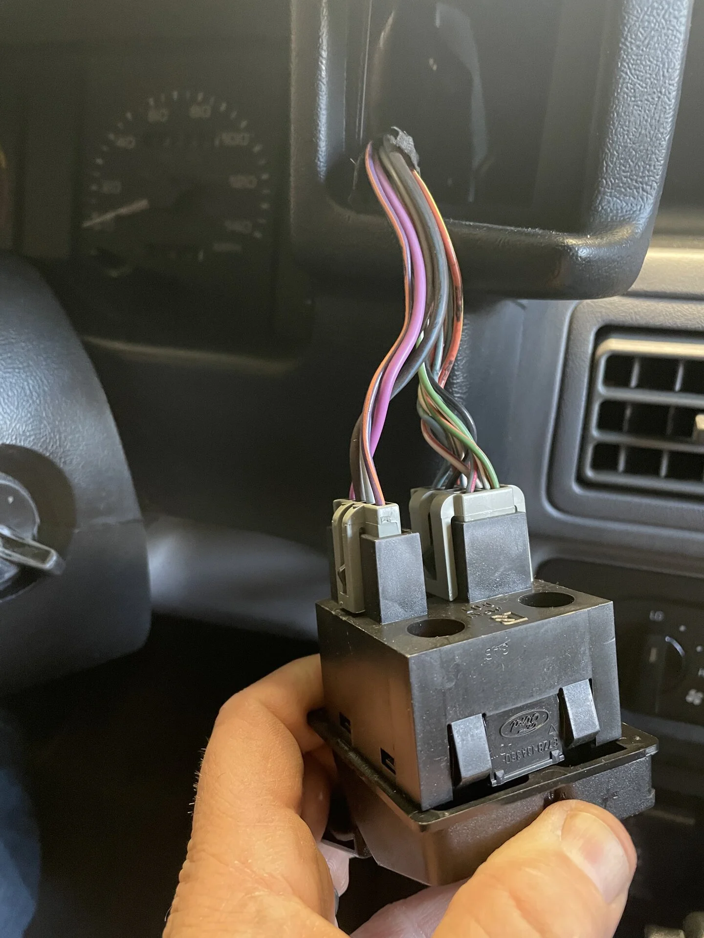

I also have these two plugs free under the dash.

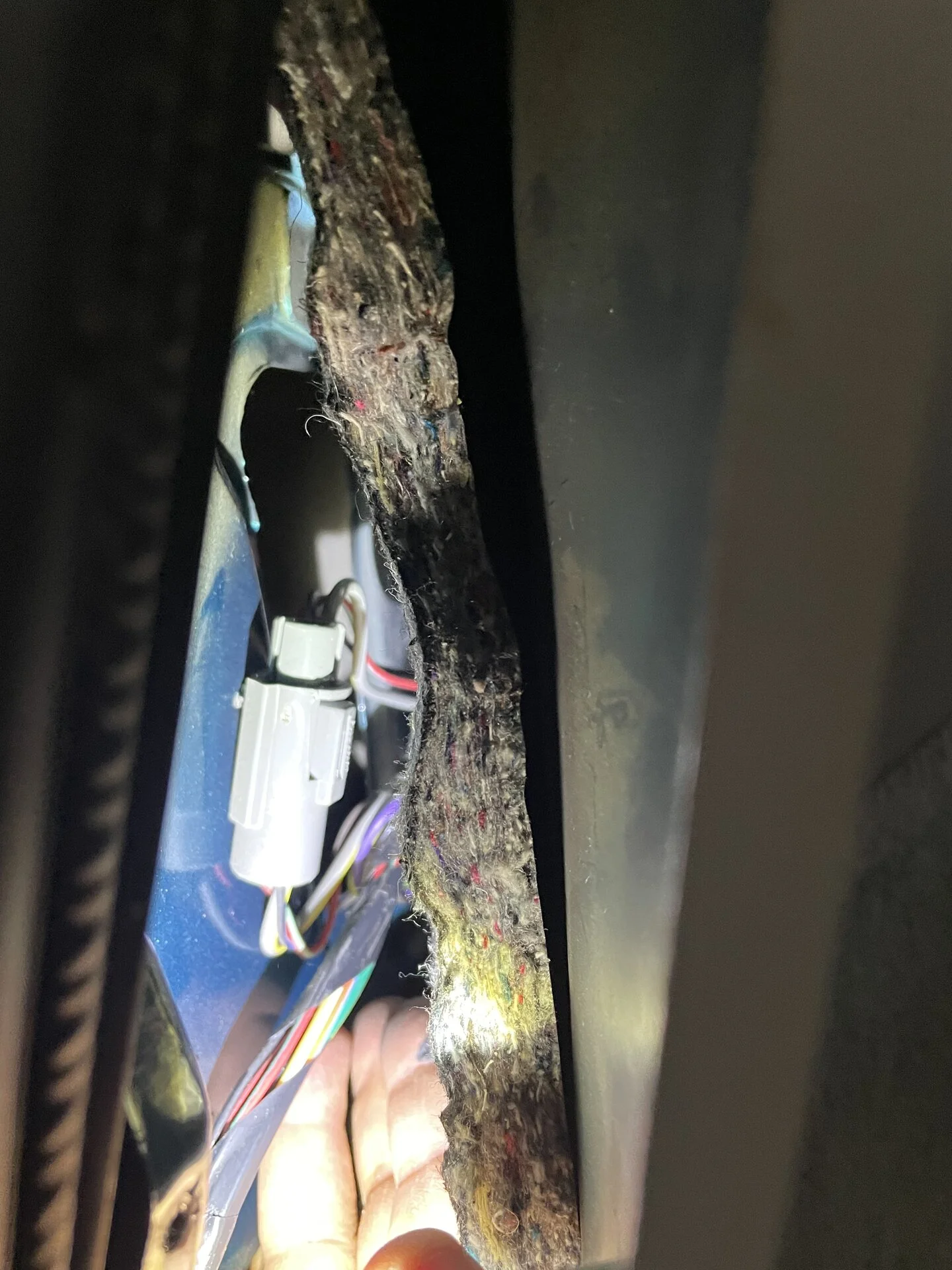

I also see this gray plug in the back of the hatch if I trace the wire running behind the rear drivers side speaker.
I think the gray wire is taped into the bundle. Gray wire with yellow stripe. I think I see it in your pics in the back.

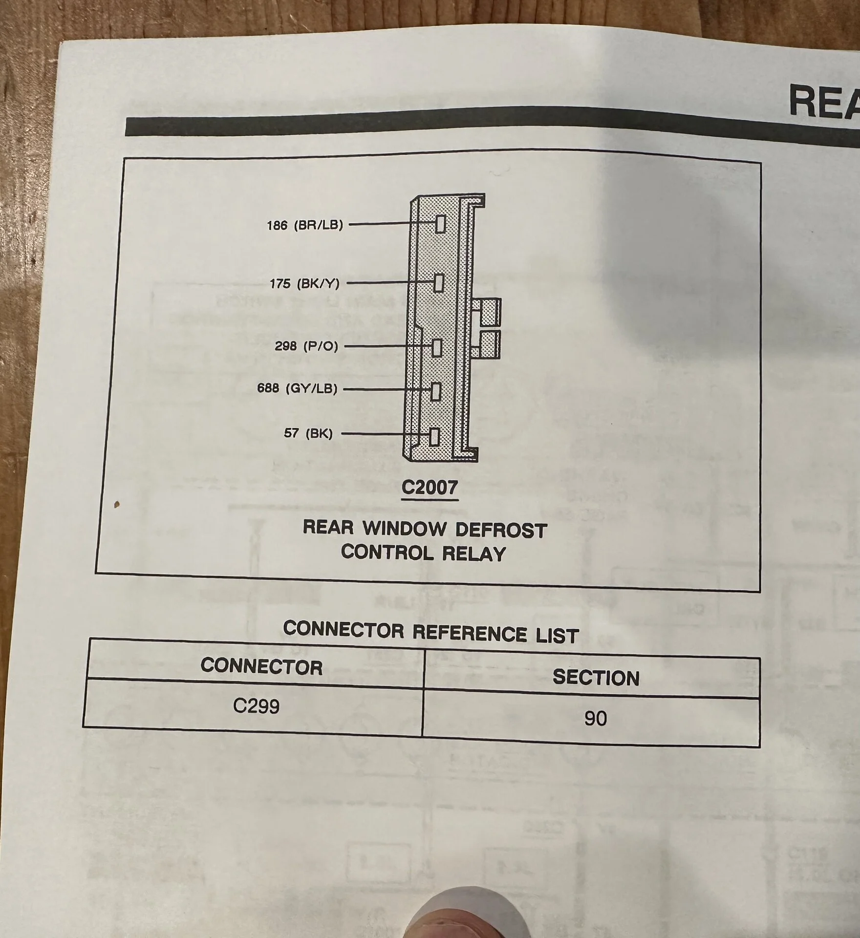

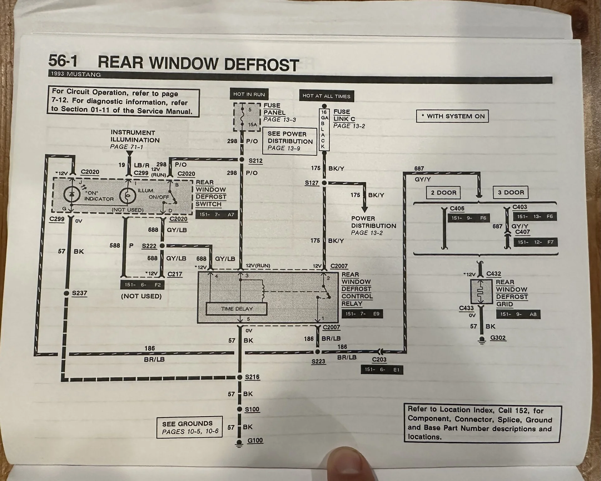

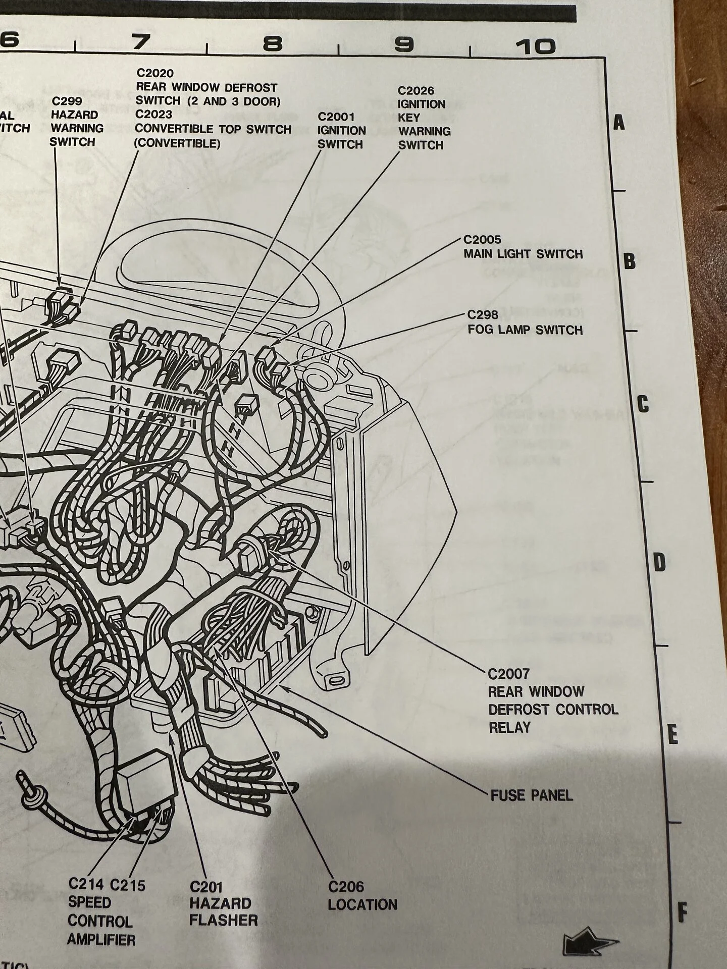

Let me pull out my 1993 EVTM later tonight and get some diagrams for you.
Here are the 1993 specific diagrams
Location of relay. Looks taped up around the fuse box. You should have a brown/lt blue wire on one side from the relay, and a gray wire on the other side.
I see the plug in your picture, but cannot make out wire colors to see if the outgoing gray wire is there.
Here’s the wiring diagrams. C203 is located in the drivers side kick panel and is a 12-pin black connector
Found the plug in the hatch! I ordered the relay, now will get the switch and the cable that connects from this one to the glass, then the other one that connects to glass and ground.
