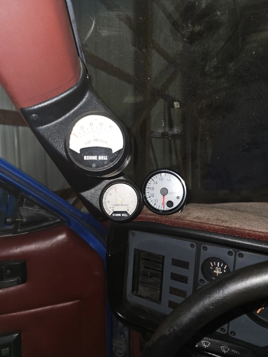

Those three things that I listed are (for me) a necessity to be in view of the driver when in boost. The logic is that if anything goes wrong, you have a good chance of catching the problem on the gauges before somethig goes, "BOOM".
Your fuel pressure reading while at idle and not in boost is really of no consequence.
LOTS of folks go for the custom tune and don't run an AFR meter. I can see the logic in that but again... if something goes awry, how do you prefer to be notified? By a bang or by a heads up set of guages?
Case in point: I had a vac line pop of the intake side of my KB. I had no idea that this had happened except for.... Yes... my AFR meter indicated that I was running leaner than usual. It's a pretty significant sized line. the port itself is the same size as the port that feeds the brake booster. Had I not had the meter, I would not have known to pull over and check things out before mashing the gas and getting into the boost. o_O

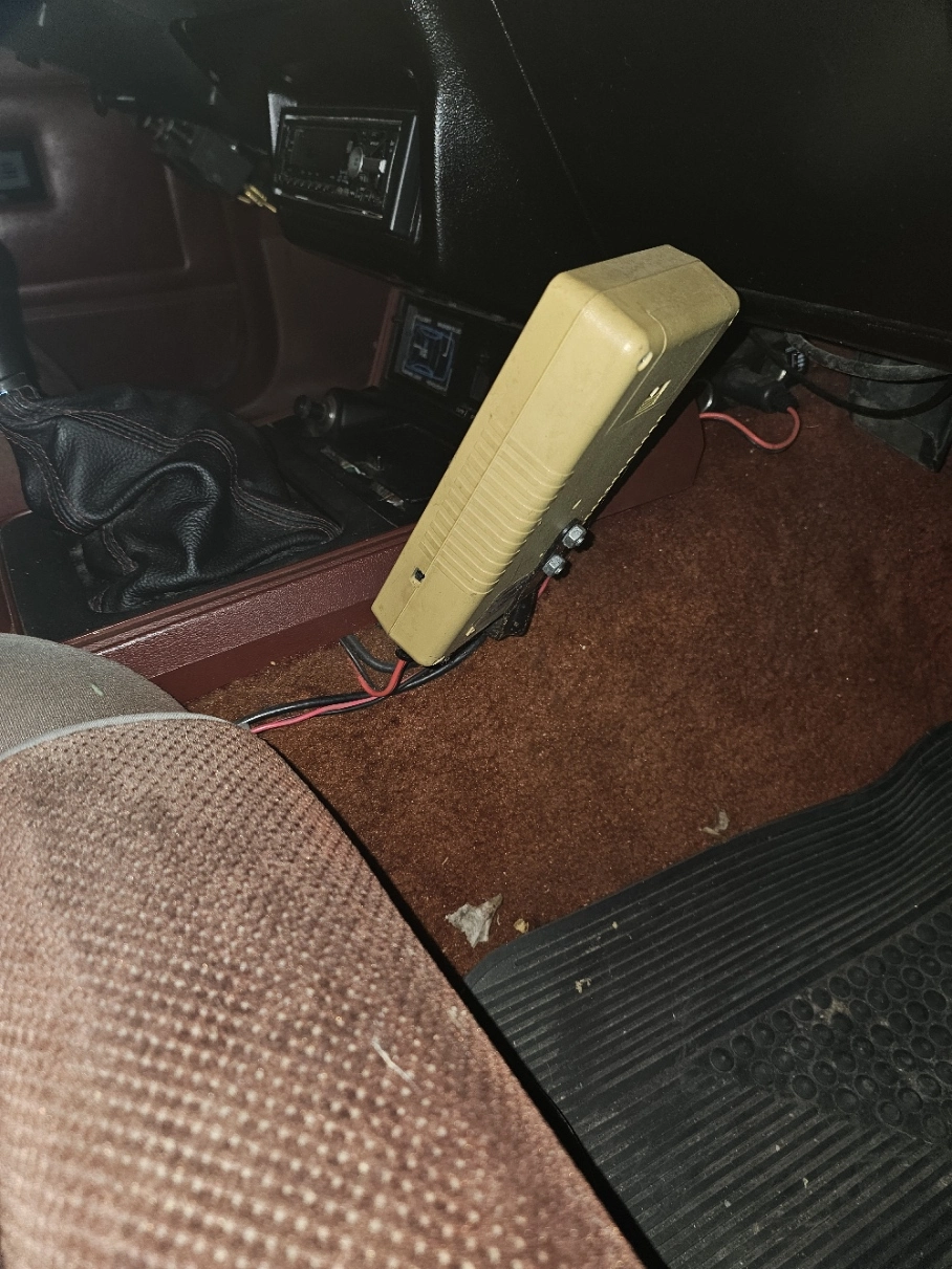

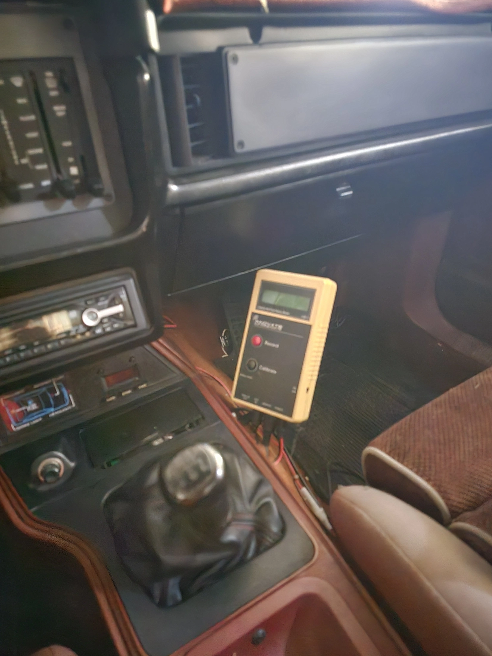

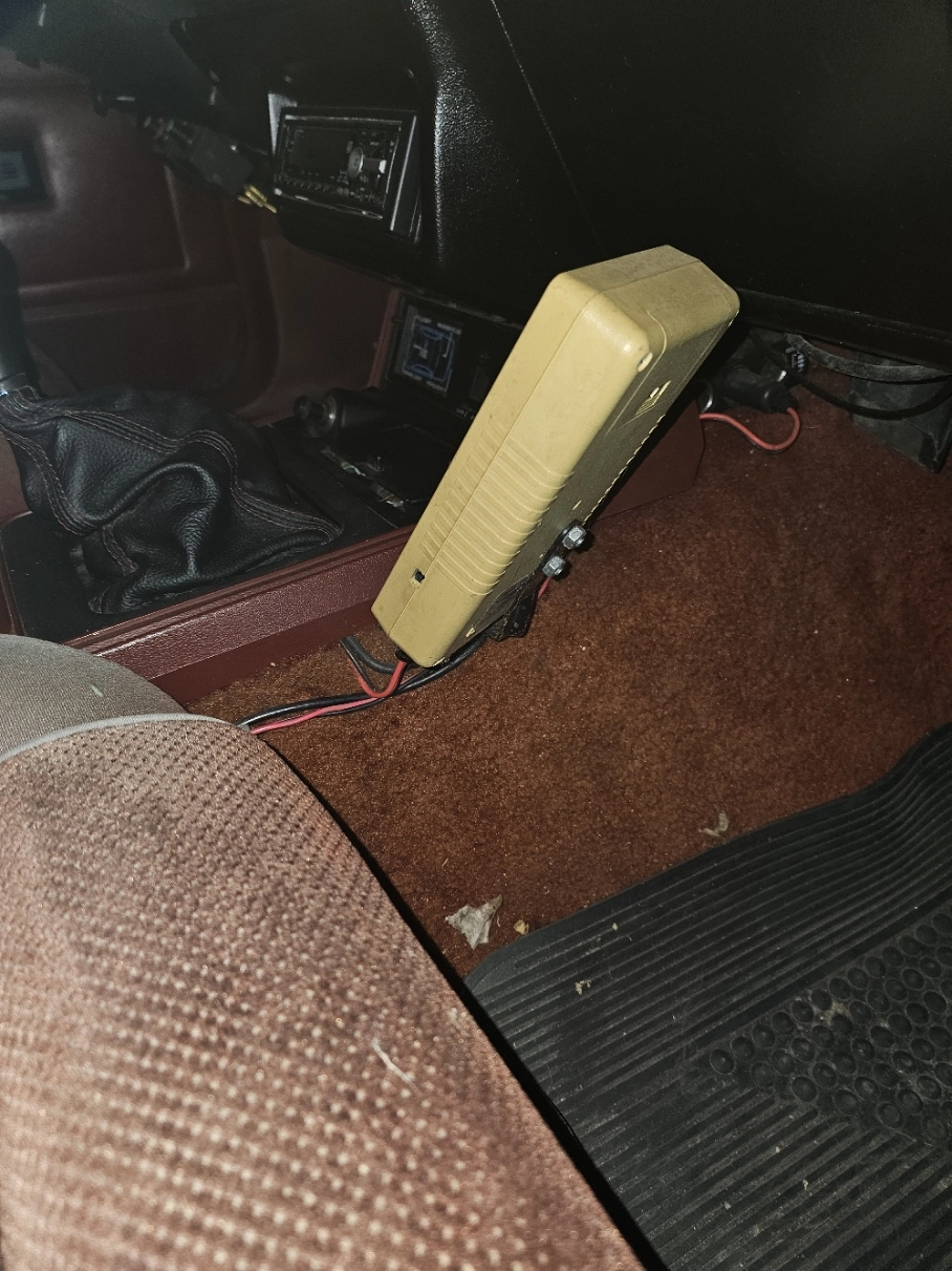

I have an Innovate LM-1 mounted to the right side of my center console and facing the driver.
The two guages that I run on the pillar are the Vac/boost and Fuel Pressure.
What I'd REALLY like to do is just hide the LM-1 altogether and put a greddy analog gauge into a 3 guage pillar. The Greddy guages are FN sweet (and expensive). It takes a 1V input from any wideband reader that has an output.

Let's see pics ...
