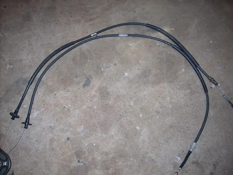

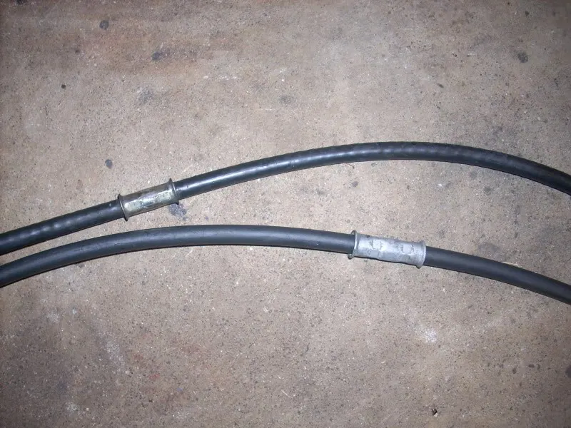

Weren't you the one who worked at American Muscle? I sent these pictures to American Muscle yesterday, and they sent me an RMA immediately. The MM cable was so far off, it wasn't even close. The cable did not have enough travel on it, it was at least 10 inches too long, and the mount for the inner fender was 5 inches too far down the cable so it made a huge kink under the hood. This is a picture of it sitting side by side with a BBK cable which had fit perfectly.

The actual issue is that the cable doesn't fit. When I talked to Steeda briefly today, they said there was a good chance it was mis packaged. So far the BBK has been the best fitting one I've had. The Steeda one was a lot better than the MM cable, but I had to reuse the fender mount bracket from the BBK cable. The Steeda bracket would not fit due to exhaust interference. It was also a little tighter on the top side, but usable.

I was being helpful. It's possible it got mis packaged, but there's a better chance MM got a bad batch of cables from their supplier. There's a good chance that many have had a good product from them before, but something has changed and now they are shipping the wrong thing. That's one of the main reasons people hang out on websites like this; to get up to date information on products. The picture says it all.
Kurt

I would say it's a mixture of both. The fact is they shipped me a bad cable, my conjecture is that they will possibly be shipping out bad cables in the future. On a side note, I am very happy with the way American Muscle is handling the issue. The first thing they requested was pictures, so that they could be aware of any problems in their product line up. They sent me an email today confirming that I did in fact get a bad cable, and they are contacting the manufacturer to resolve the problem as quickly as possible.
