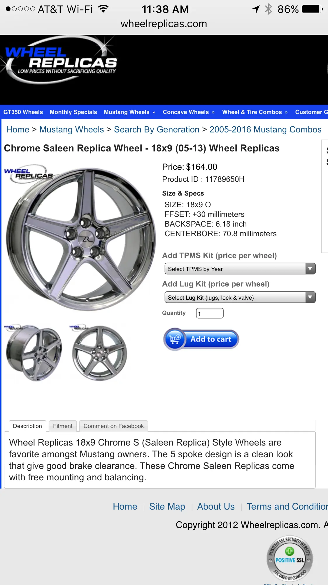

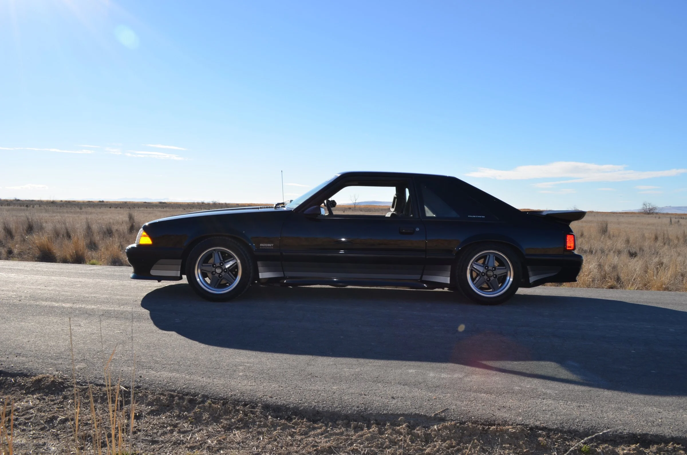

I am going to put 94, 18" Saleen replica wheels on my 89 Saleen. I am also going to put new springs and struts on it. I am concerned about fitment and rubbing. What tire size and back spacing do you recommend? What spring and strut/shock combo?
This is for weekend cruising, no track plans for me. I was looking at H&R's with Koni's. Right now the Saleen suspension has my car on the ground and stiff as a board.
Even 9" will be tricky due to the wider disk brake setup on the rear. Saleens basically run SVO rear brakes, which are 1.25" wider each side. Do you know the specs of the wheels you want to run?
Really, you should be thinking s197 offsets here.

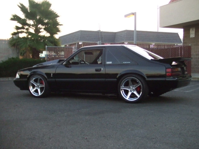

Above car is wearing SN95 brakes. Is that a consideration?

There is no 94-98 replica of the lemans wheel.
The offset on the real ones are 10 and 30mm. 8.5 wide.
Those would likely be your best bet, but you will probably need 4 of the same offset and even worse 4 identical wheels (while they look alike, there are 4 versions)
