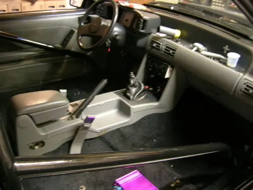

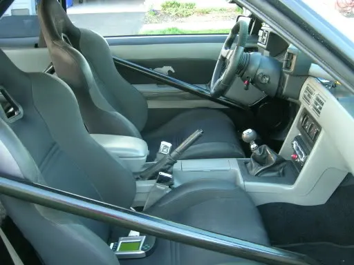

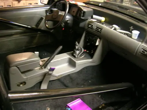

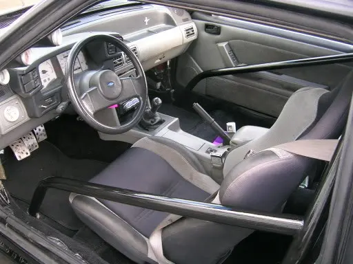

anyone have any pictures of a grey interior with black carpet?
its kind of cold in NYC right now so the laying out in the sun wont help much, but i may waituntill spring to do this

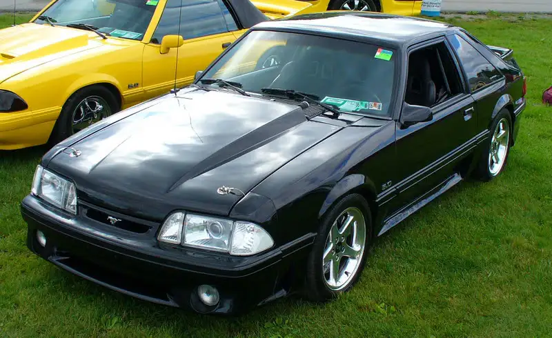

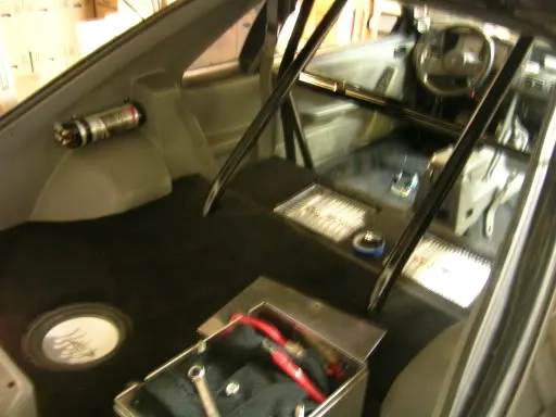

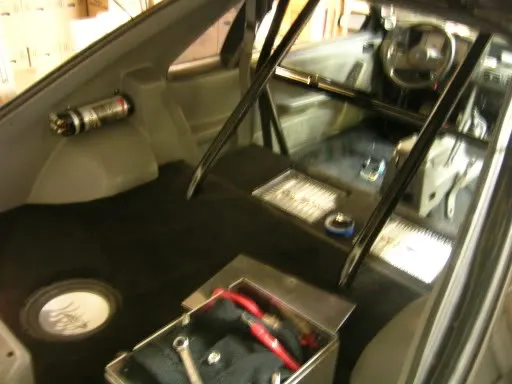

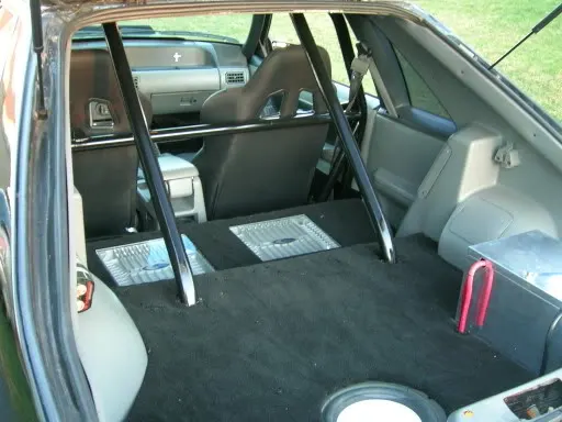

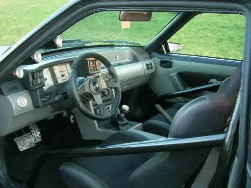

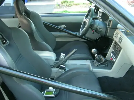

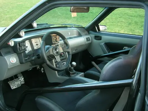

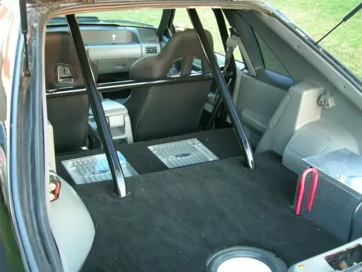

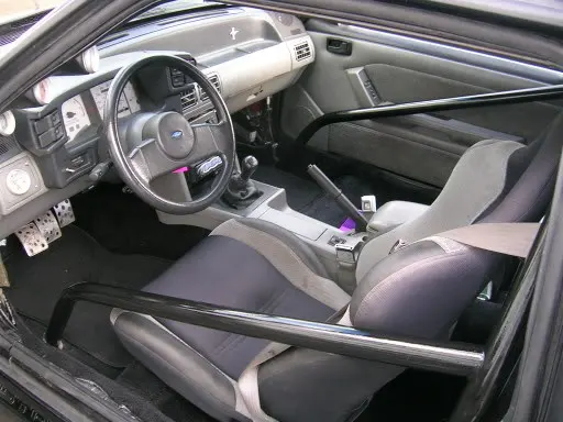

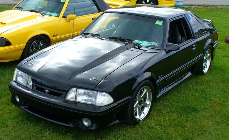

Here are a few of my buddy Scott's 88 GT. Having black carpet works better with the rear seat delete because of the way it comes up the back of the rear seats (assuming you have a hatch and not a vert) the carpet ends on the fold-down panels but the backs of the seats are still gray...makes for an awkward transition...i personally like keeping the factory gray color, unless the car is black. then it works a little better.
Sure hope Scott doesnt mind me posting his pics! His car is a-freakin-mazing.
and the car this is all in...
