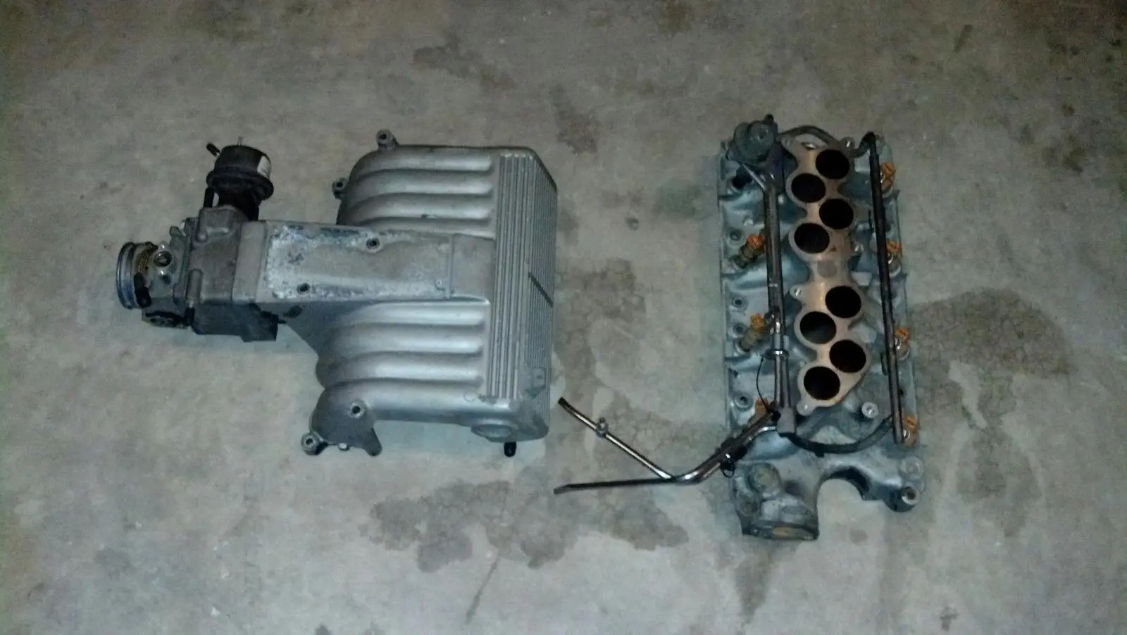

If you want a GT-40 intake, look into an exploer intake manifold. You specifically want one from an early explorer with the internal EGR. One can be had for $75-100 and will free up cash for other mods. I, along with others, can give you plenty of reason why on a stockish mustang, you want to keep the EGR functional. Nothing to gain by removing it.
This is the GT40 intake, upper, lower, and TB the guy has for $150....
These will fit any 302? He said they are from late 90s Explorer
