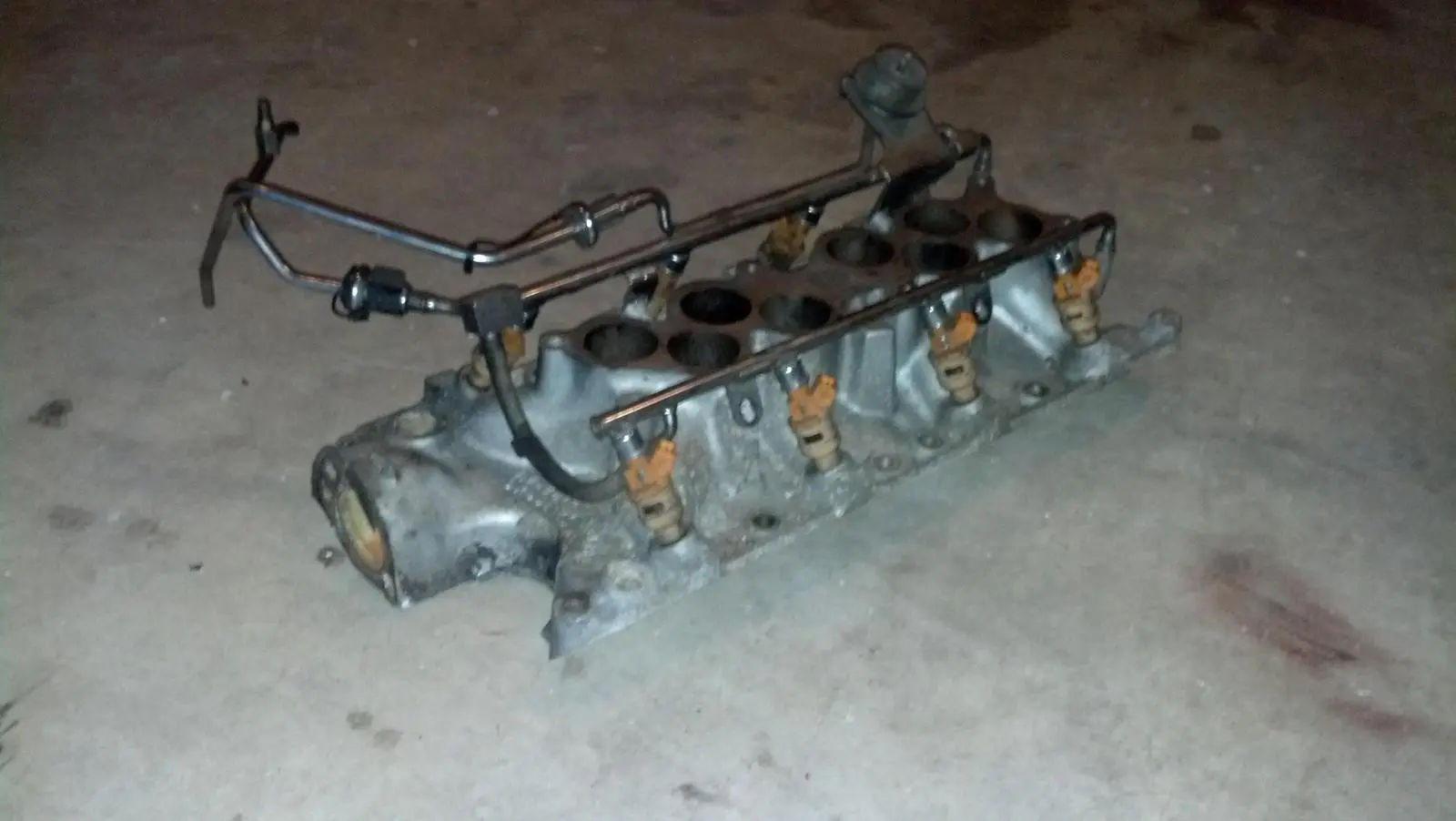

Two.. I don't see any pics of the intake but there are a couple of things about the swap
Does it have the #5 intake boss drilled and tapped for the IAT sensor
Likewise, if you are going to be running the stock EGR coolant and heating tubes, you either need to get the explorer hard coolant tube or tap the back of the lower intake for the return line bung if you want to transfer over your hard coolant lines, as it uses the lower intake as a return. The explorer hard lines do not.

I posted a picture on the first page.

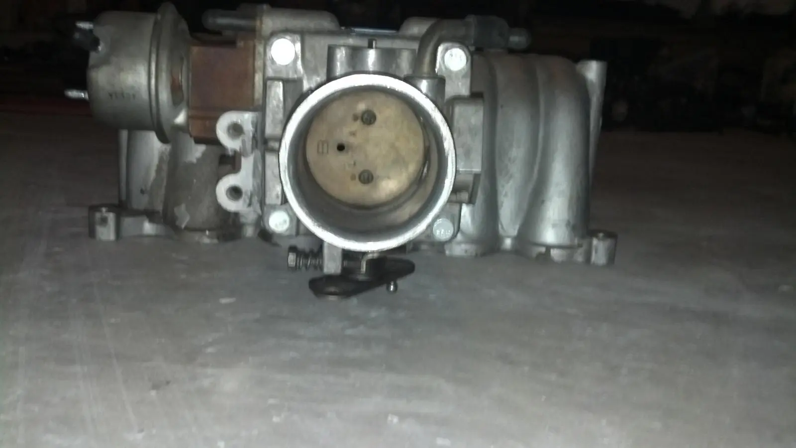

It comes with the Explorer TB already on it, which I believe is a 65mm(?), so I won't bother searching for and buying a 70mm, not worth the cost.

just saw the pic. Looks like the #5 runner is tapped. There are no coolant lines and I can't see the rear passenger of the intake so I assume it is not tapped. Your call- either drill and tap the boss back there for your existing hard lines or if you don't have heat just screw in the temp sensor into the opening in the front- looks like that is what he did but pic is fuzzy.
it has stock injectors

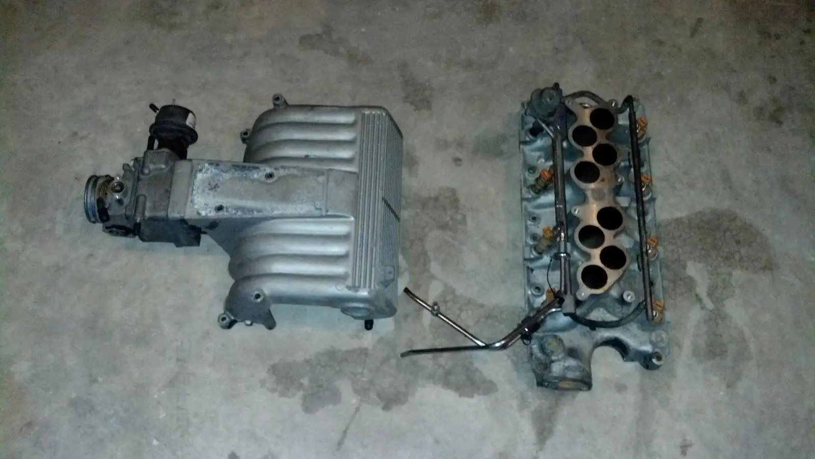

that thing looks awful carboned up. I would at a minimum break it down and soak it overnight in some seafoam or better yet buy the bucket of parts cleaner or have a machine shop hot tank it. Same for the TB and EGR, give them a good cleaning . Replace all the gaskets- intake, TB, EGR,. You'll need to swap over your IAC and TPS, and I would replace the FPR while it is off- cheap insurance.. IF not running the coolant lines. cap off the two lines on the EGR. Finally, you'll need to address the vacuum line routing fir the FPR, cannister, A/C, etc. coming off the upper- again buy 10 feet of new hose as cheap insurance..

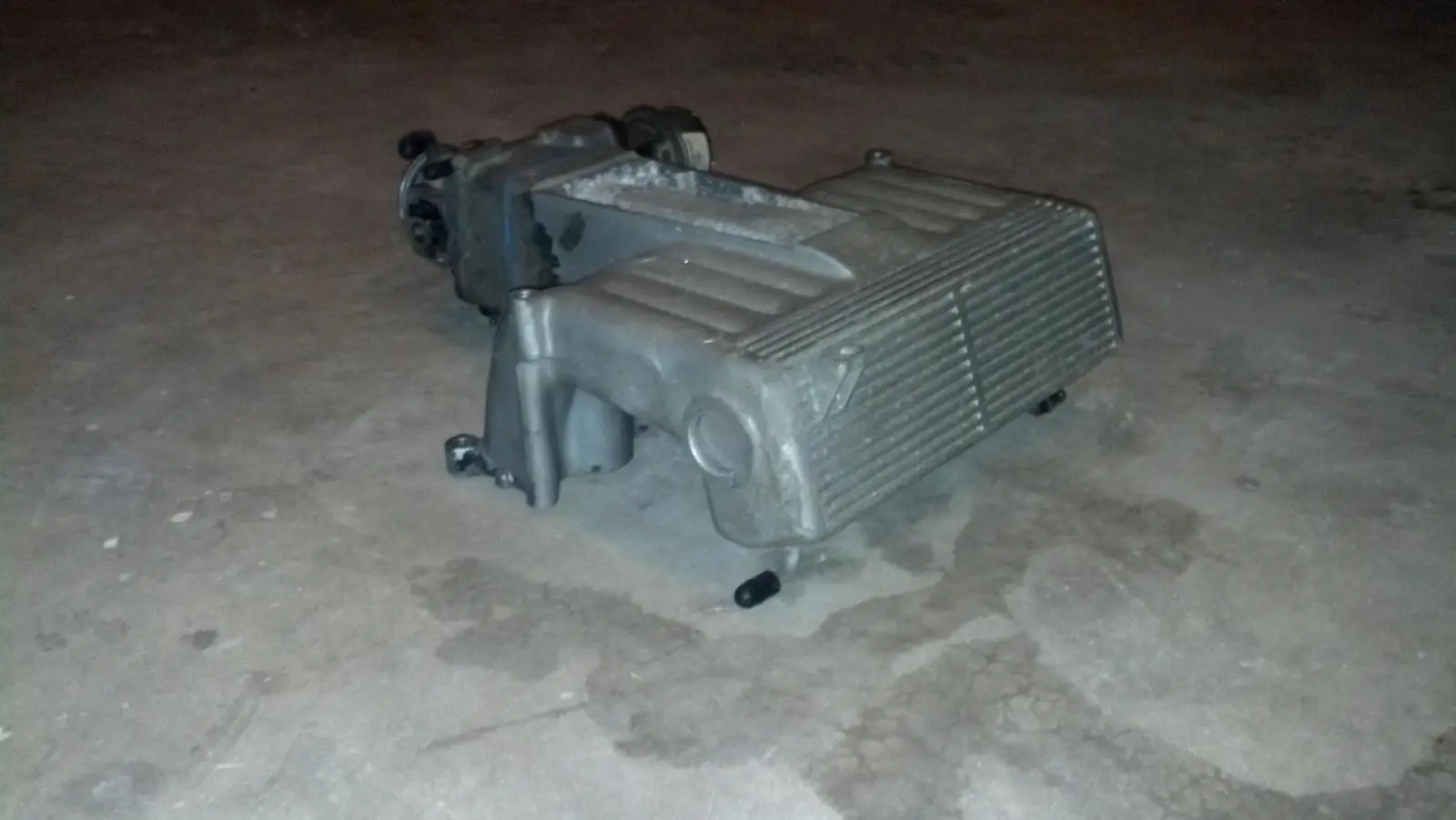

Here are the other pictures he sent. I included the one I already posted as well.

You can extend the wiring and put the ACT in the airbox. Not a big deal.
Tapping the boss is not that hard, but that lower is a -BB (later model) Explorer lower and the boss is not as "meaty". So you'd have to be careful. Extending the wiring is simplier.
If it was an early model -BA lower intake, i'd just say drill and tap
