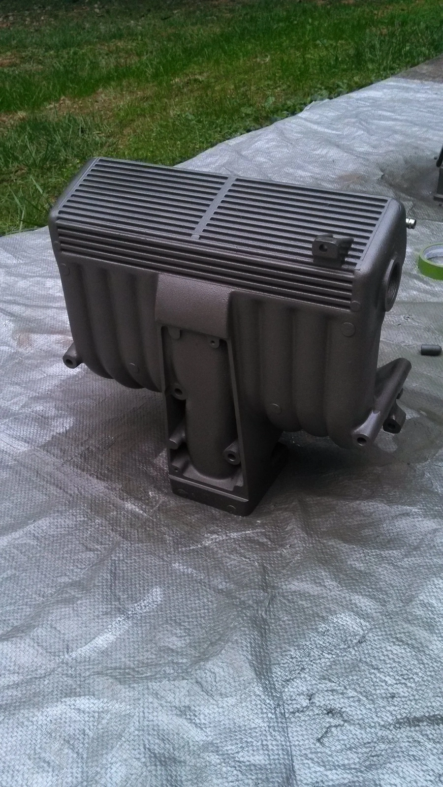

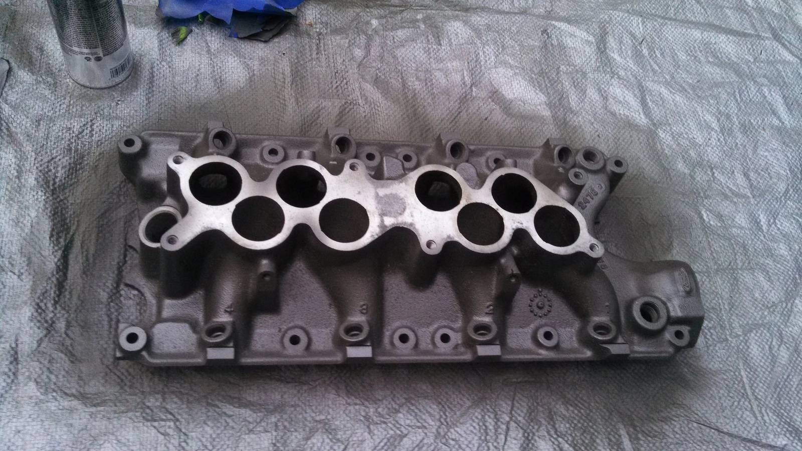

Well now that I have cleaned the intake upper, lower, and TB very well. Removed all old paint and such. Then I primed and painted them....attached are the pictures.

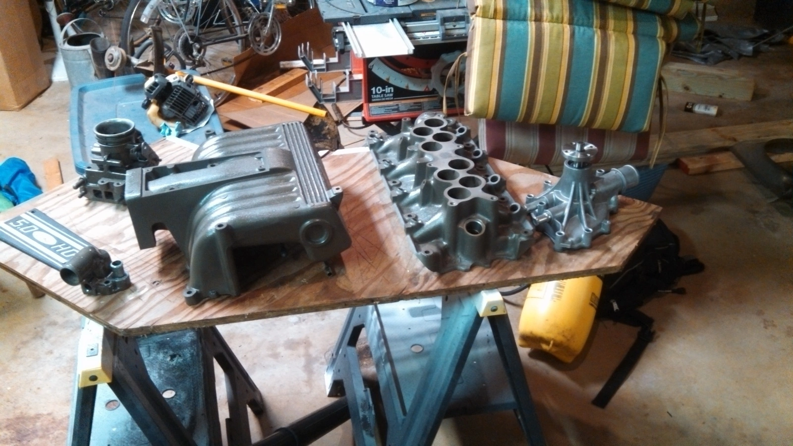

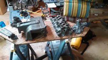

I took everything apart....currently, my car is sitting with the top half off. I'm a bit confused on how the coolant running works.

There is a hole on the very back of the lower manifold, the stock had some sort of filter thing? A lot of metal and such inside, with a rubber insert on top...I have no idea what this is...Answer?
There are the two ports on the back on the lower manifold, that had coolant lines going to them, one from the EGR...and I don't remember where the second goes....I believe this is what you (mikestang63), were mentioning?
I do have heat....so do I need those lines for heat? Those two ports are not on the back of the GT40.....How to fix?

I forgot to attach the pictures of the painted intake. I also painted the throttle body, and thermostat housing. And I'm putting on a new high flow FR water pump
You can grind down that cable bung on the upper manifold so it's flush, as that isn't needed an makes a cleaner look. Take a look at the pic of mine in my sig.....

I believe the hole in the back of the intake is the PCV valve? For that I need a new grommet? (Looks like a filter) and a little valve goes inside? Then that line goes to the upper intake? So whatever is sucked in can be burned? That's my understanding of the PCV valve system...
The two coolant lines on the back of the stock intake I believe one came from the EGR and them through the lower and then into the upper? Correct?
Since the EGR will not have coolant going to it, I can not worry about those correct? I know where the heater core lines go and come from. That isn't an issue anymore.
