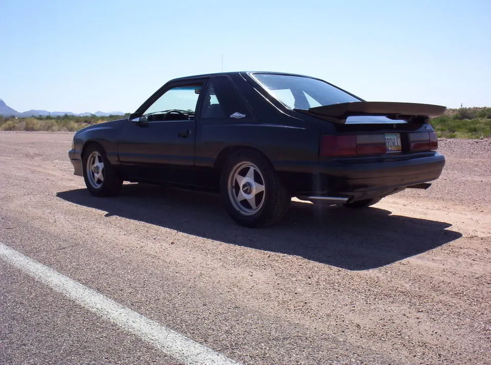

This is my Mercury Capri.

Yeah, I was talking to you. That looks like a nice starting point. Make sure to keep us updated as you make progress. The 85/86 front end is one of my favorites.
I started a project thread over in 2.3L tech (not sure which way I'm going engine wise). http://forums.stangnet.com/769422-93-project-pics.html . I plan on documenting and taking pictures all along the way and sharing with everyone. I know how much I enjoy seeing progress threads w/pics, so I'm going to try and return the favor. I appreciate the encouragemnt.:nice:
