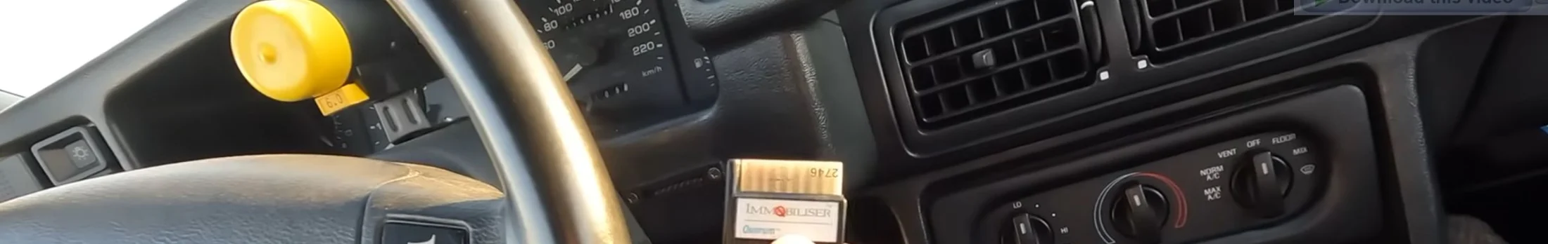

Late reply, but I have a chip I need to plug into the dash for the fuel pump to turn on with the key on and the car will not get spark and will not turn over and will not start. . I think the guy installer did not realize that the chip needs to be plugged in for the fuel pump to run so it got bypassed. I never realized till a while later when I had the car running I would pull the chip out and the car would always stall, and you could hear the fuel pump shut off. Not now the fuel pump keeps running, I was like WTF. I think I am going to buy the 1986-04 Mustang Fuel Cutoff Inertia Switch & Harness from lmr and get it done properly this time.
