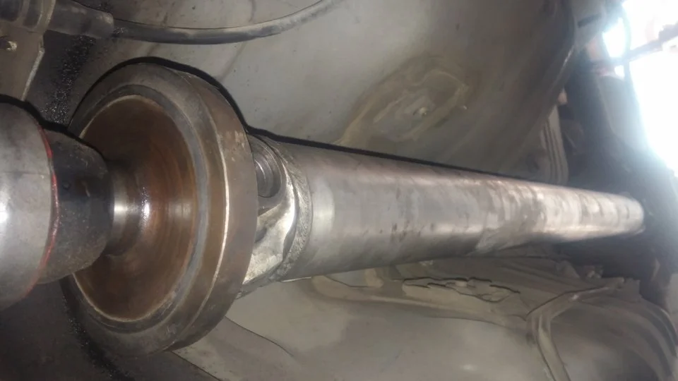

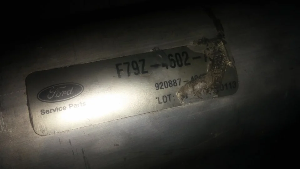

Just installed an aluminum driveshaft in my fox from a 92 aerostar with electric awd. Swap was easy just swapped yokes from the steel mustang shaft to the aerostar one. Stock mustang u joints fot perfectly, nothin special required.

The AeroStar isn't the same as the Ford Racing Aluminum driveshaft.
This driveshaft is not an exact duplicate of the Ford Racing part. It is 3” in diameter while the Ford Racing part is 3.5” in diameter. There is no guarantee that the balance will be any better than the stock part.
Use a piece of string and wrap it around the driveshaft. Make a mark on the string where the ends overlap. Measure the length of the string:
On the 3" AeroStar driveshaft the string will be 9.42" or about 9 7/16" long.
On the Ford Racing 3.5" driveshaft the string will be 10.99" or about 11" long

Wanted to let you guys know that the swap was a success, no vibration or other driveline issues. Maybe its me (or the heads/headers I installed) but it feels pretty peppy from a stop
