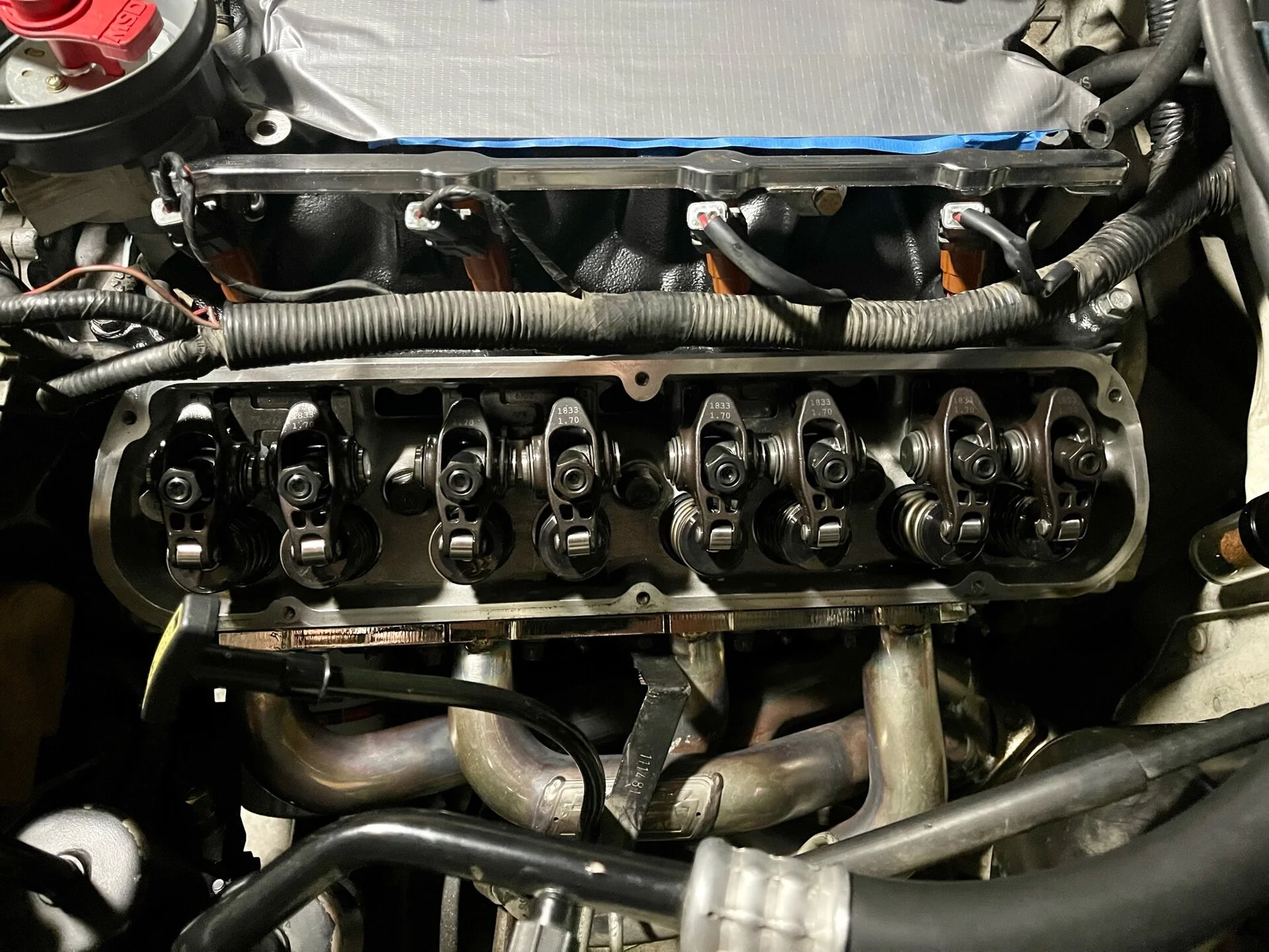

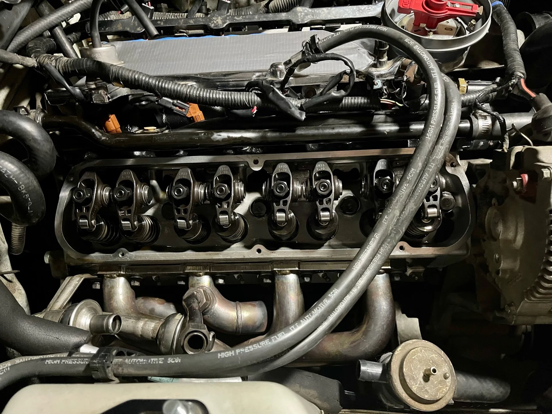

Heard a lot of noise (rattling/clacking) coming from my drivers side head. Pulled my valve covers and noticed that basically all my 1.7 Roller Rockers were wiggle loose and not aligned with each other.
So, should I loosen each one, verify lash, set lash, tighten half turn, lock it down, then another quarter turn?
I have never did this before, any help is appreciated.
**** Edit **** Correction: I was able to pretty much align all of them by hand.

You need to adjust the guide plates.
Reactions: #16Stang

I agree on adjusting the guide plates or do your pushrods not fit the guide plates correctly?
It is normal for the rockers to flop around some on the style without the pedestal
I have boss 351 heads on my 302 and the rockers do not have the slot and the heads do not have the pedestal with the groove either
That makes them move around a ton
As long as the clearance is correct you should be good to go
I would suggest you add lash caps in case of any valve tip wear would be on the lash cap and not the valve

Is it just me or are none of the locks tightened down in those 2 pictures?
Reactions: manicmechanic007
