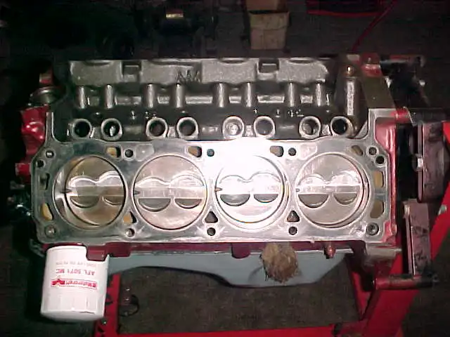

I went from GT40x heads and E303 to AFR185's with XE274 and yes the pistons required an extra flycut to clear the outside section of the larger valves.
As my engine had done a few miles I didn't really want to disassemble it just to flycut the pistons a tad more as all I wanted was to test it as a 5.0.
Then I would make the decision whether to rebuild it as a 5.0 or go to a 347 so I decided to do it while they were in the block.
It was a simple excercise. I masked the complete engine up including all the ring area of each piston to be flycut when at TDC.
Used a small air grinder with an alloy cutter. It was actually easier than I thought it would be. I went slow and careful and they came up looking fine.
I then test fitted the heads and plastic checked and clearance was perfect :D
It might depend on how much cut your current pistons have as you can see mine already had a reasonable cut and it just needed a slight extension etc.
But you can get cutters that fit in your valve stem and you spin them with a drill etc. They're basically a valve with cutting material on the face. You would probably still need to champher the edging after etc.
It's the top reliefs in this pic that I modified :D
