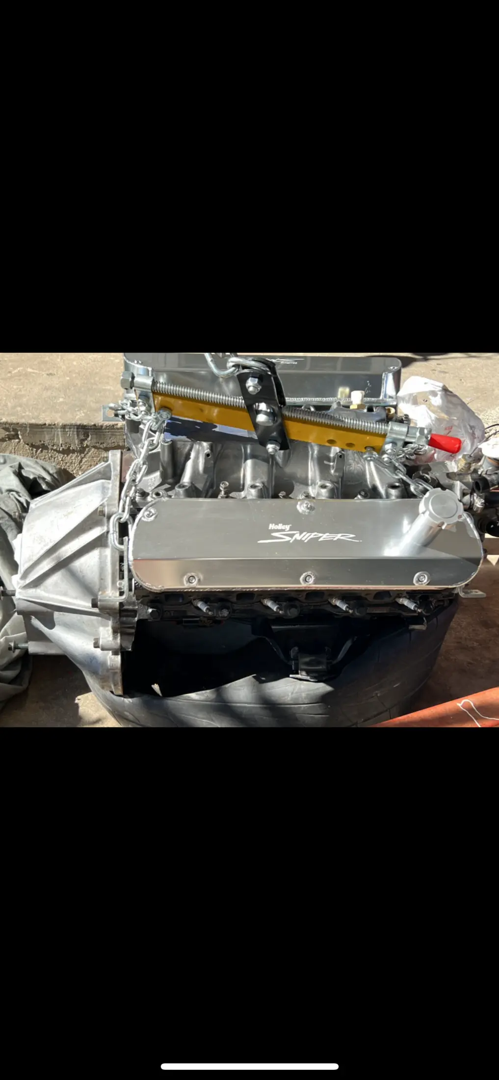

It ran better with the ones with the breathers lol! Now I have these the sniper efi ones. Do you think a bad regulator can just not be working properly? Without it leaking fuel?

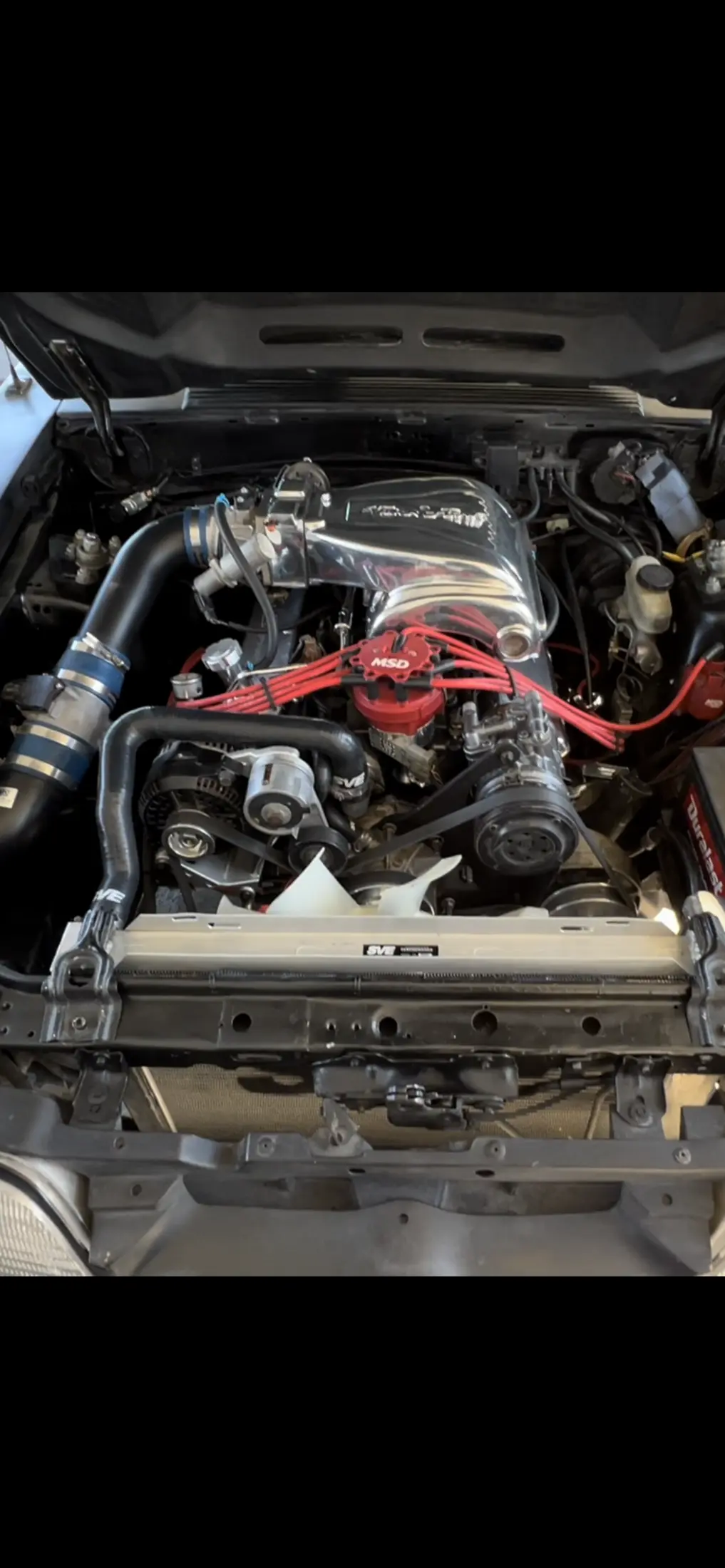

If that MSD distributor has a MSD TFI and PiP then those would immediately be suspect for me. More people have had problems with them than not.
