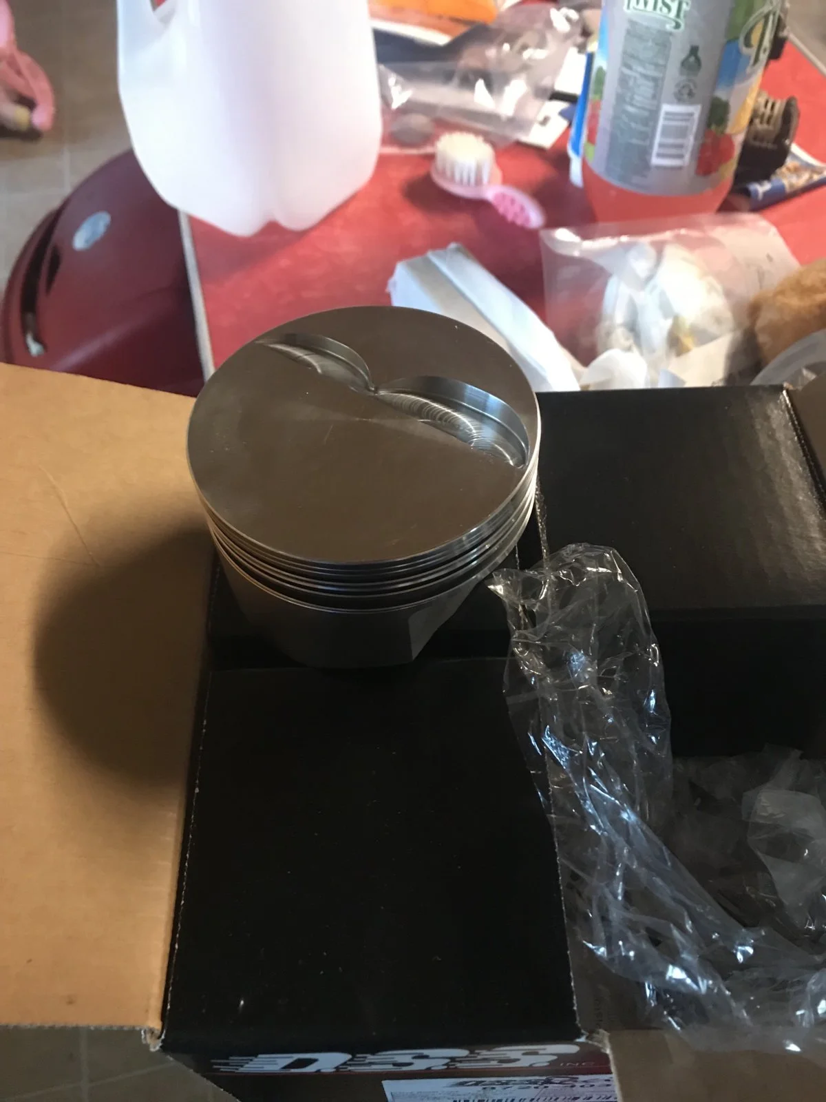

Ok I’m building a 306 and I have dss E series 3cc flattop pistons I called them about questions on heads as I was looking at promaxx 180cc or a trickflow 11r and was told nether would work Bc the promaxx max heads have spread valve centers? This went way over my head and the 11r won’t work Bc the pistons don’t have enough valve relief for them Bc valve angle they suggest switching to sx or gsx piston or go to a 1.94 valve ether edelbrock or Windsor jr heads???? But they told me b4 I bought the E series they would work with 2.02 valve but here I am now asking for help
They aren’t giving you false info . Those pro maxx heads ( wouldn’t touch with a 10ft pole ) I believe are copy’s of the twisted wedge head . The 11r is a twisted wedge head as well . Neither of them have a standard valve degree angle . Valve size aside they are saying it will hit the piston
I’m sure afr , Edelbrock or even a high port would work being that your pistons seem to be cut for standard valve angle heads
The pistons r cut for a 2.02 valve and the promaxx heads are 20 degree valve angle 11r is 11/13 degree valve angle

Ok so do u think edelbrock performer rpm heads would be a better option? The guy just got me confused when he told me the pistons wouldn’t work with the heads Bc the 2.02 intake but when I ordered them was told they would and like the picture shows has pretty good size reliefs
It's not about valve size it's about where the valves are located in the head. Here's a little visual game for you that will help.
Stand up, stretch both hands out at you sides even with your shoulders like you did when you were a kid playing like you were a plane . ( you should do this in the privacy of your own home)
Standing like this,.....Your hands represent a standard vale angle orientation. Along the same line, both at the same angle basically, in a row.
Now...
Take a baby step forward, slightly twist each hand in opposite directions , and Turn at the waist a quarter turn.
Aw ohhh,..Your left hand is now forward of your right hand, and they are no longer on the same plane or angle compared to where they were before. Now,..if your hands were valves, they'd crash all into the reliefs cut in your standard Pistons because they are no longer in the right place.
So you have to get a head with a smaller valve, or a different piston altogether to prevent that.
Trick flow does this to move the valves away from the sides of the chamber, and to put them at a better angle that is more conducive to airflow, and in the case of the exhaust valve, more optimally placed for a better exhaust scavenging. ( at least they think it does)
My example is an over exaggeration of the angles and twist,..but maybe now you get the idea.
Those would prob work or I’d lean toward a Vic jr head honestly
Just got off the phone with dss they say with the camshaft I’m going to use that edelbrock would be only safe bet for 2.02 would have to check good they advise me to back down to a 1.90 or 1.94 intake so guess I got to go that route

I made my statement based on your own words. You couldn't comprehend that a twisted wedge valve orientation wouldn't work with the inline valve reliefs cut into your pistons. You said " that went way over your head". And later conversations talking to the tech guy confuses you when he tries to explain that you may have a piston to valve interference issue with a 2.02 valve, and is now recommending a smaller valve head.

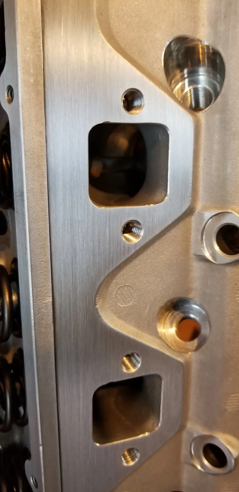

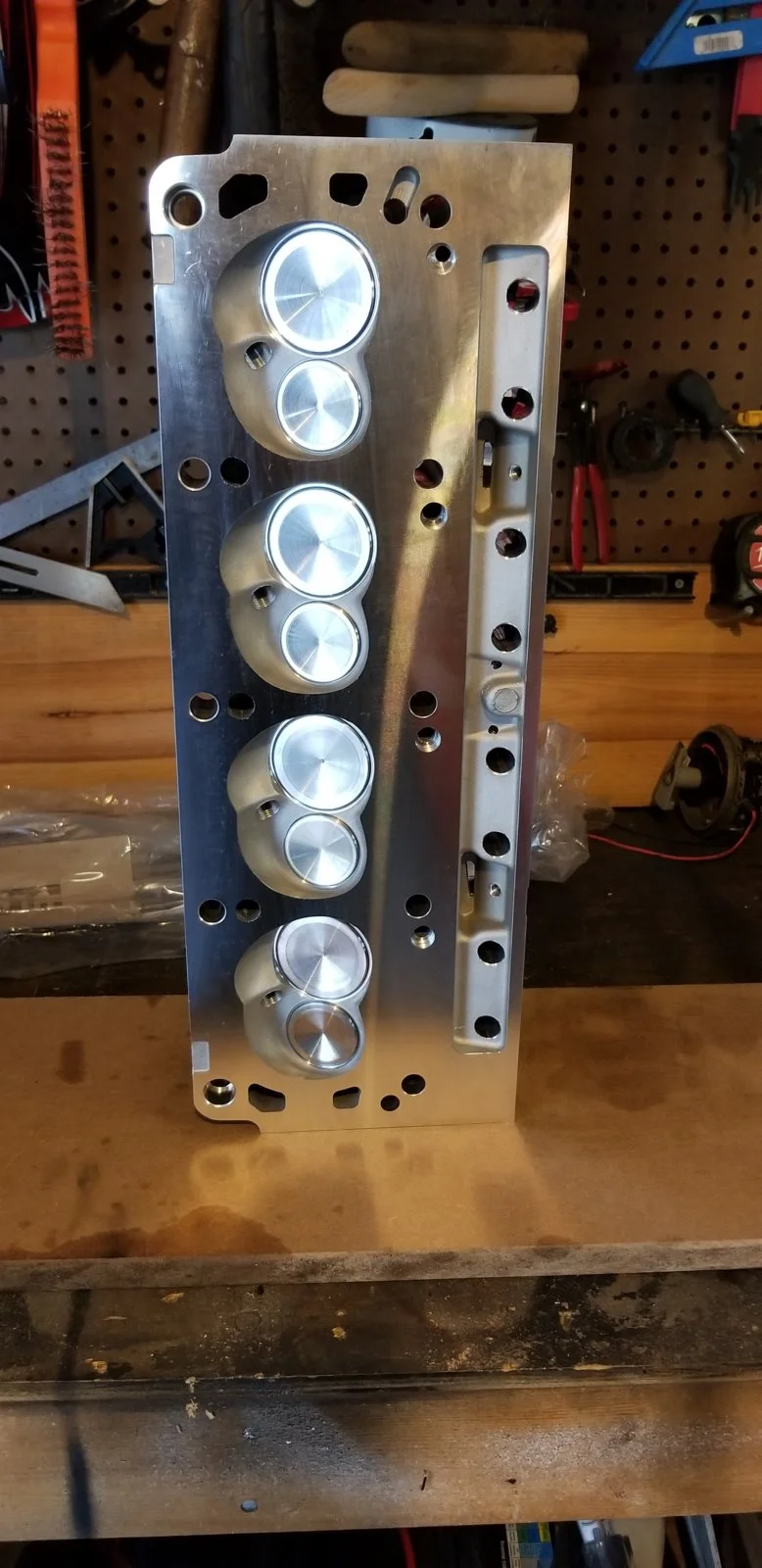

I have used an E series piston with a standard valve angle head with a 2.02 valve up to 600 lift with healthy duration.

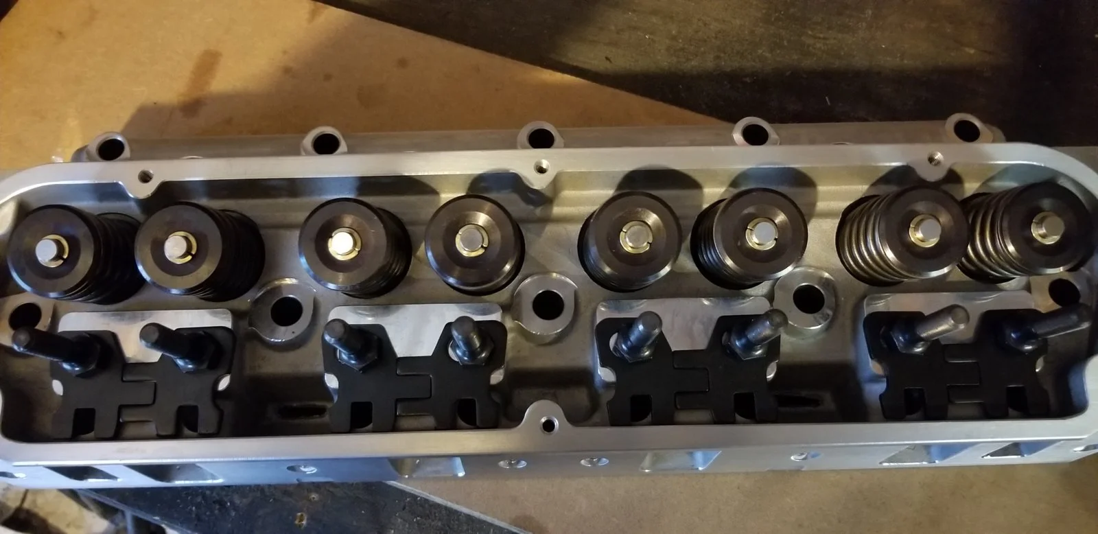

The ProMAXX heads are actually pretty nice, I have a set ready to go on my 393w.. I was very surprised at the quality and finish, I have seen some very nice heads and some complete junk and would give these a 8/10. Still going to have a shop check them out before they go on the engine.

The 11r and promax 180 are two different heads... one is 11 degree head with the intake valves relocated while the other is standard 20 degree head.
I would imagine you could just have the valve pockets adjusted on the pistons you already have in hand rather then dropping down to a 1.94 not 100% but i'd look into that route if it were me

The valve reliefs in the E series are fairly large, however they do not extend to the very edge of the piston. The promaxx has the valves spread apart to allow very large valves on there shocker seires head. It does not require a special piston, but does necessitate a more aggressive piston to be used. The E series is meant for mild rebuild applications. with a zero deck and a .42 gasket with a 60cc camber you should be around 10:1
