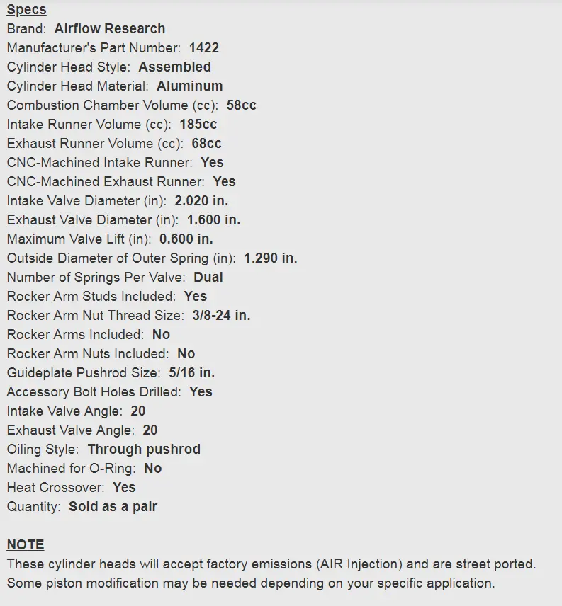

From LMR's website, here's what they say about one example of a 2.02 inline standard angle head. Skip to the last line:

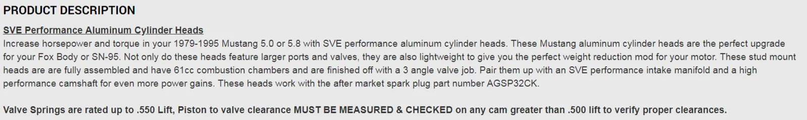

Here's the SVE 170cc 2.02" IV inline standard angle head:
Nobody with an aftermarket cam is going sub .500" lift, particularly the OP with his Voodoo cam.
I don't think anyone here said what you think they did, as I don't know when this discussion ever brought up a stock cam.
