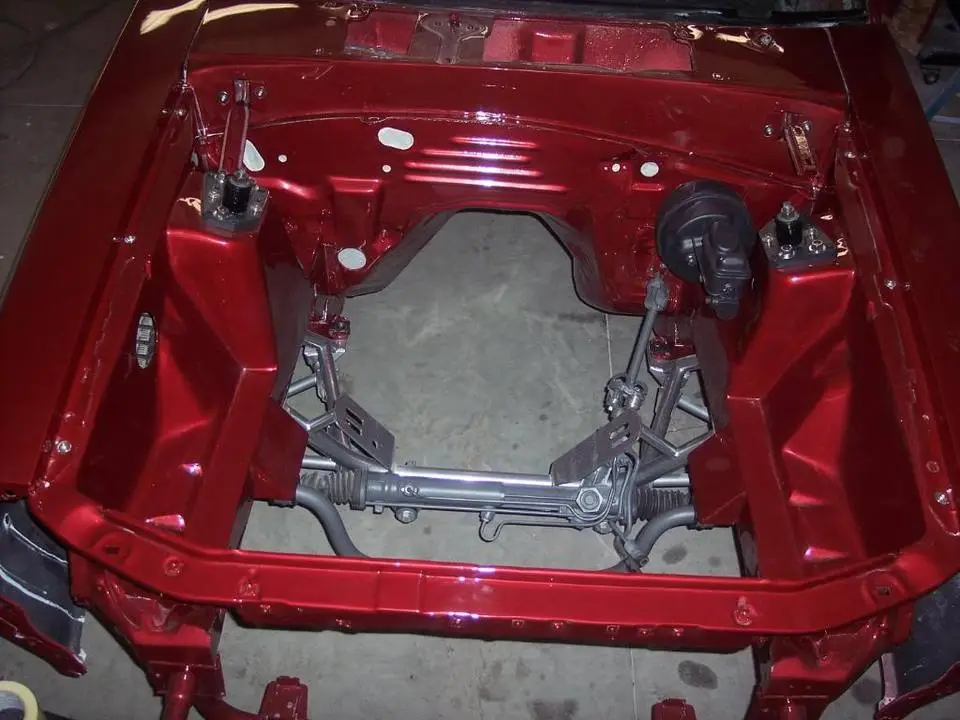

i have the qa1 version. dont flame me. i gussetted and re-enforced the brackets for the a-arms and main support tube along with the motor mount plates. it moved the tires forward 1". with stock a-arms. the only clearance issue i have is the inner tire will rub on the inner fender at full lock. but the car is also lowered 2" in the front. i have a 351w in the car. no clearance issues at all with headers or steering shaft. it looks better, its lighter, its easier to work around (ex: changing oil pan gasket/oil pump) and it changes the ackerman angles. better than stock

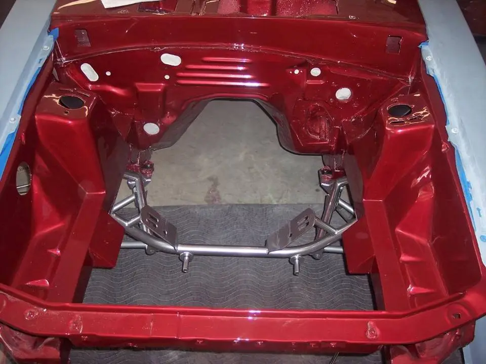

This is the second UPR K-member I have used, one in the 93 and this one in the 84
makes a lot of stuff under the car a lot easier to do. i hate changing oil and pulling the starter from a car with a stock kmember. hell i changed a freeze plug with the tubular one.
