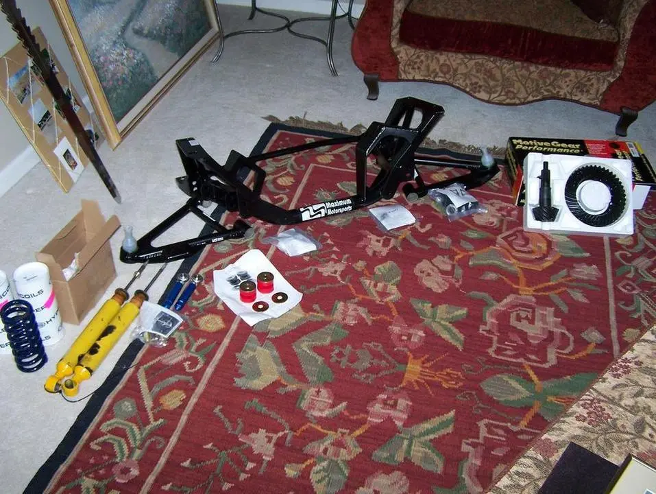

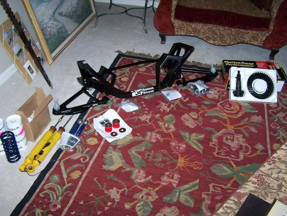

Well, I decided to change my setup...again... Checkout all the nice Maximum Motorsports stuff they just happened to leave at my door step! :nice: :banana: :banana:

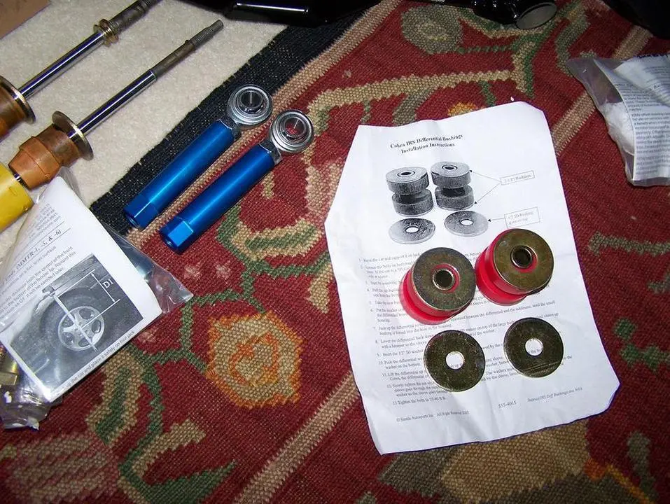

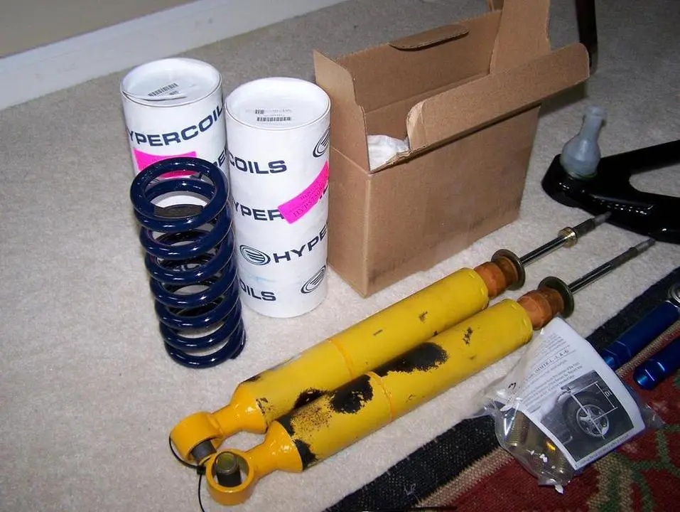

From left to right: 03/04 cobra shocks w/ groove for coilovers, coilover kit w/ 575lb springs, bolt through tie rod end link kit, diff bushings, tubular A-arms non-offset with urethane bushings, K-member 4.6l, spherical rack bushings, motive 3.90 gears.

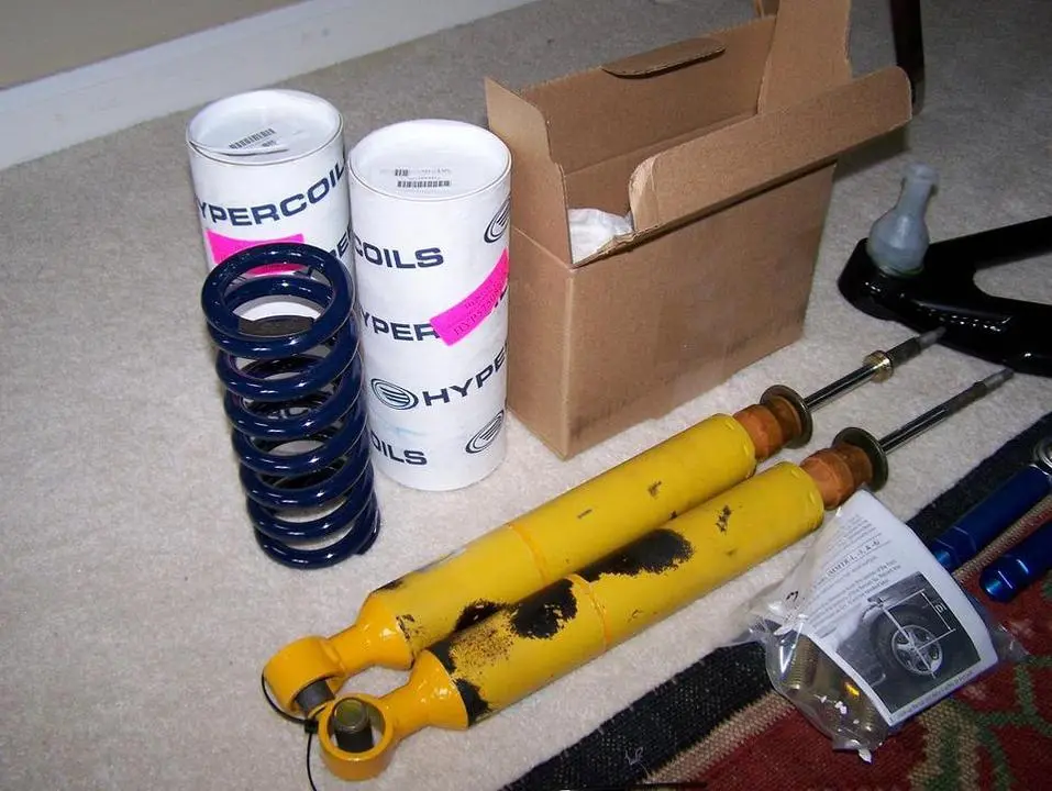

Coilovers and shocks.

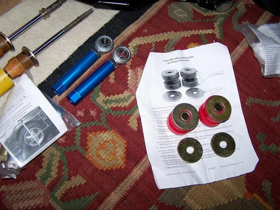

Endlinks and diff bushings.

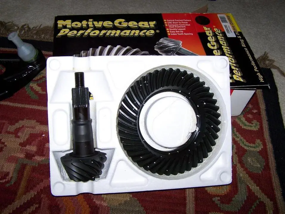

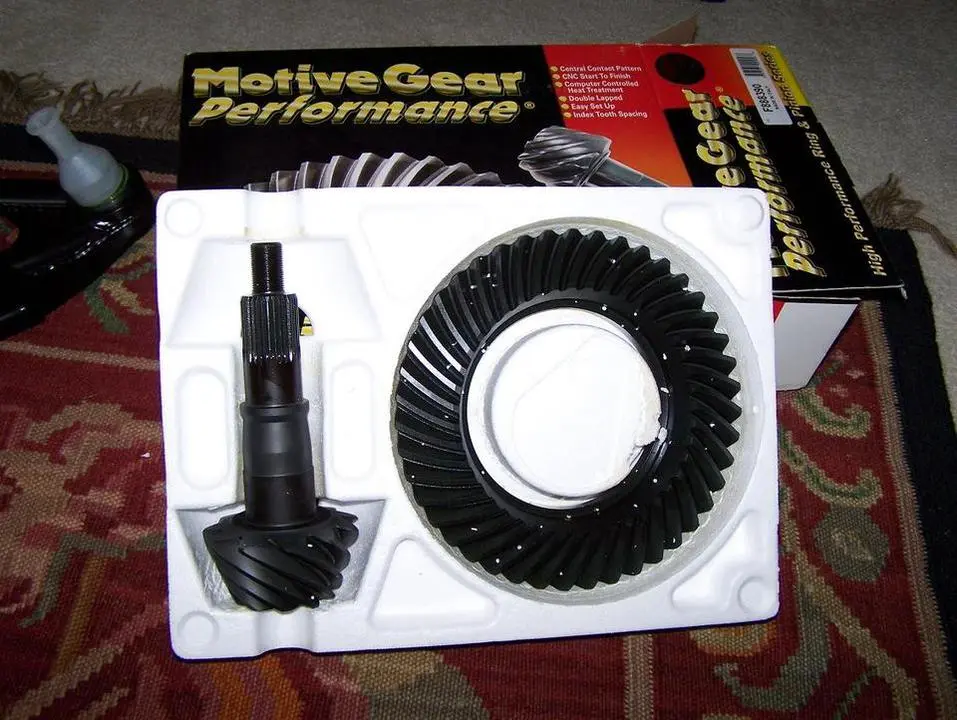

Motive 3.90 gears.

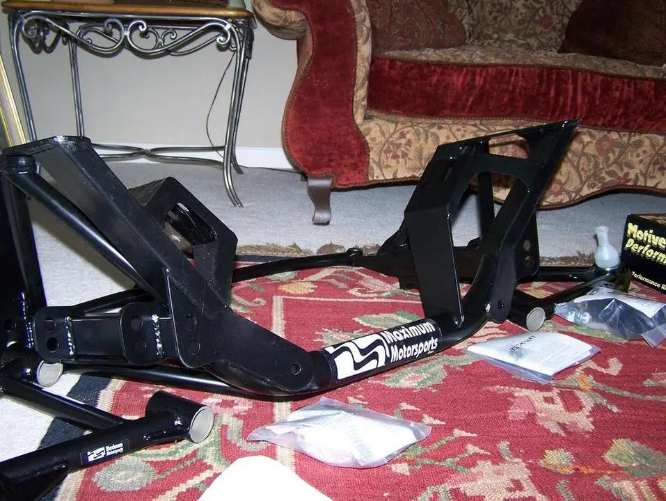

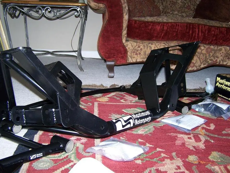

:drool: Maximum Motorsports K-member - total weight w/ 2 point brace, 42lbs.

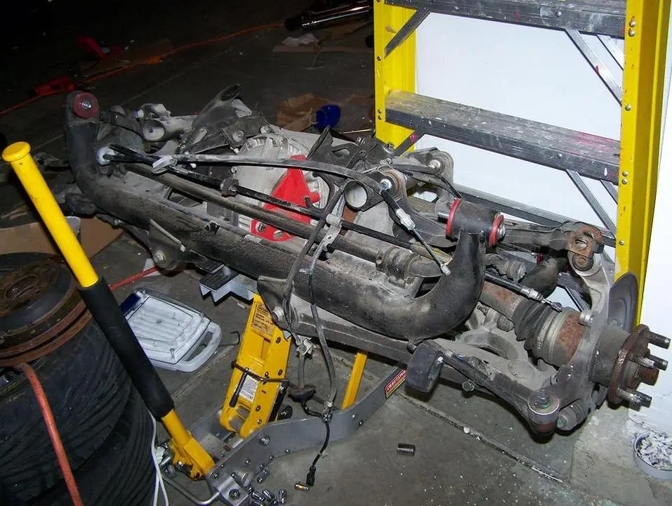

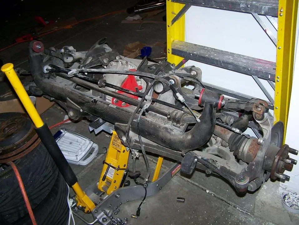

Oh yeah and 04 cobra IRS with billetflow IRS diff brace, MM subframe bushings, MM low profile subframe bolts (cough, 10.5" rims, cough).

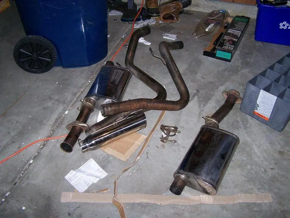

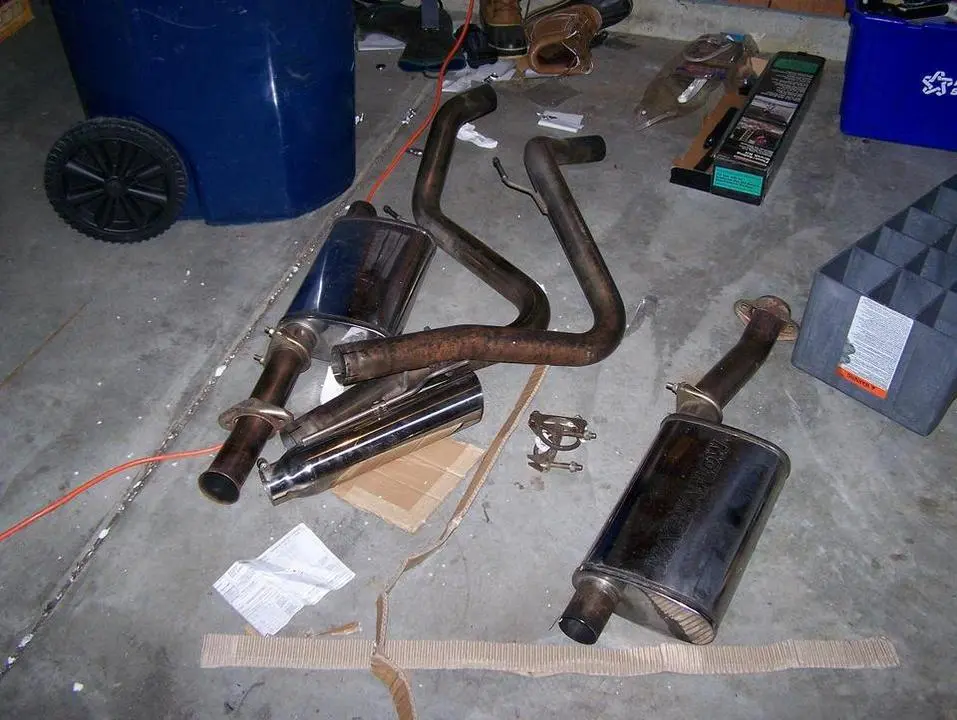

Magnaflow catback, picked it up for CHEAP :D

I went with urethane bushings all around instead of delrin/aluminum because this is still a street car, and the NVH from solid mounts is pretty meh.

That is an amazing pile of parts! I bet it costed an amazing ammount of money too. Are you going for the corner carver attitude or something?
Yeah I have about $2500 invested right there...but after selling my built solid axle, all the suspension stuff, and some front end bits I don't need anymore...total cost is around $500 :D I've always been a corner carver :nice:
Everything goes in this weekend if I can get my buddy to do the gears for me (Don't got the pinion depth gauge needed for measuring with the motive gears, blah!). It's gonna be nice...seeing as I have only driven the car twice since November! :rlaugh:

This is a different IRS, I got the last solid axle for free + 700 for the IRS, alls I had to do was put it in the guys car, hehe. I always liked the IRS, but I switched because my last one had no ABS (broken sensors), and needed a diff rebuild, so I just got rid of it :shrug:
I sold my Borla catback for solid axle, new magnaflows are going in the car ;)

Also, on SVTP the aluminum diff bushings are preferred over the urethane due to the fact that urethane will melt and the aluminum bushing is an adjustable design to allow adjustment of pinion angle. You are going to need to be able to adjust pinion angle with the modified suspension components. You might consider going with the aluminum bushing or at least calling MM's tech line to ask them about it... Most people say the NVH is not really that bad but you ARE doing gears so any whine present will be transmitted by the aluminum bushing... The bad news is that the aluminum bushing costs five times as much :(

Yeah I can adjust the pinion angle, just gotta buy washers of various sizes and I have access to a lathe at work. I've had the urethane bushings before and was satisfied with them, and the amount of NVH (Mostly NV) that solid mounting rear end components can cause is not good for a daily driver. Very true about any whine from gears being transmitted through, my buddy has 4.30's that sound like an angry cat due to the solid mounts in his setup hah. The whole melting thing isn't going to be a problem, I'm not going to be open tracking the car competitively. This is my daily driver/fun street car/weekend autox & drag car.

And holy cow that MM front end looks SOLID and incerdibly strong! But its definatly heavy. I think my PA racing one was like 25#s or something. I know I lost about 50 #s between the K member and coilovers...and removing the dogbone kicked it down another 8.

I was looking at the PA racing piece, especially since they are an Indiana company and all...but the MaxMotors stuff is just second to none in quality and construction! My stock K-member was ~68lbs last time I took it out, so I'm still saving some weight...and I already have the coilovers, and tubular A-arms shave off quite a bit as well (they are around 12lbs each).
