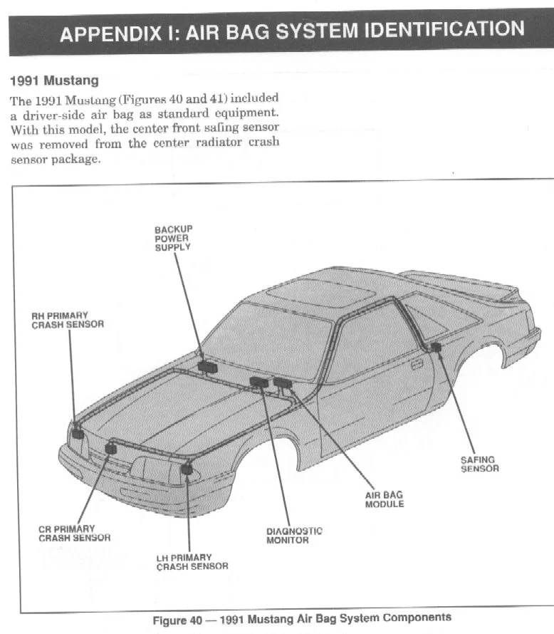

2 crash sensors and one safing sensor on those old ones
The light blue module under the dash is the backup power supply on the early ones and the module itself on the newer ones
That is what you disconnect
A pic of a 91
