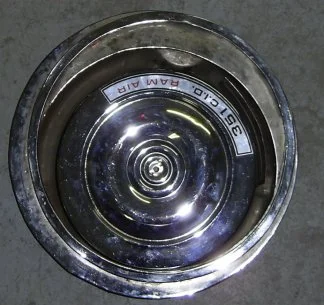

A friend of mine loaned me an original to measure
and photograph. It's been chromed, and a little beat
up, but it gives the dimensions. It seems to me that if
I take a standard 18" base, make a plate out of heavy
sheetmetal, to take care of all the offsets. The geometry
is a little weird, but it's really just 3 non concentric
circles. Then I just need to come up with something for
the top that gives the lip for the rubber seal, I should be
able to come up with something that would pass even a
relatively close inspection.
I took a first crack at making a plate last night, and
although I screwed it up, I think the concept is sound.
Has anyone tried to do this before ?
Here's a downshot on the original.
Not sure what happened to my attachment....
Oh, too big... had to scale it.
