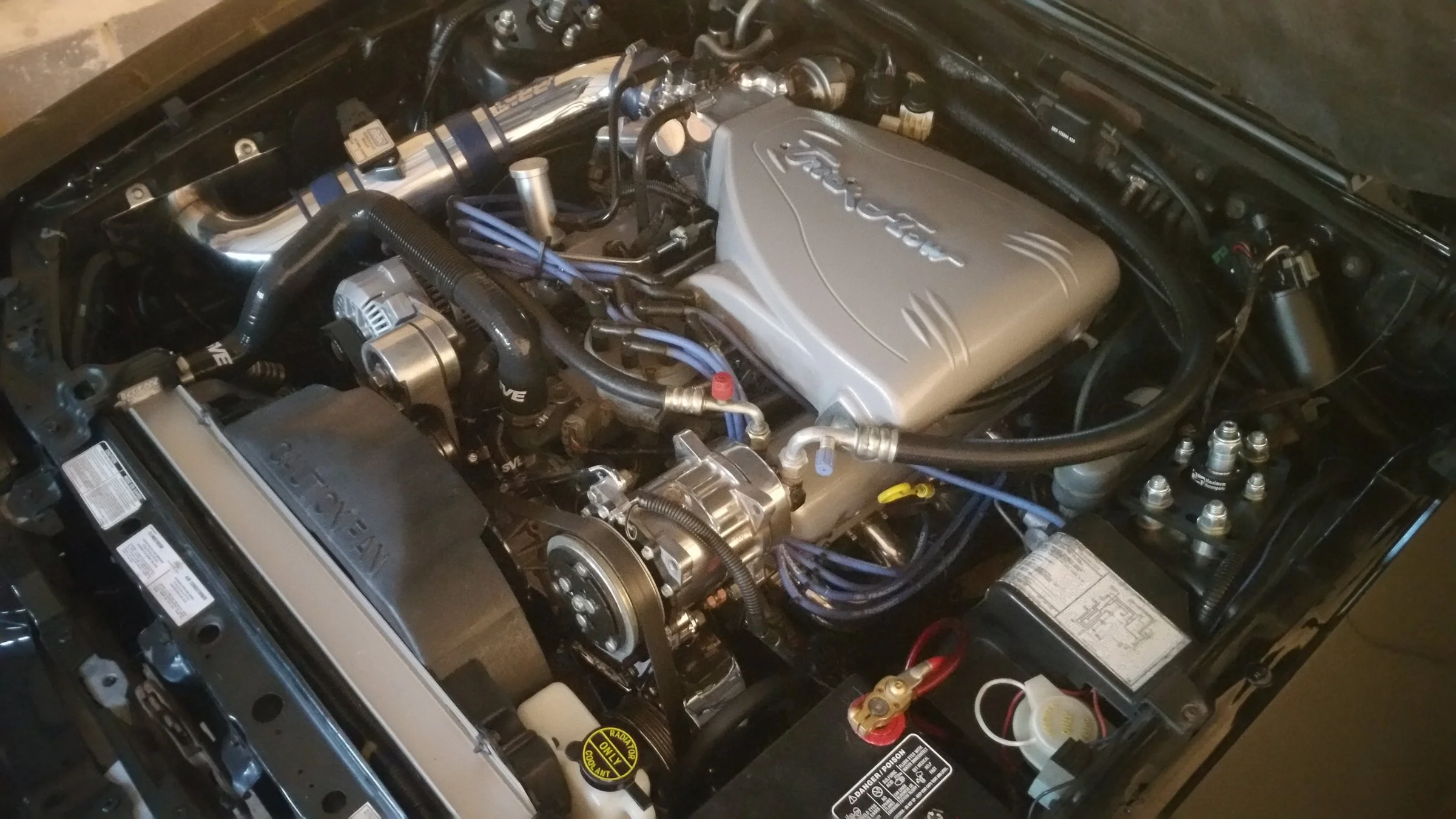

So. Own a 93 vert, thinking about putting a/c back in for kids. Compressor is still on vehicle, use it for pro charger. Should I put it back in or leave it. Live in new York, so it's humid in summer. What are you guys running?
