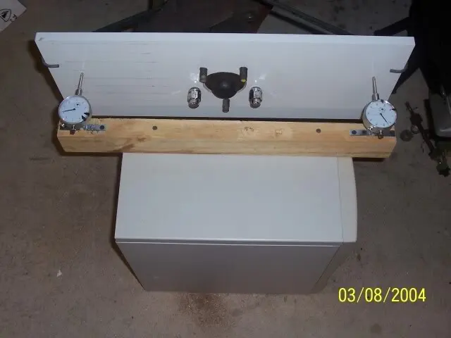

Just did a Steeda bumpsteer kit this past Saturday using a bumpsteer gauge. I have an '01 Cobra with H&R sports dropping it about 1.5". I used a level to set the camber as close to stock as I could, but at the new "lowered" position. If you're just trying to get rid of bumpsteer, you won't need ball joints unless your car is really slammed.
With all the spacers in place above the tie rod, bumpsteer was worse than stock. I ended up with 2 spacers above the tie rod (smallest and the next size up) and the rest below and that gave me a .021 tow out at 3" of positive wheel deflection (up).
With all the spacers, bumpsteer was over .220 tow out. With no spacers, bumpsteer was slightly toed in, which you never want. Bumpsteer that tows in will make it feel like the car's oversteering in a corner.
The testing has to be done with either no springs in the car (as I did) or by pulling down on the car from below with something like a "come along", but I would think you would need a lift or pit to do it that way.

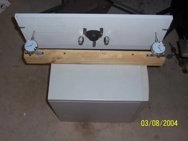

I made a bumpsteer gauge with a couple of dial indicators. (pictured below) The computer doesn't do anything but hold the wood in place. Make sure to center the gauges equally left and right of the hub or you will get some incorrect readings.
