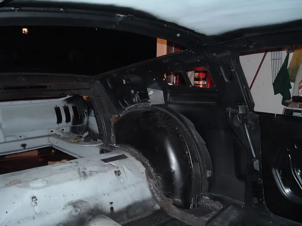

I ended up drilling all of the spot welds out and lifting the rest of the "removable cowl" off lol...I still need to weld the cowl back on.
