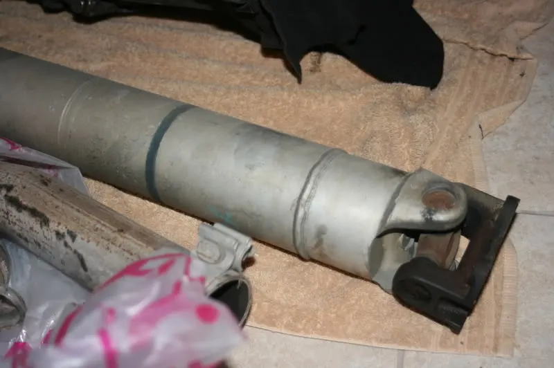

just took mine out lastnight. I had my old automatic driveshaft on there and fits quite nice.

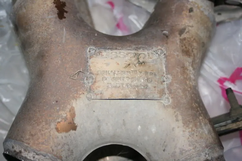

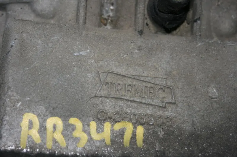

alright, just got back from the salvage yard.
got the tremec, clutch fork, steeda tri-ax, clutch + pressure plate, aluminum driveshaft, and a bassani x-pipe for 800. thanks for the assistance, gentlemen.
thanks, tom! lord knows i definately needed a tranny upgrade. my t5 was gargling bits of syncros and bearings!
they didn't know how many miles were on the trans, but the car was a 95 and had 127k. i doubt the tranny had that many, though. gonna get it in this weekend and test it out. hopefuly it won't be too good to be true and i'll have my tranny issues solved for when i get the new gt40p engine in in a couple weeks. it came w/ a 30-day warranty.

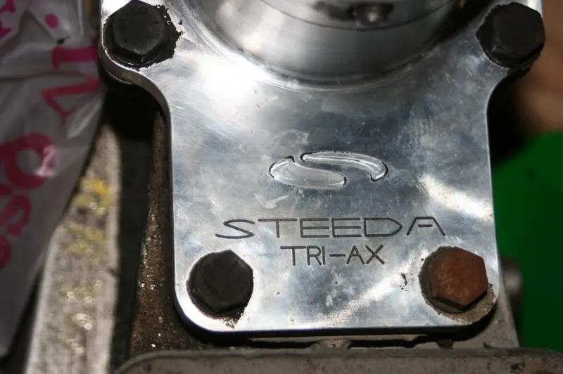

for your viewing pleasure:

yep reused the stock one. i searched around for what other people did with theirs and some just turned theirs backwards, some didnt and i couldnt really find a clear answer. a lot of people had problems with vibrations from the driveline not being level anymore and i read a post where someone suggested measuring the position of the stock t5 output shaft (ground to shaft, shaft to tunnel ect.).
after i removed the d/s and other stuff i took some measurements and wrote it all down then after i got the 3550 in i got out the tape measure and got it into position. used the stock trans crossmember, stock rubber mount and just added a 1/2" spacer above the rubber mount and a 1/4" spacer below it and the bolts were still long enough to go through and thread all the way in.
