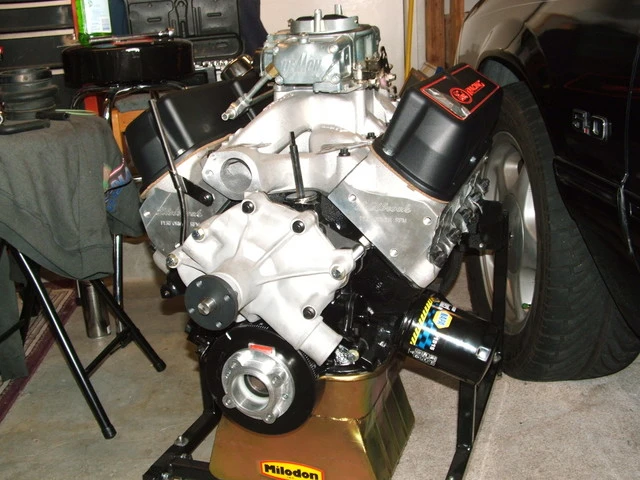

I am using the RPMs on my 331. I have had tricks on my 5.0 and they worked well. I bought RPMs this time to try to make a complete package with the air gap intake etc... :D
