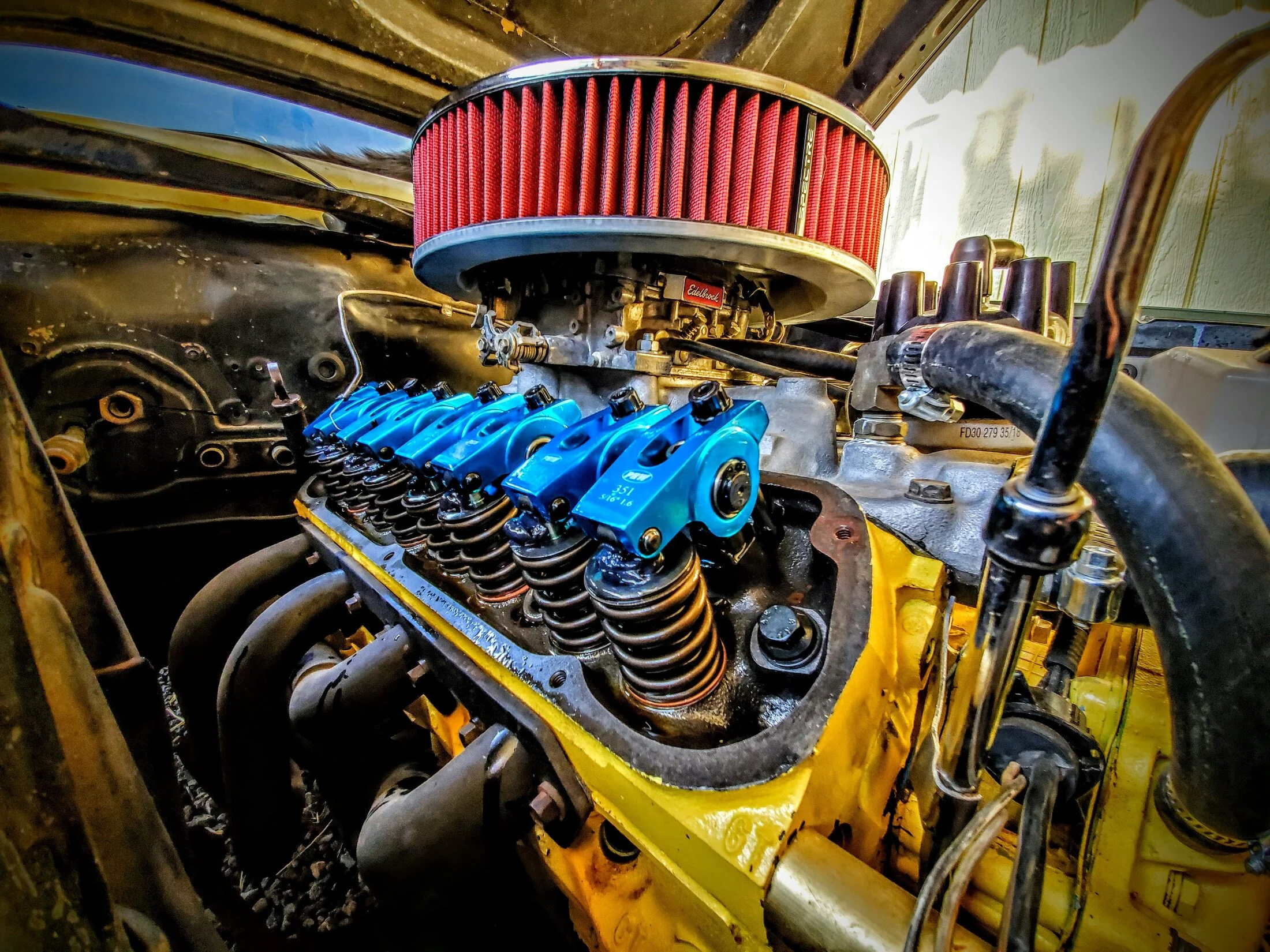

hey, I'm about to get my 67 on the road. I did a roller swap 5 years ago and put an 01 explorer 5.0 in it with the gt40 heads, and a trick flow "stage 1" cam. The base circle of the cam was smaller than the factory cam, so I was directed to put on the prw 351 full roller rocker arms on it, the ones that adjust at the pushrod. I was wondering if anyone has any experience adjusting these? I have little experience with motor building and I am hoping I had good guidance with my valvetrain setup.

So to me it appears you set the lash just like an adjustable roller rocker only you are using the valve lash adjuster on the push rod rather than the stud mount nut on an adjustable roller rocker. Their installation instructions are here but lack the detail on when you adjust each rocker.
I have Scorpion rockers and used this procedure:
I think if you just take the part out of the Scorpion instructions on where the rocker needs to be when adjusting the intake and exhaust valves you should be good.
Reactions: Blackhawkxx
