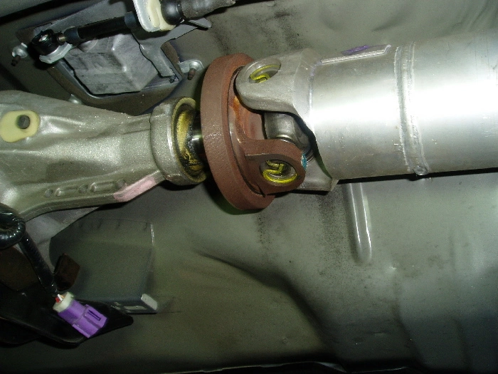

Newbie here, transfering the yoke from your stock shaft to the aluminum one, is that difficult? special tools required?
Excuse the ignorance
ImRobuilt said:
God Bless The Forum Search Option
Not hard. You'll need a pair of pliers, hammer and some sockets. If you have a vice that will help but, you can tap out the u-joints with a hammer and socket.
