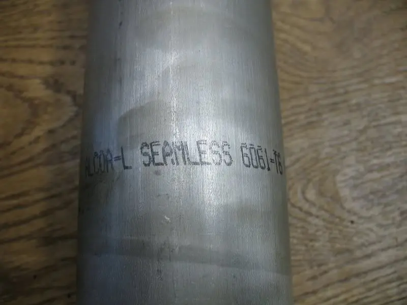

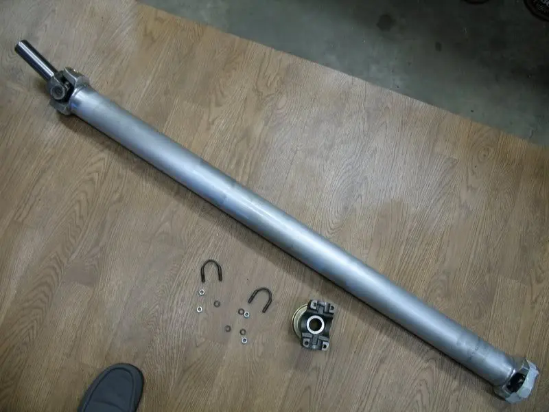

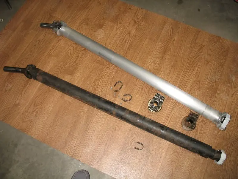

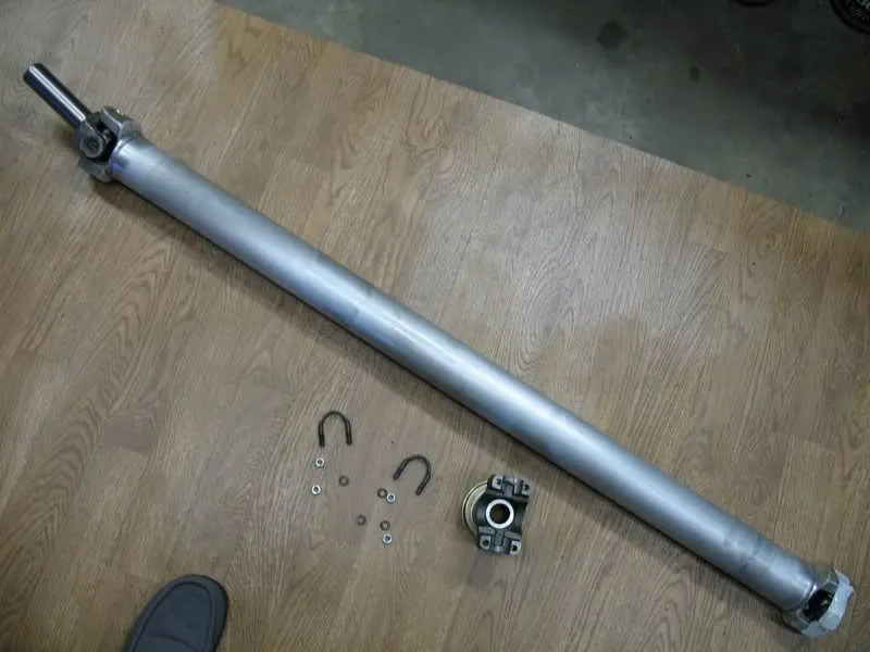

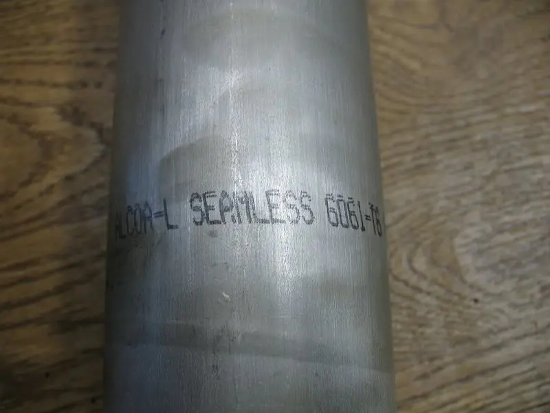

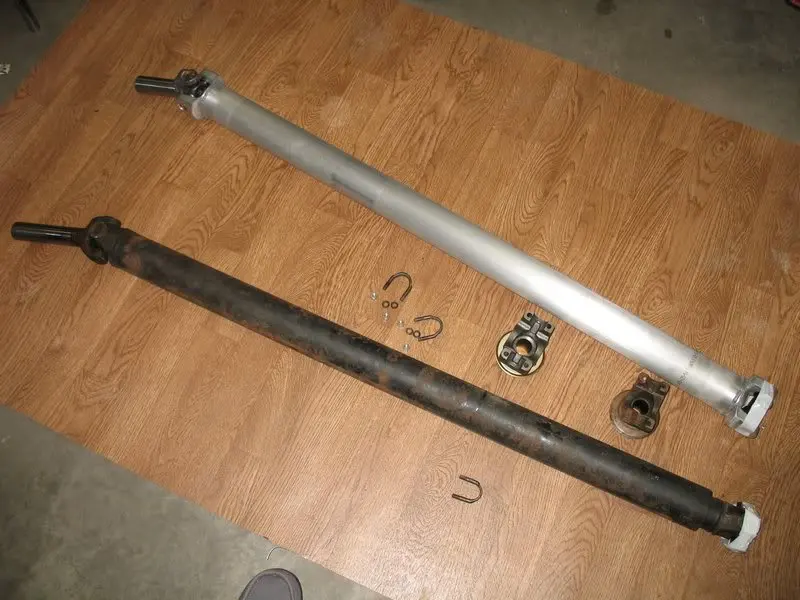

My driveshaft has the 1330 spicer U-Joints and is based on a 3" diameter aluminum shaft.

I gave them the specs on a 3 inch alum driveline and asked for 1350 pinion and transmission yokes. It shipped the next day.
The driveline was $267 and $50 for each of the yokes. David took each of my calls and replied in a timely manner to each of my emails. All I have to do now is have it installed.
