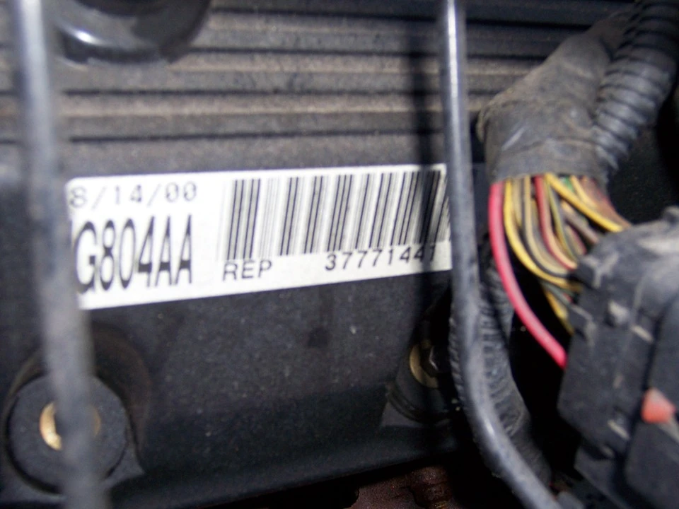

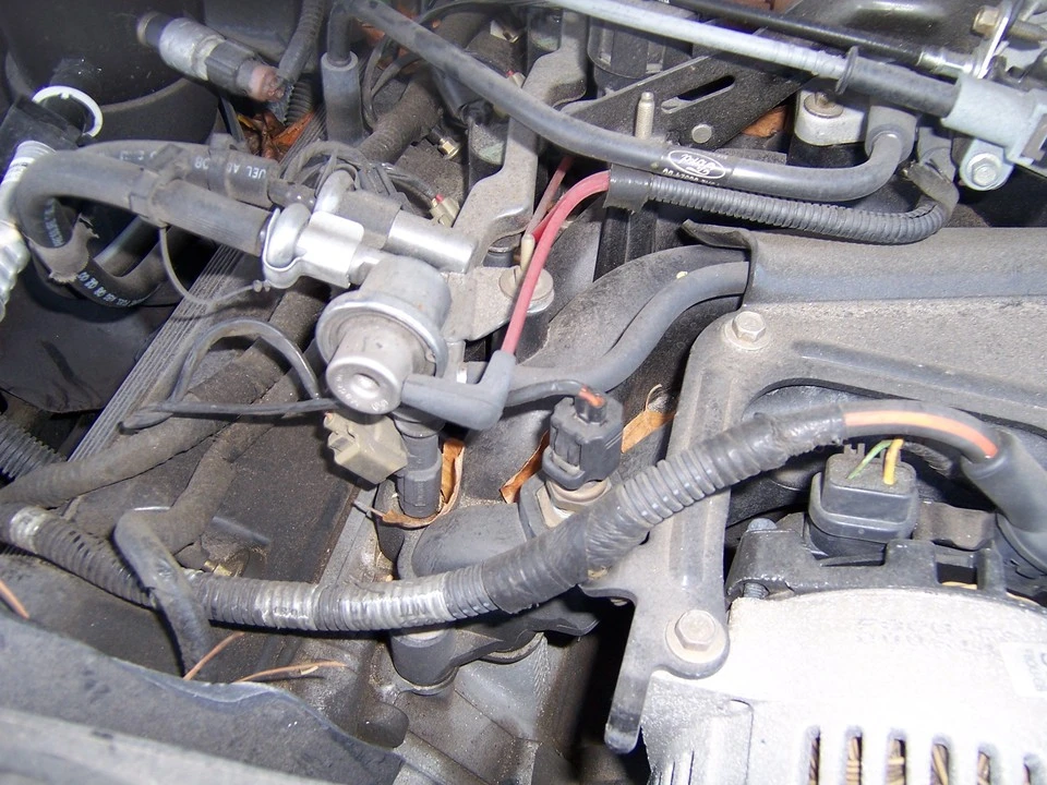

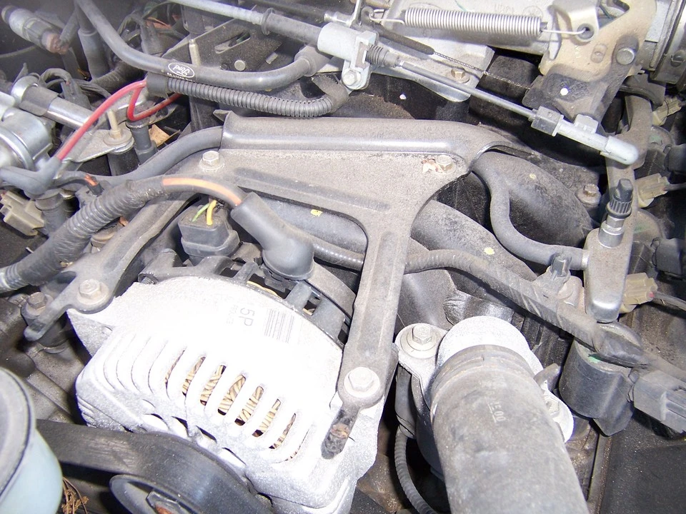

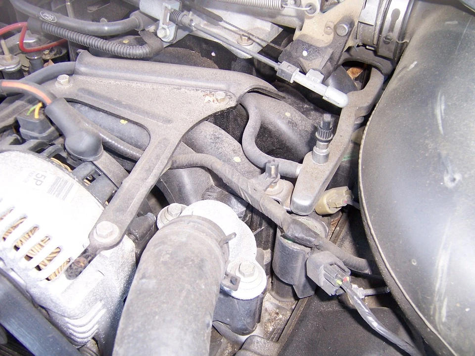

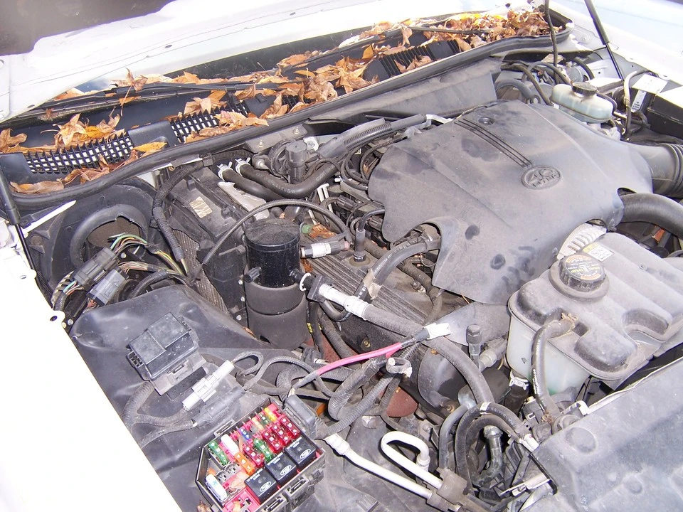

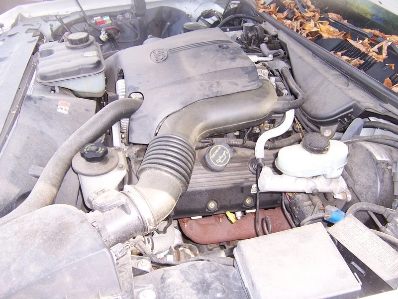

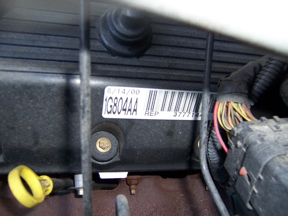

The Explorer motor looked to be in good shape, but they have no idea how many miles is on it. Could be 20,000, or could be 200,000. So I probably won't be paying $500+ extra for a motor that I don't know the mileage of.
Went to look at Option C today. Motor was in terrible shape. The car had been sitting in that spot for at least 5 years; front of the car was sitting on the oil pan; plants were growing through the motor; all of the wires/wiring harness were cut off. No thanks.
BUT, there was another car 2 cars down that has a very promising prospect. It was a 2001 Mercury Grand Marquis. 38,000 miles, still had air in all 4 tires, motor was completely untouched, and relatively clean looking. And the price is right, as well. Just need to be sure it is a PI motor. Here's a few pics.
Tag on driver side valve cover.
The vin is 2MEFM74W11X620377, which does check out to be an '01 Grand Marquis. And the 01 Grand Marquis are supposed to have the PI motors.
Can any confirm this?

Its a PI, looks like a good score.

That's what I was thinking. $600 for a 38k mile PI motor that looks like that sounds like a good deal to me.
