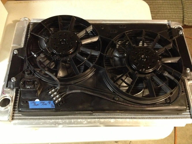

If you go electric, get the dual one. My single 275 black magic 2800cfm worked better on my stock 2 row, when I went to a 3 row (more fluid to cool at one time) it has to work harder to cool it the same. So 2 row radiator, single is fine, 3 row row and up, go to a dual type fan.

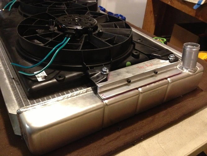

On mine, my friend Troy (RaceWires.com in Denver,PA) just had a bracket welded to teh radiator to mount the Ford Contour Fan set up. Troy can help you also if interested. I also think there was a guy in the Corral that was selling kits also. Here is the bracket before the welding was done:

1. If you have the e fan run it. Not only will it free up some hp, but it will cool the engine/radiator more efficiently than a mechanical fan.
2. If you increase the thickness of the radiator, then the amount of cfm needed to pull increases as well for the fan. Also, if you keep the mechanical fan be careful of where the fan blades end up as they may be too close to the radiator with a thicker fan.

I think the 369$ would be well spent on these upgrades. We all know how ineffective the stock Alt. is and the 130 is a worthwhile improvement. Also you already have the elec fans(which free up a few hp and cools more efficiently) and just need the few extras to run it. Sure you can run a mech fan with the alum radiator. I just would upgrade and be done with it

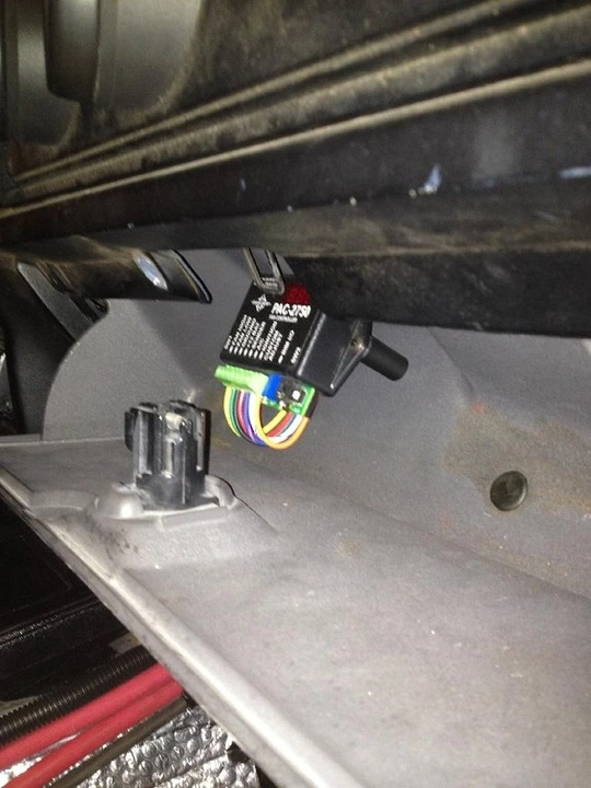

It absolutely applies to you, your first post did not mention what row radiator, only after my initial post. But from my 1st answer, you can assume anything above a single electeic fan with a 2 row is even more helpful in the cooling dept. For example your dual electric fan is > than a single electric with 2 row. But your main decision with that route is obviously how you want to temp control it. I have the temp slide in probe in the radiator with a turn dial on the fan in the engine bay. I've never had an issue with mine. But i do like the glove box idea that came out of the discussion above, that you didn't like:rolleyes: but the other big point like mike stated was if you go above the 2row with a stock fan, clearance will need to be checked :nice:
