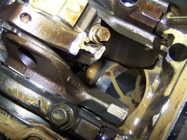

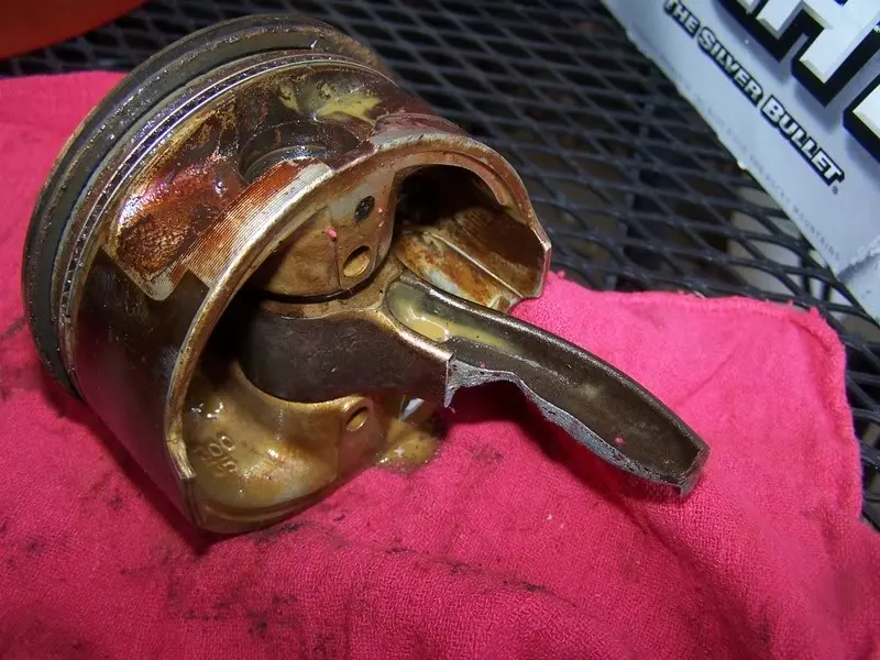

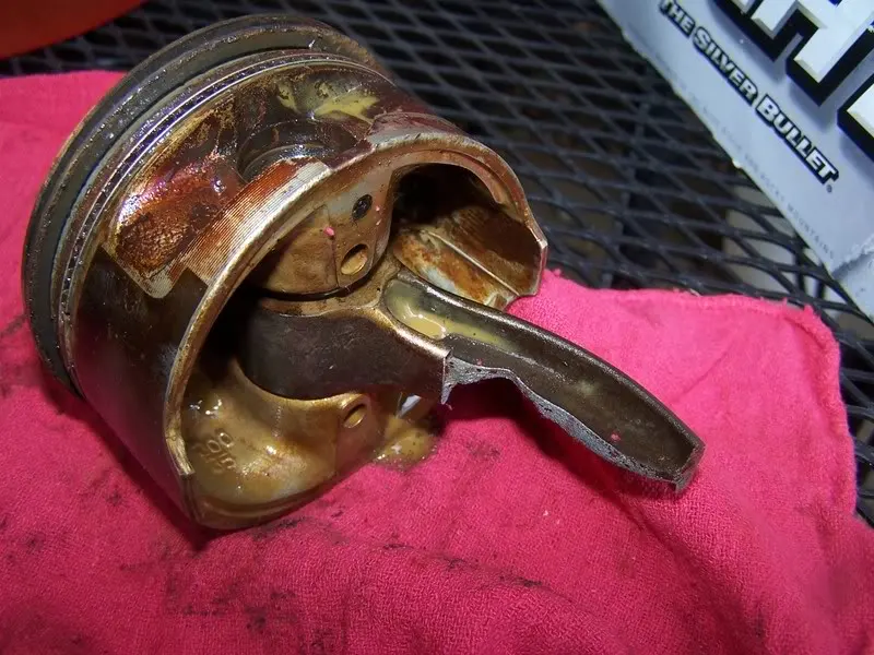

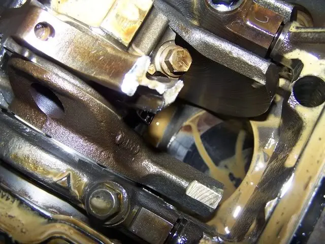

Hopefully you didn't hydro lock the engine
that was my hydro lock disaster
