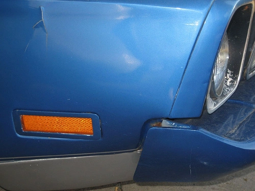

Platonic - it looks like you know a lot about the differences between the '72 and '73 bumpers - you may be able to help me.
I've got a '72 car but the guy I bought it from had a '73 bumper/grill put on and like you say it doesn't line up quite right.
I've been trying to figure out what all I'll need to replace to turn it back to a '72 since there are now aftermarket replacements.
Here are the pics: http://www.flickr.com/photos/wesratcliff/sets/72157594556614818/
What should I be shopping for?
Thanks,
Wes
Thanks,
Wes
Looks to me like either an inner bumper bracket alignment problem, or the full length steel channel that the bumper is mounted to is bent, and/or inner mounting bracket(s) are damaged. You have 73 fenders, grill and bumper. I can't tell, but I assume you have a 73 front valance. (73 valance has no signal light mounting). If the grille was not cut into to accomodate the shorter 71-72 hood latch, then you also have the longer lever 73 hood latch mechanism.
It would be rather costly to bring it back to a 72 as you would have to replace all visible front end parts (plus the bumper mounting brackets) except the hood. New fenders, Left and Right front fender molding, valance, grille, and worst of all locate a 72 urethane bumper (I haven't seen that available anywhere as a repro) and full length bumper support bracket (I don't know if that's available as a repro either) and a short lever 71-72 hood latch (also unavailable as repro). I suppose you could go for the repro chrome bumper, but you'd still need the bumper support and then you'd want to get the chrome fender and hood molding also. (It just doesn't look right to have a chrome bumper with painted molding IMHO).
If you decide to keep your current configuration and would like me to take a few pics of the proper inner bumper mounting bracket orientation, just let me know. As I currently have the bumper, valance and grille removed from the 73 Mach.

Wow I didn't realize they changed THAT much stuff between '72 and '73!!! :bang:
My grill WAS cut into for the short latch like you mentioned so I must still have a '72 front hood latch but evidently that's as far as the 72-ishness extends.
I'd love some pictures of your setup on the '73... I will just stick with that since there is so much to replace!
