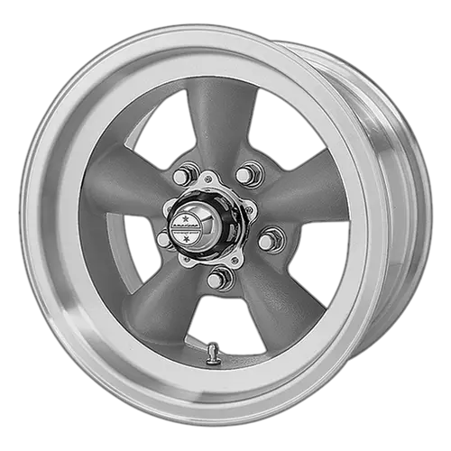

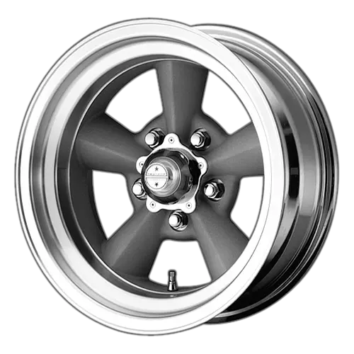

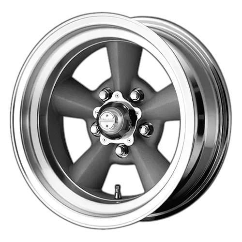

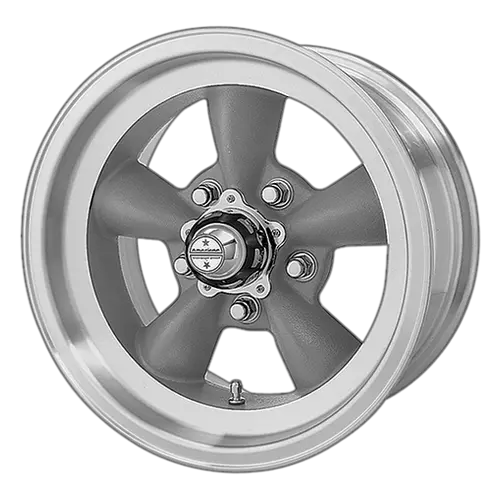

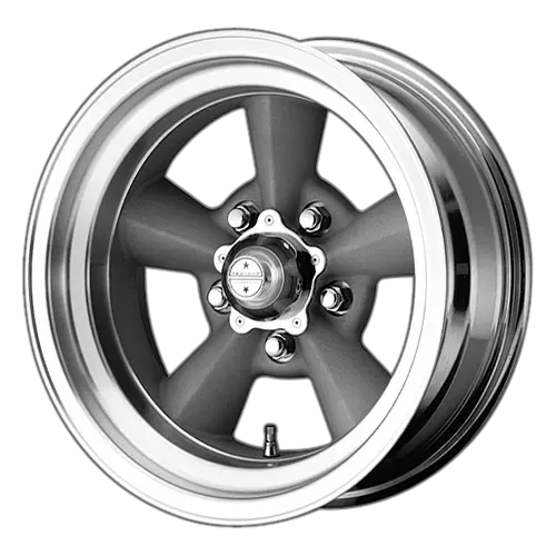

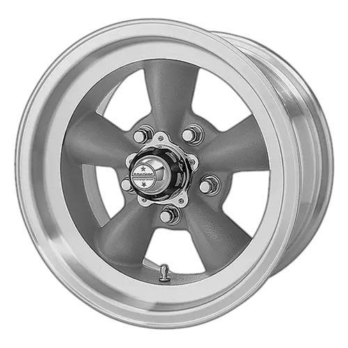

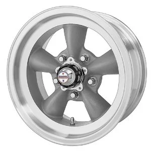

I can't tell you if the original rims were more rounded on the spokes (TTD) or more pointed(T):
Sizes - more choices in the TTD: 14" x 6" / 15" x 10" / 15" x 4.5" / 15" x 6" / 15" x 7" / 15" x 8" / 15" x 8.5" / 16" x 8"
Sizes: 15" x 5" / 15" x 7" / 15" x 8.5" / 17" x 8"

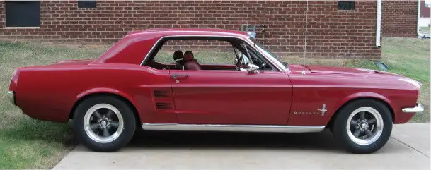

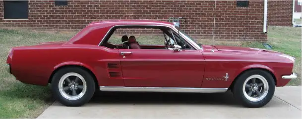

I went with the D's, but I'm not doing an exact replica and $ kept me from going with the 8 spoke style.
According to CobraAutomotive the TTD's are a replica of the GT350R wheel, see pg. 37:
http://www.cobraautomotive.com/cobra_cat.pdf
I used 15X7" 3.75" bs on all 4 so I could rotate as these will be my street DD tires. I had to roll the fender lips with 225/60/15 tires as the bulge of the tire scraped barely, if I could have found 4.25" bs that would have been perfect or I would have had to step down to 215 tire (didn't want to). Here they are on Summits site, sometimes their selection web tool steers you wrong, I usually look up the part # on the manuf. site (AR) then search websites by part# for price/availablity.

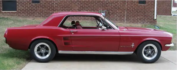

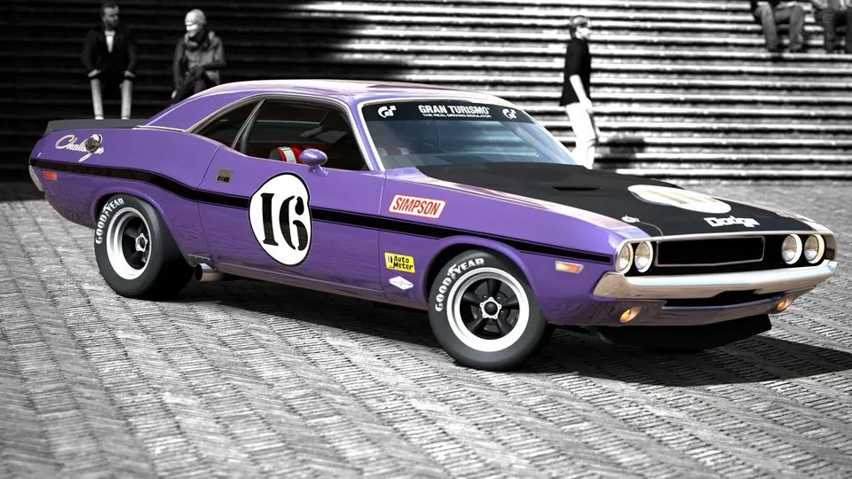

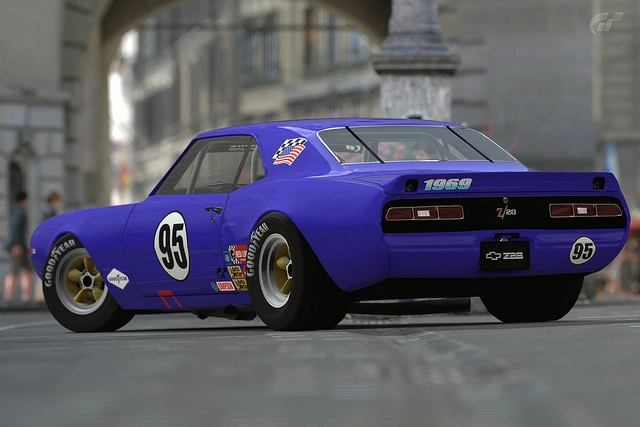

Another thing that got me on this path was Gran Tourisimo 5 for the PS3. There are a few vintage cars in there that you can purchase from the new car dealers that you can then do Race Modifications to which turns them into their T/A variants. The ones I know of are the 1969 Z28 and a Challenger R/T (there are a couple others but those two in particular wind up wearing the wheels I'm looking to replicate). I'll post pictures of these as I can find them on the .net...

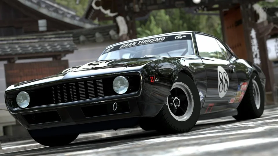

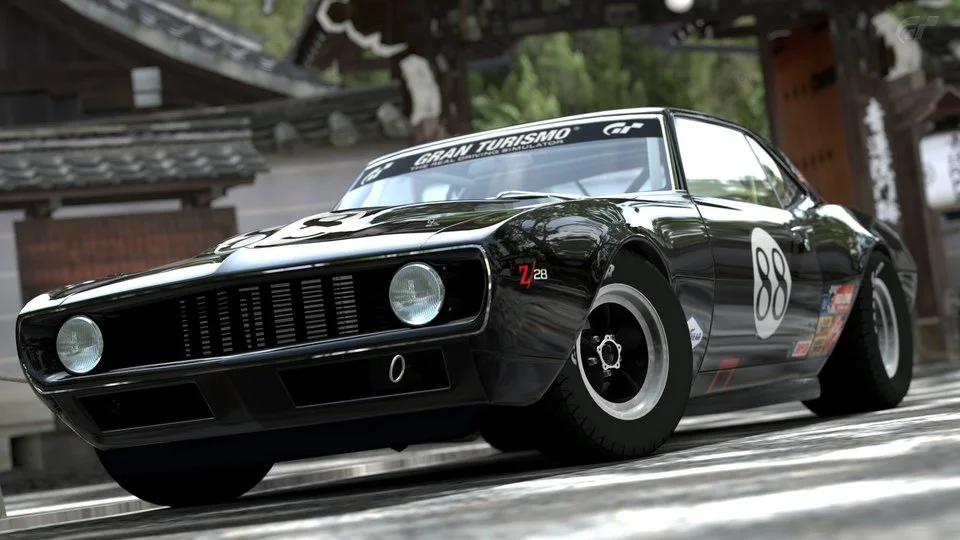

Camaro Z28 wearing either R-Model or one of the Torq series rims without the center caps...
This one of the Z28 has the rims being more "edged" spoke than rounded.... so maybe those are closer to the originals?

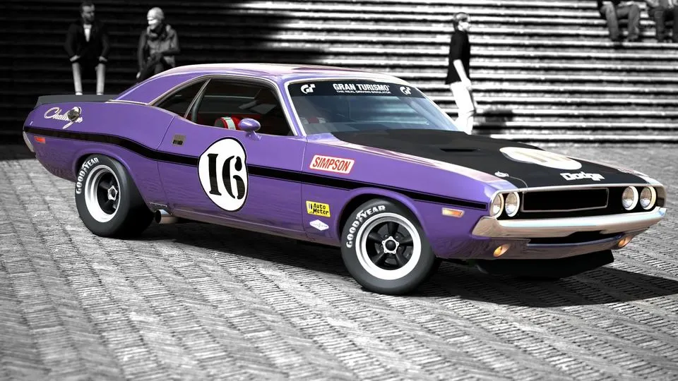

This one of the Challenger R/T RM shows the rims the best. They definitely have the 'edged' type spoke instead of the 'rounded' ones...
