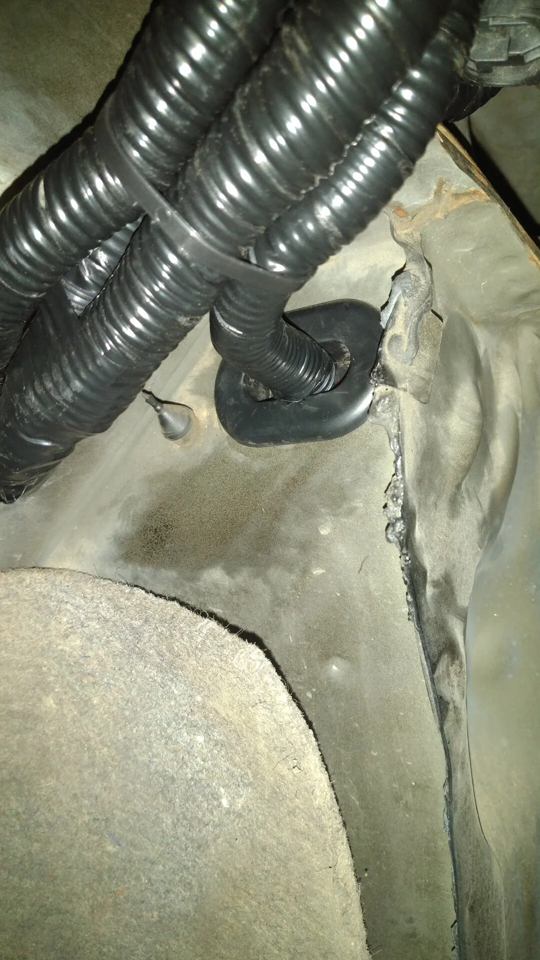

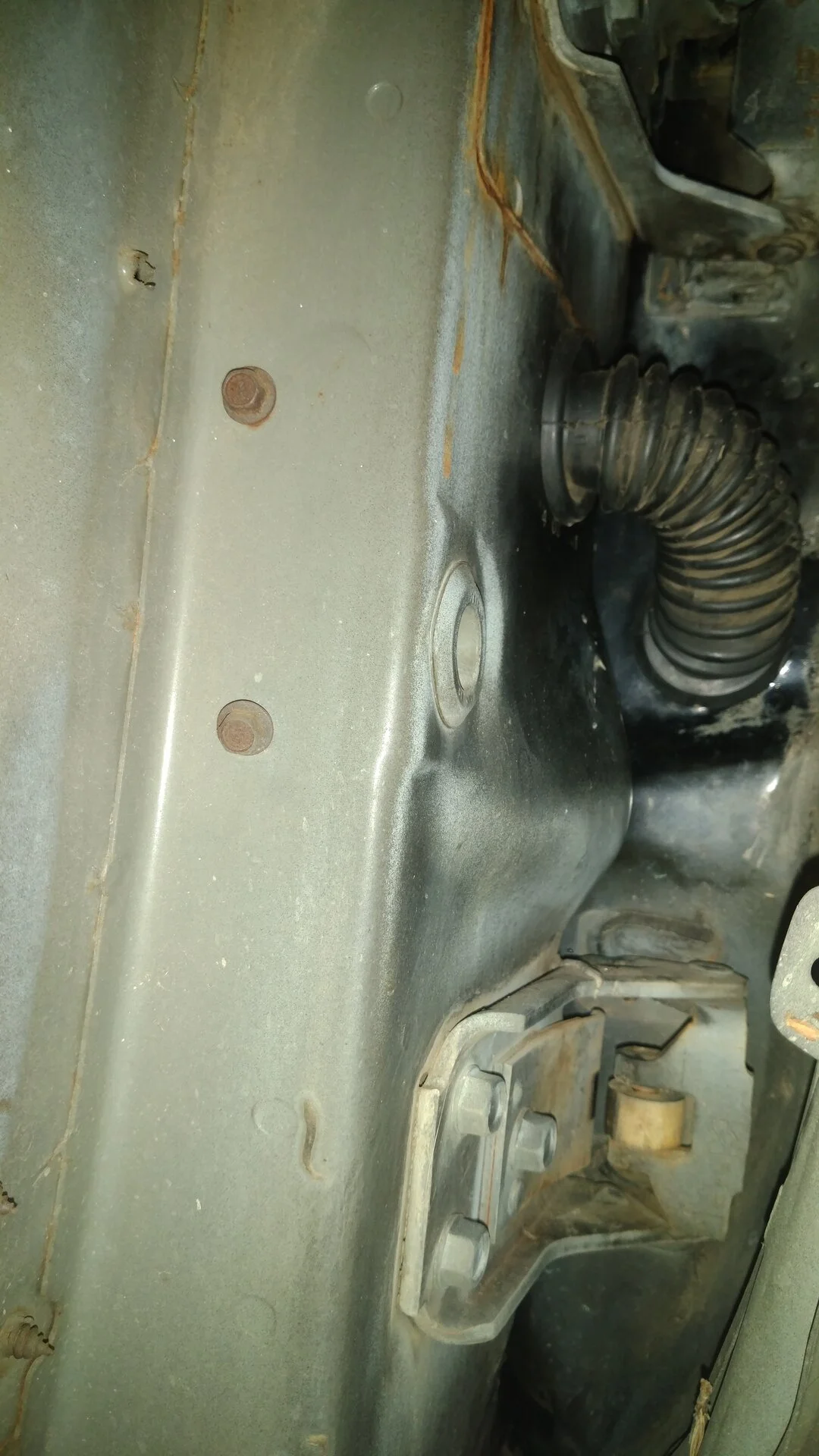

These are the best 2 places I have found - both on the driver's side. The first, as mentioned, is accessed from the kick panel area and exits near the door hinges. The other can be accessed from the firewall area and exits into the fenderwell. This is a good spot if you have a non-cruise control car.

Run a new hole like the general said and use a good holesaw. Get a hand full of grommets from the junkyard
