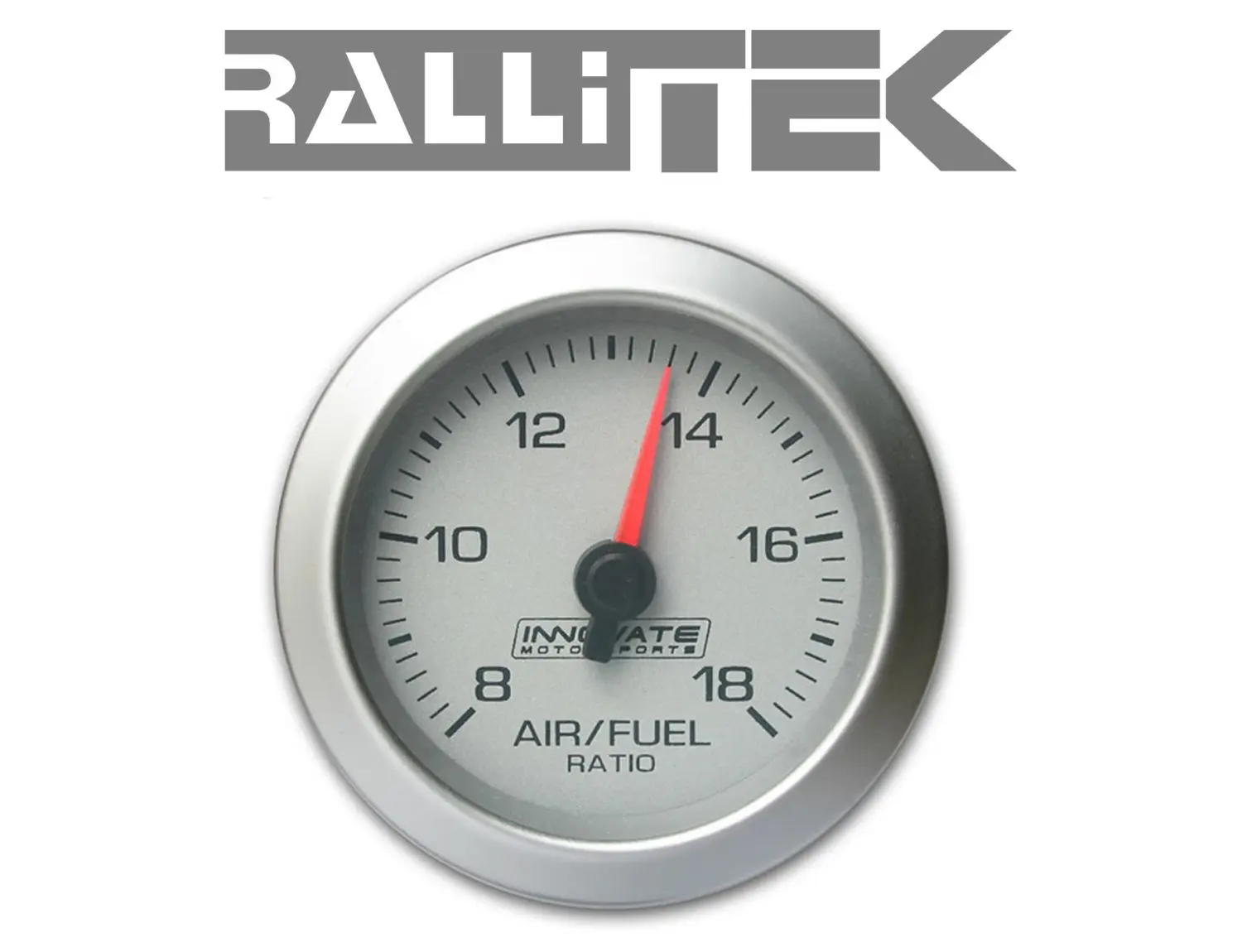

Second best IMO and still available although scarce is the Innovate:
Straight up analog 5v AFR wideband gauge.
So here's my question: What other straight analog 5v input gauges are out there that I'm missing? Most of the ones I see being sold today come as part of a kit that already includes the sensor and signal processor.
I just want a straight up analog AFR gauge that I can feed from a 5V source :shrug:

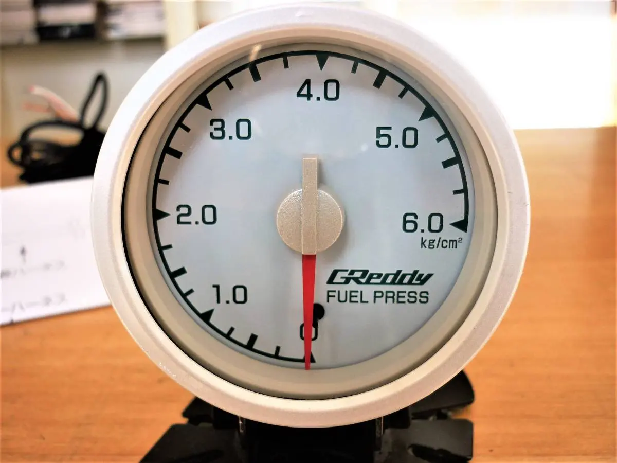

The one Greddy used to make looked just like this one:
Full sweep 0-5V, accurate as fck, and had two buttons and a dial. A hold/release button, a high/low replay button, and a dial for an analog marker.
I'm still poking around for an image of it.

It looks like Innovate still sells gauges individually as kit replacements:
This might not be a horrible option.

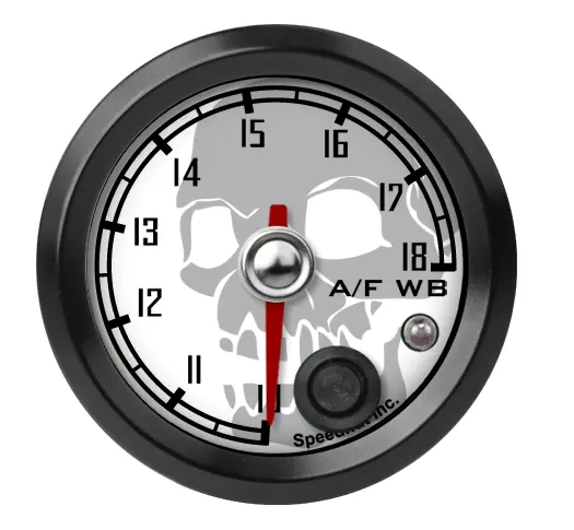

Check these out. I haven't purchased either so I can't speak to their quality, but I like the features. If anyone out there has any experience with these brands, I would love to hear feedback.
Customizable:
https://www.speedhut.com/gauges/Air-Fuel-Gauges/?catid=f1
Another option:
https://www.glowshiftdirect.com/air-fuel-ratio-gauges
I prefer reading AFR in lambda over AFR, since it gives you a direct correlation to the rich/lean percentage. This is really helpful if you are calibrating fuel maps or transient compensation. For this reason I'm partial to the Speed-hut version since it's one of the few analog gauges that displays in lambda. The only downside with Speed Hut's version is that you have to use a compatible wideband controller to match the analog voltage range.

This is pretty near the Greddy piece I mentioned originally:
