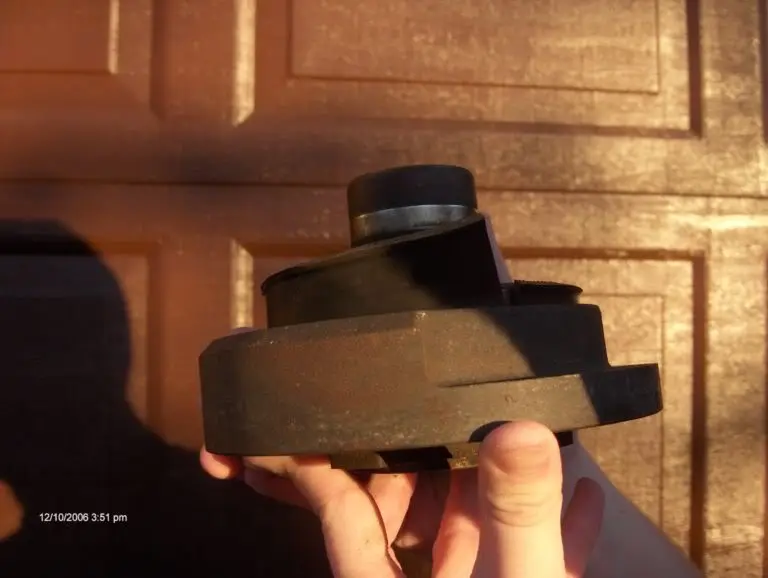

So I tried to pull more codes and do the cylinder balance test, but it wouldn't pull codes in KOER. ?? wierd...Anyway I start her up this morning and take a look under the hood and what do you know; the harmonic balancer is just dancing all over the place. I went and bought a new one and the weight part on the balancer was completely detached from the center bore thingy. W/e I removed the balancer, you could see where it had ate about a 3 inch long hole into the top of the block ...It's my fault I guess for not fixing it, but now everything works great, except for the big freaking hole. It's not leaking oil that I can see anyway. I wonder how long it's been there???
Thanks for everyone's input. Also, I got away with the install by just removing the overflow tank and the fan. The bolts also were not hard to get off either, no air tools required...

hhmm likely chewed-up part of the timing cover. Keep an eye on it, if it ever leaks you can get a new one, but they're not exactly cheap or easy to find. Glad to hear it was an easy fix though...

i knew it was one of thoes damn buggers again....
