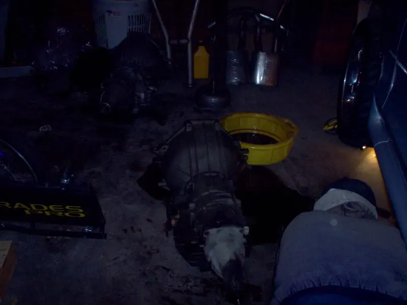

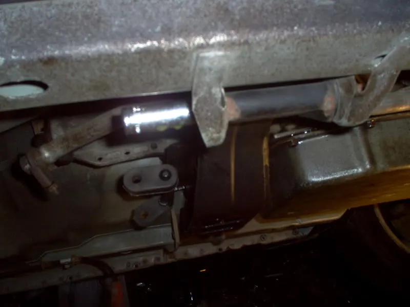

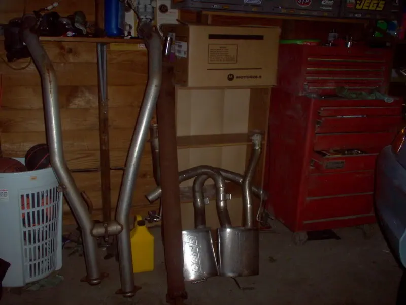

Uh oh! You are lucky not to have longtubes to work around.
Is Don doing the tune for you on the tranny?
Wes
What converter and what mods on the tranny?
I will get the specs up for you in a minute...it is a aode so I don't think it will need a tune but I will get with Don soon as it's in........I was actually under the car thinking about now may be a good time for LT's..... but I will give up the extra low end not to fight with it....lol

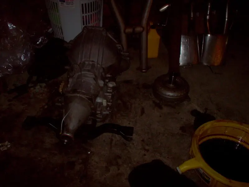

Description: Race prepped AODE
Complete overhaul on AODE, 0 miles on it. Only the best parts installed, made to handle 700 hp. The tranny’s valvebody has shift modifications, upgraded output shaft & Stubby input shaft, and a finned TCI deep oil pan. - $1550
New overhaul parts that went in include:
Overhaul
GASKET AODE/4R70W 92-95
FILTER 4R70W 2WD/4WD 96
AODE/4R TAIL BUSHING
C6 PUMP BUSHING
Inter Clutch
RAYBESTOSE HIGH ENERGY GROOVED (4)
4 PLATE PP
FWD Drum
BLUE FORW (6 Raybestose Blue Racing clutches, better slipping protection than ALTO reds)
FWD STEELS 34T (7)
Reversed Input Drum
SPIRAL SNAPRING
DRUM, AODE / 4R70W Mechanical Diode Update
Direct Drum
BLUE DIR (6)
DIR STAMPED STEEL 34T .07" (7)
SERVO & ACCUMS
2.7" Piston, Overdrive Servo, AODE / 4R70W, Molded rubber
Accumulator Piston, AODE / 4R70W. 2/3, 1994-UP
MISC
DOUBLE SEALED OD SERVO PIN
LUBE TUBE (lubrication modification to lube the tailshaft/yoke and help the bushings live longer)
SUN GEAR BUSHING
I have my old MAC longtubes, a matching prochamber and produmps I need to sell if you are interested. :)
I just put on some identical Jet Hot coated longtubes I got from Chris. Boy what a PITA. These had larger tubes than my old ones and calling it a tight fit doesn't do it justice!
Good luck on the swap. I've got a tranny jack you can borrow if you want to come come pick it up haha.

Nice specs, that will handle a little abuse. :-D Any plans for a converter? (or did you already have one)

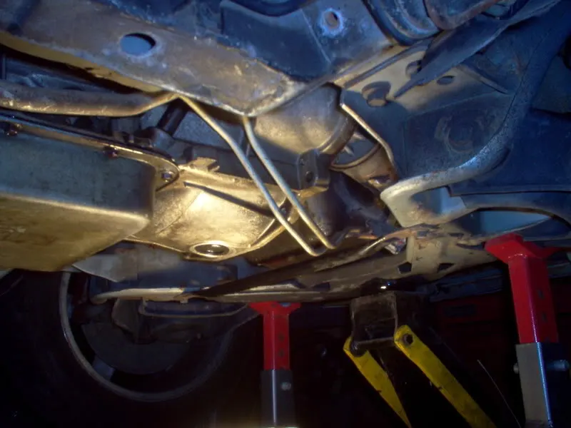

Wes....thanks for the offers....but I'll stay short's for now.....and I borrowed my friends tranny jack........problem is I had to take the tranny off the jack to get them out from under the car........jack is up as high as possible....may have to jack on the side getting the new one under.....lol
I have a 9 1/2 inch 3400 stall from Edge I just put in last year...less than 2500 miles.....

But good news.....I have the trans in......only few things left are the whole exhaust...driveshaft....and a few electrical connections on the trans and put some fluid in it........decided to knock off and spend some time with the family.......
I would suggest if your going to do a auto trans........ask for a extra set of hands to help line it up...........what a PITA............
