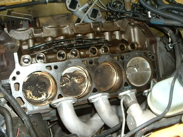

thanks, i'm going to be calling fordstroker.com in a week or so after i decide if I am going to order there bare block and put my 331stuff in it or getting there 347 short block. I see that fordstokers deals with jay allen. I also need to stop being lazy and take my block out and make sure my pistons and rods,crank, are not hurt.
