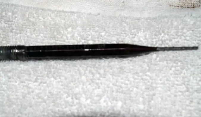

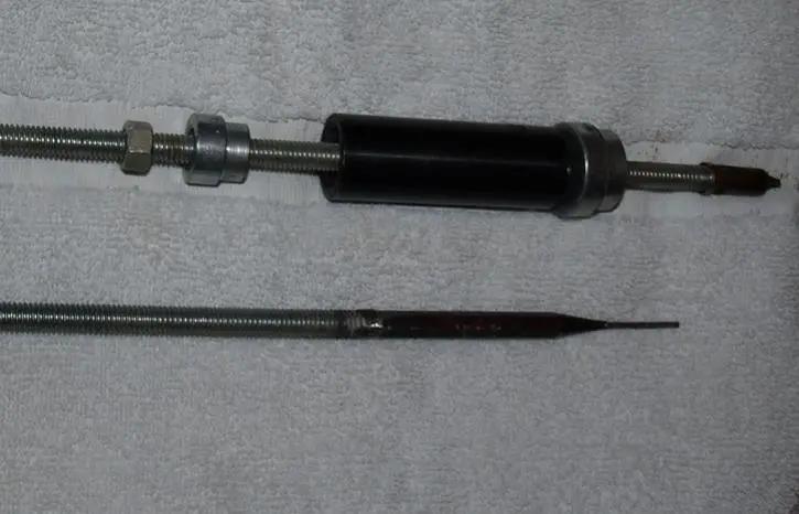

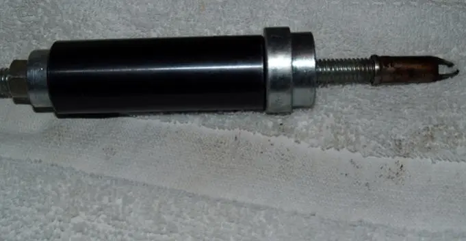

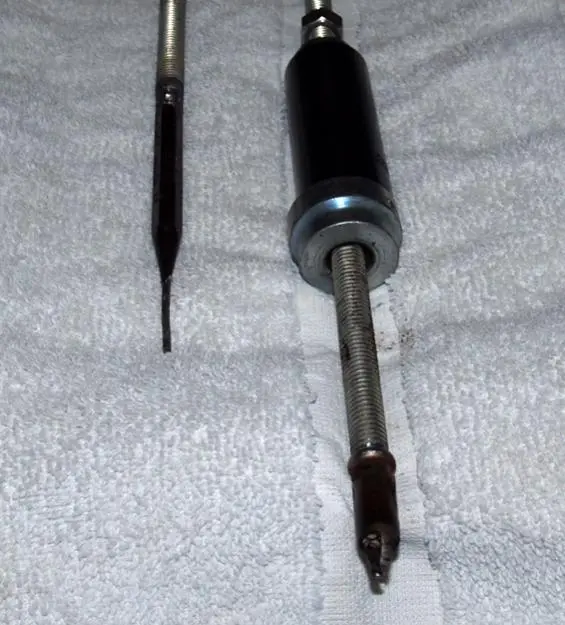

Both had insulators stuck..in the shield… so that was the first step.. I had ordered the lisle tool and it was to be on hand in the morning. But in the mean time,,, I wanted to see what I could do.. a 3/32 punch is a press fit in the center of the insulator after the tp half and wire comes out.. So welded a piece of 3/8 all thread to that. USed two bushings from a bearng driver set, one above the spacer (spacer is an impact socket) the spacer and one for the head.. Drove the punch/ all thread in to the insulator set up the puller.. and removed the insulator.. Worked on both plugs,, but mush better on the first.. as the abrasive insulator shaved down the punch shaft.. Had to peen it a bit to get it to stick in the second plug.
Next up was to tap some threads in the shield, 3/8-16.. long tap extension is needed to get down there.. Put about 3 threads in the shield, threaded another all thread puller into the shield, bushings, spacer, bushing,, 3/8 nut… few turns f the nut and out popped the shield.

Do you have any pictures of your homemade tools
First two.

The Lisle LIS 65600 Truly it's a better solution, faster, and fairly cheap at under $100 if you plan ahead. It was nice to get this done last night; it was great to do it with tools and materials on hand. And it still would have been both the $ to have and use the Lisle tool IMHO.. If you’re otherwise stuck this is an option. If I were to make another tool for dealing with the insulator. It would a spark plug shell as a base, and the tool would push a driver into the broken insulator pushing it down into the shield just like the Lisle tool. After doing this, it’s clear to me you only need 2 or 3 threads in the shield to get enough pull for extraction. If the entire insulator comes out, none of this is a big deal.. Just tap a few threads and remove the shield.:flag:
