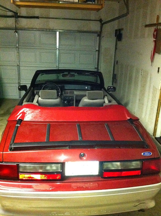

Here's a pic of the back. As you can see, the rear bumper and ground effects need repainting, but we're going to wait until the tail pipe issue is worked out.

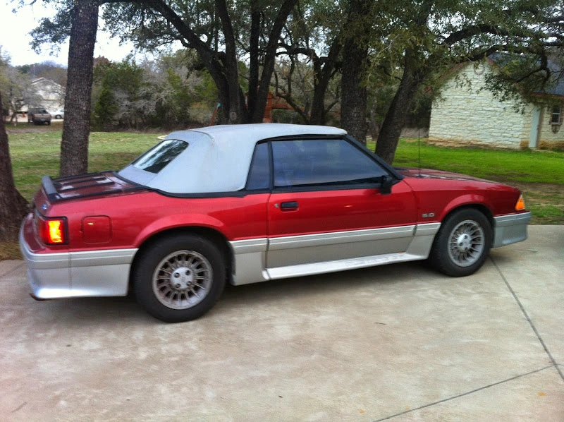

And here's an old pic of the car when we 1st brought it home, before a detail and the new top was installed:
