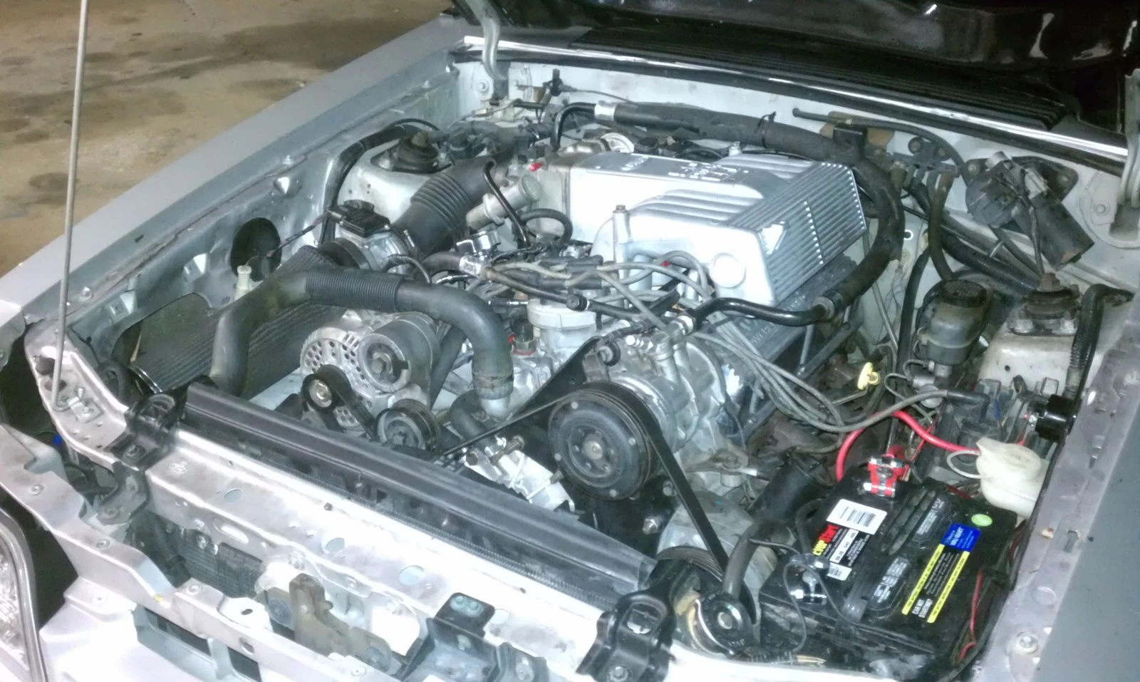

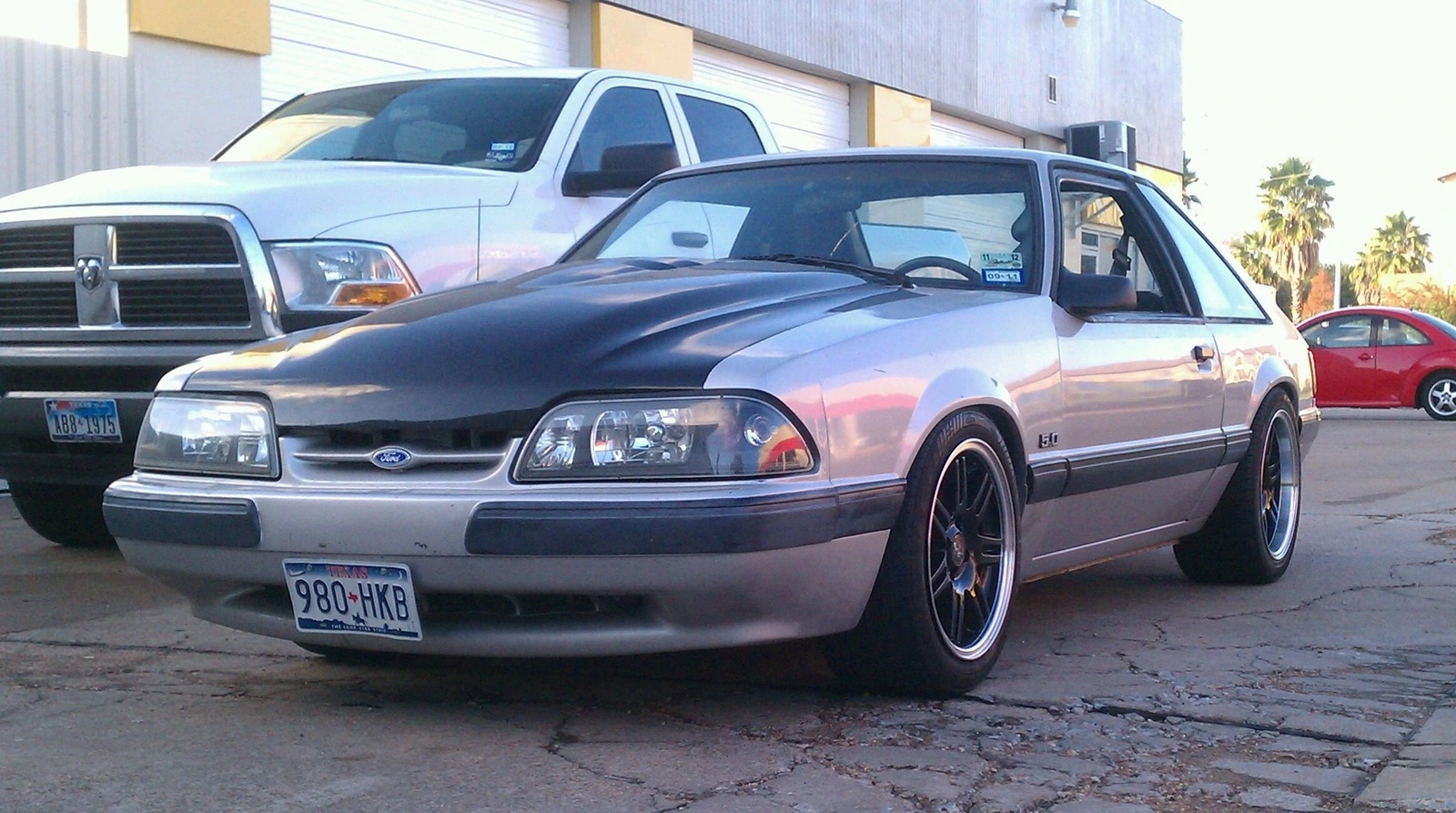

Im glad i can get comment and me send comments to ppl about there stangs and dont have a chevy or dodge haters lol....This is my 1991 hatchback with aluminum heads long tubes bbk, gt40 intake, e303 cam, just got the wheels and im loving it.,.....
Welcome! I see the last owner was going for an SN95 look. hehe
Wheel stance looks awesome though. Time to DE-streamline and paint, huh? That hood with the right paint/grafx could look sweet as hell. :nice:

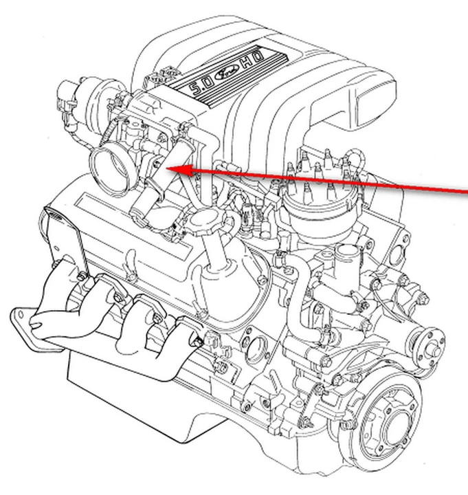

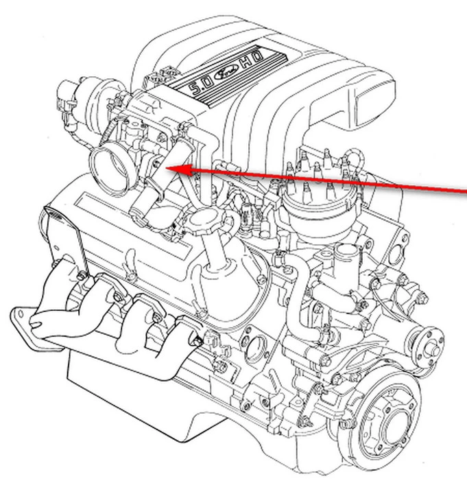

Thanks I was just curious and also I just put my heads and since I installed my cam my car surges when I start it and I think its my o2 sensors my bros coupe did the same its so annoying...lol
Idle Air Control
It comes off the throttle body. It controls the amount of air allowed to bypass the throttle blade when the throttle body is closed.
