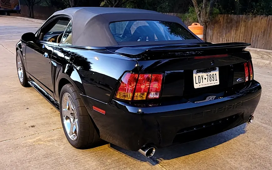

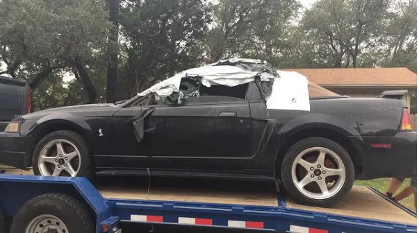

First, thanks for all of your help on this project. With it, I have been able to go from this (when it arrived from the auction):
To this (though it was waiting on the tow truck after its most recent issue):
This is a car I bought from Copart a few years ago and have been restoring. It's got new interior, a new top, new paint, a new transmission, and new front and rear suspension to name a few items. The last thing to tackle is the engine (which is still in as "good" of shape as the before picture), and the plan is to finally install the On3 Performance turbo kit that has been sitting on my shelf for awhile.
