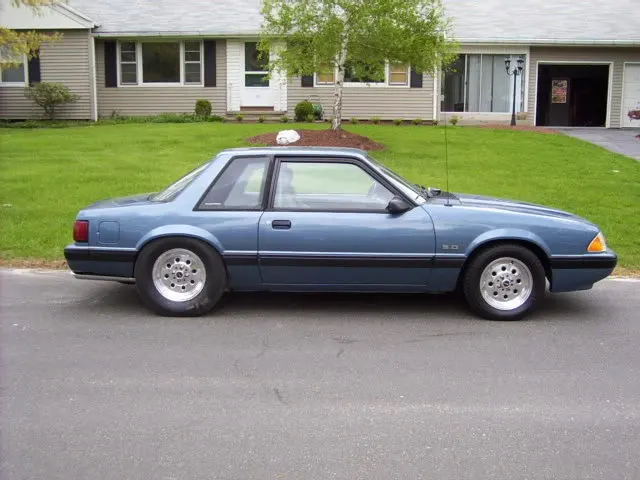

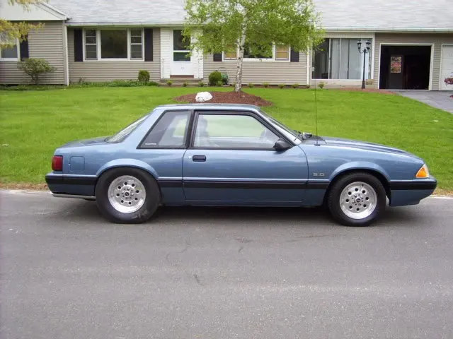

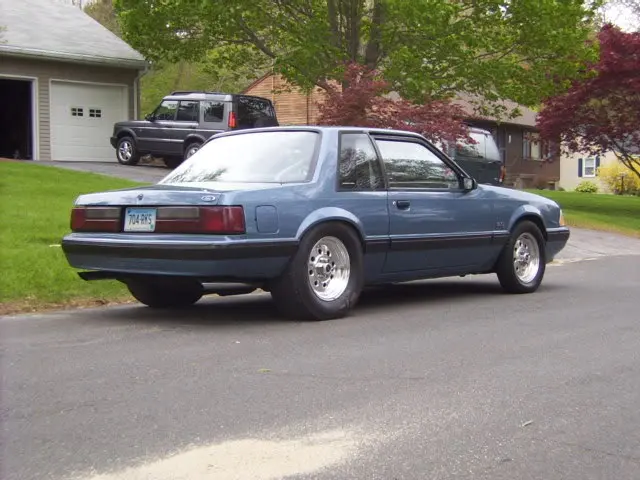

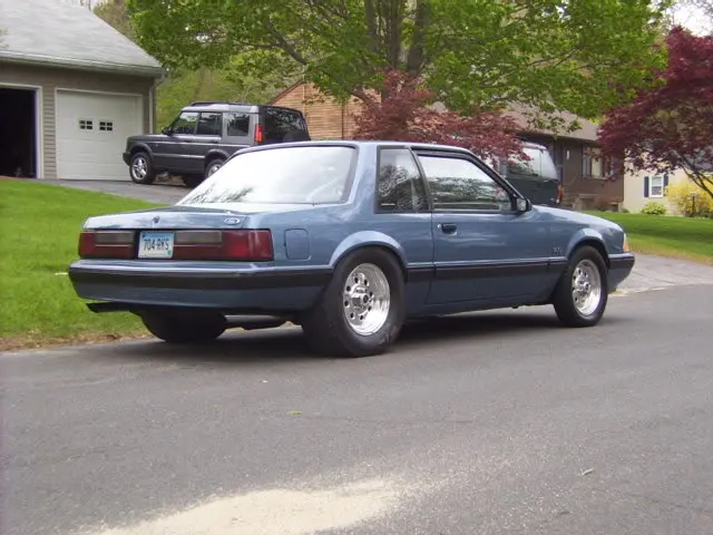

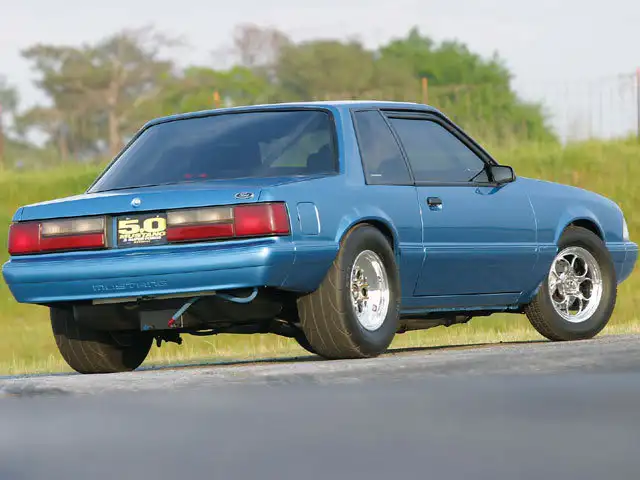

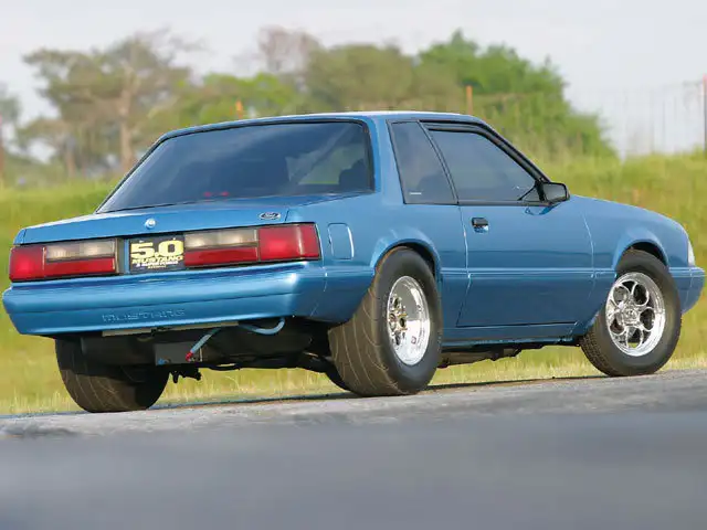

To be on the safe side I would say a 8" rim with 5.5bs and 275/60, or 9" 6.5bs! I have 8" 5.5bs, and just ordered the 275/60 MT drag radial, good luck.
Not my cars but heres the 8" rim with 5.5"bs and 275/60/16
Not sure of backspace on this one!

So a 275/60 is widest tire I can get on there?and if i want a 9" rim i need 6.5"backspacing and If i have an 8" rim i need a 5.5"backspacing?
more pics?
thanks 306notchback
No problem, Im sure about the 8" 5.5 bs it will work, the 9" I believe will work with 5.5bs or 6.5bs. Go to Corral.net then to the wheel and tire forums and do a search there are plenty of posts to help u out! No matter what u will have to beat the inner fender with a hammer, and roll the lip! There are people that run bigger wider wheels and tire combos but stick out past the fender well, but this is my input to be on the safe side and still good!:nice:

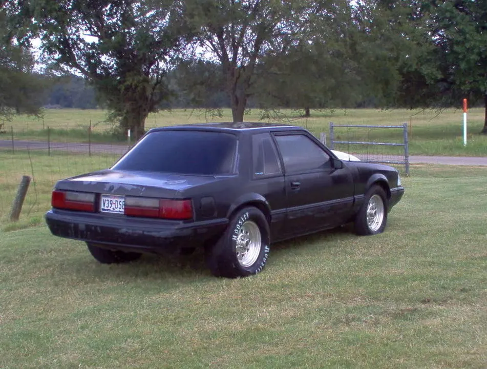

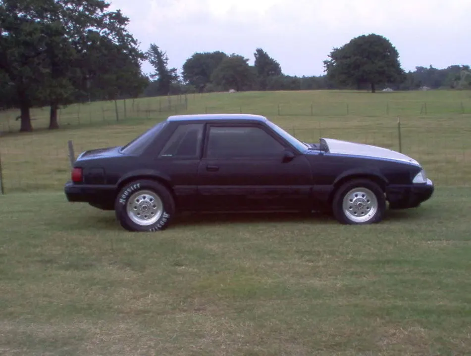

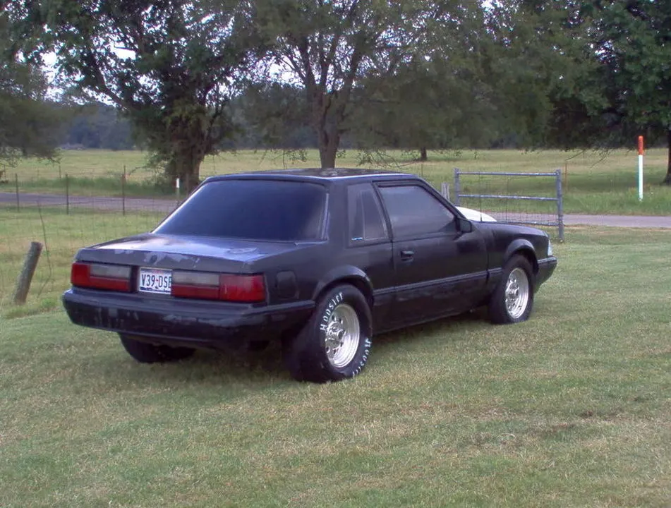

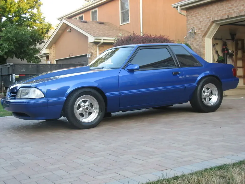

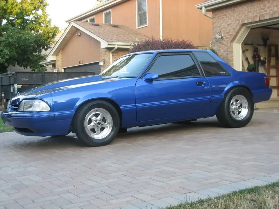

This guy has the 8" with 276/60! His car is slammed in the back which gives it the tubbed look, thats the look im going for! He has megabite jr. control arms and one coil cut in the rear , he sais it doesn rub!
Hers another

You think I can fit a some 315/60/15? think that comes out to 11.** inches If you think so what size Rim/BS?or some 26/10.5?
I would hate to have to this tub...
I just heard you could make a 28x11.5 Tire 15x8 wheel 5.5 BS and still has his tail pipes haha don't even look tubed??? Word is all over the place.

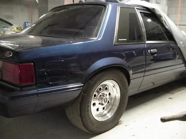

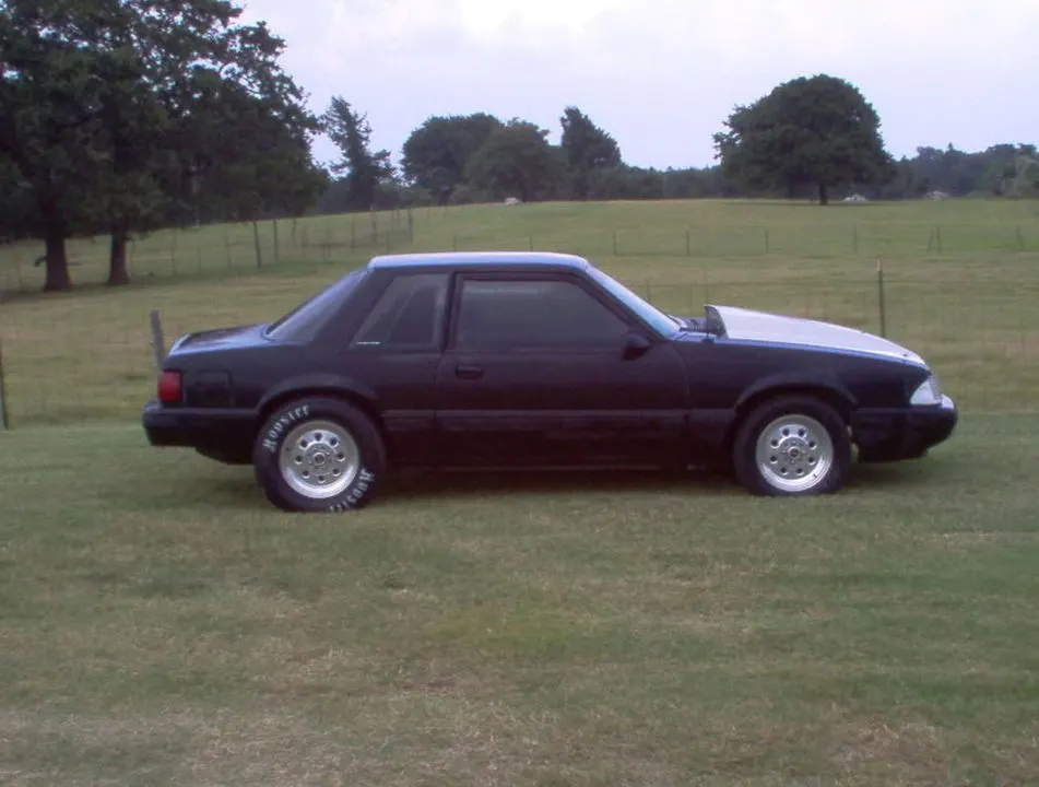

Thats what I had on my car, I had 1/4" spacers and they still rubbed with big bumps, thats why im goin with the 275/60, their a little narrower!

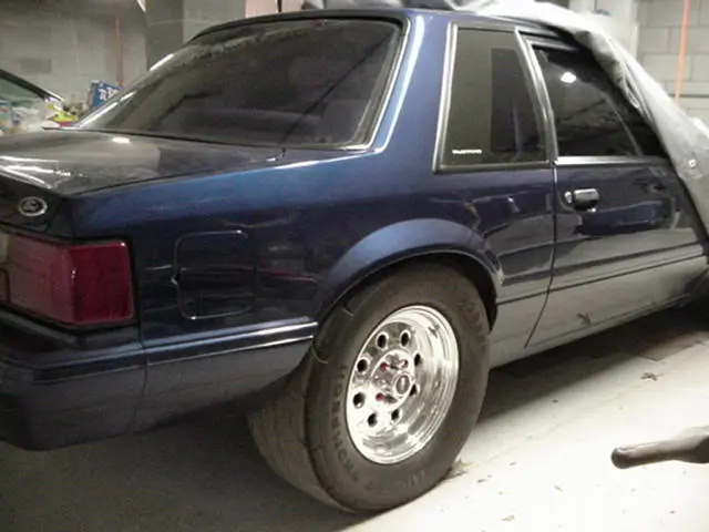

Heres some pics of mine with the 28x11.5 slicks:

They rubbed the inside or outside?What if this is a track only car will it rub on take off?

They rubbed on both the outside and inside only on big bumps or hard launches! Im running stock suspension right now with a better suspension setup they probalbly wouldnt rub as bad. If its a track only car they should work fine. Yeah Ill post pics when I get the tires on, car is torn down right now though because im doing the body work and hoping to paint by spring!
