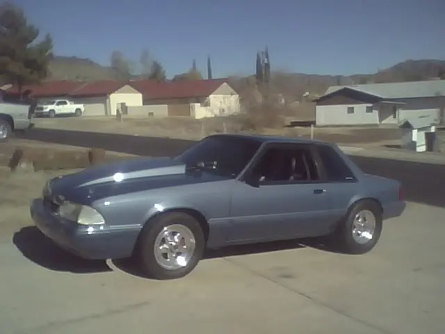

body to get to fit and still rub on big bumps i havnt had any luck with drag radials here is a picture of my 88 coupe

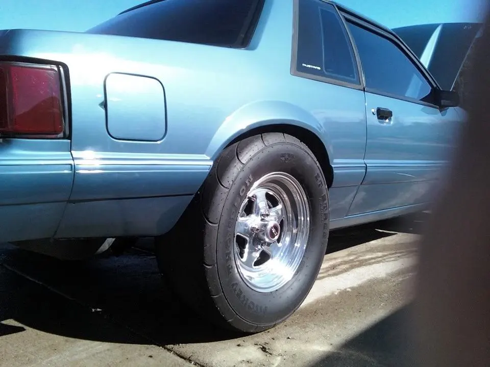

Just got them mounted heres the pics in this thread: If u want a wider look go with the 9" rim!

pictures didn't take... its on Wolfe customer cars very bottom section of pictures only two fox bodys (red)&(Silver)with all the cameros/firebirds
