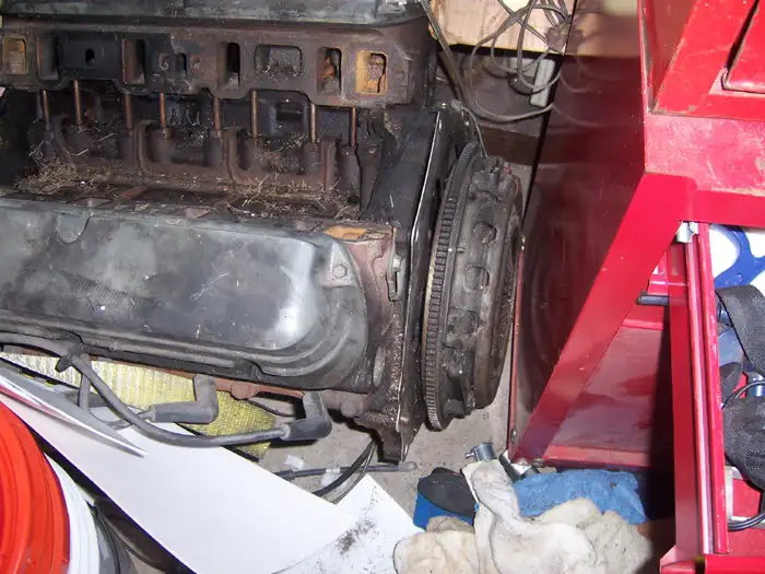

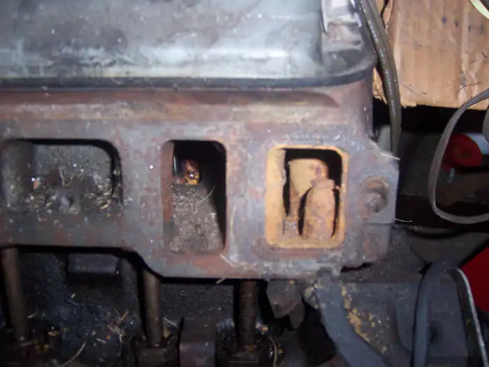

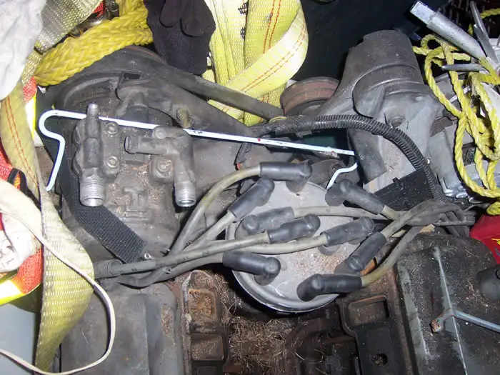

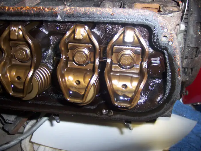

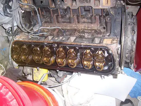

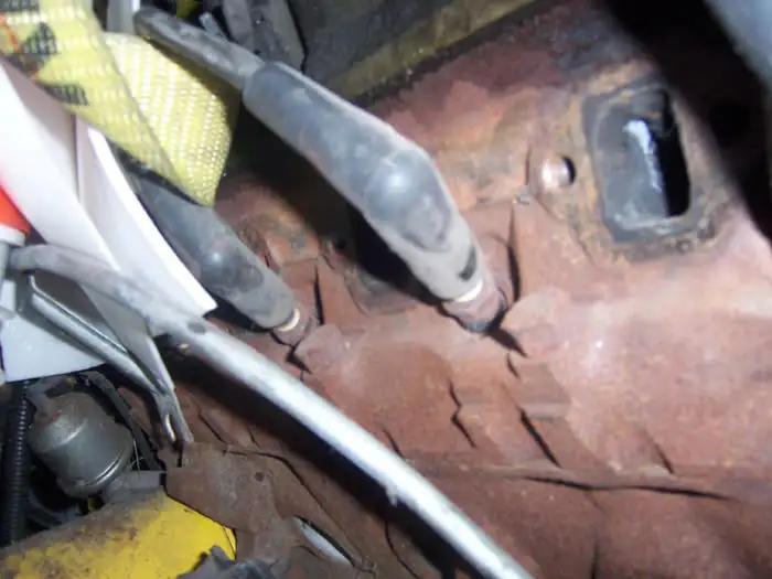

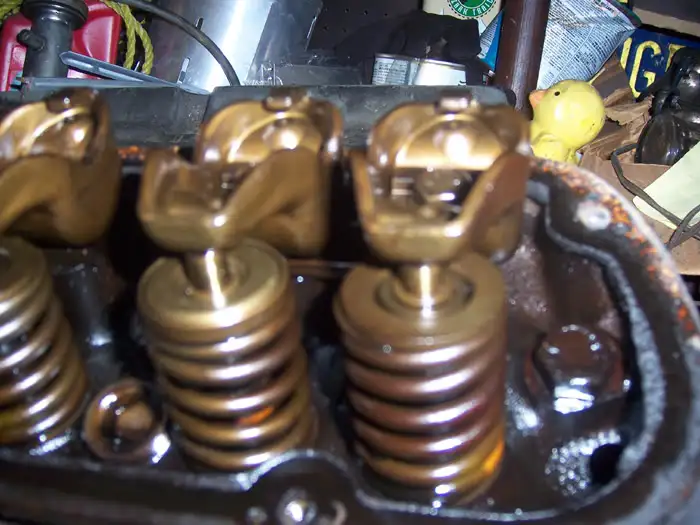

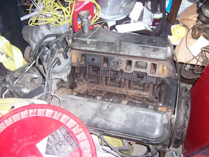

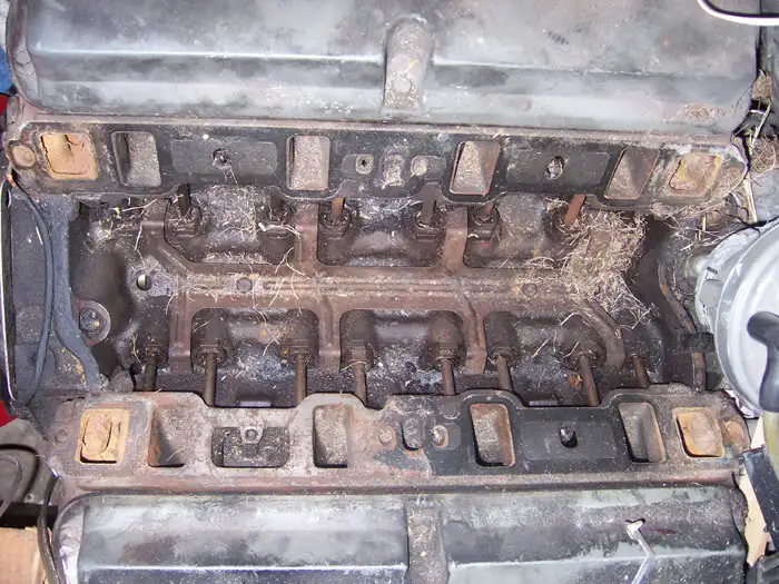

here is some pics of the engine i went to look at. Im kinda of scared to see what the cylinders look like. You guys think its worth it? its 100 bucks i might be able to talk him down to 75. Dosent look like its worth 20 though. You guys think i could clean it up? it has everything on it besides the intakes. He says its been sitting there for 4 years, and it was running when they took it out of the engine. He said the guy that did it said it was getting old and needed a rebuild, but he just droped a 351 in it. You guys think its worth the clean up? I have no problem doing it.
keeep in mind all of the parts going on it would be brand new, you guys think its worth taking off the heads to see if the cylinders are scratched or rusetd?

Are there weeds growing in the block? (Sorry)
You will deffinently need to get that thing to a machine shop for cleaning up. If you are having the shop do the assembly of your bottom end make sure that it is balanced if you do plan on rev'ing the motor over 6,500.
Did you buy it yet? It's a good idea to have 2 blocks laying around. One in the car and one on the stand ready to go in.
